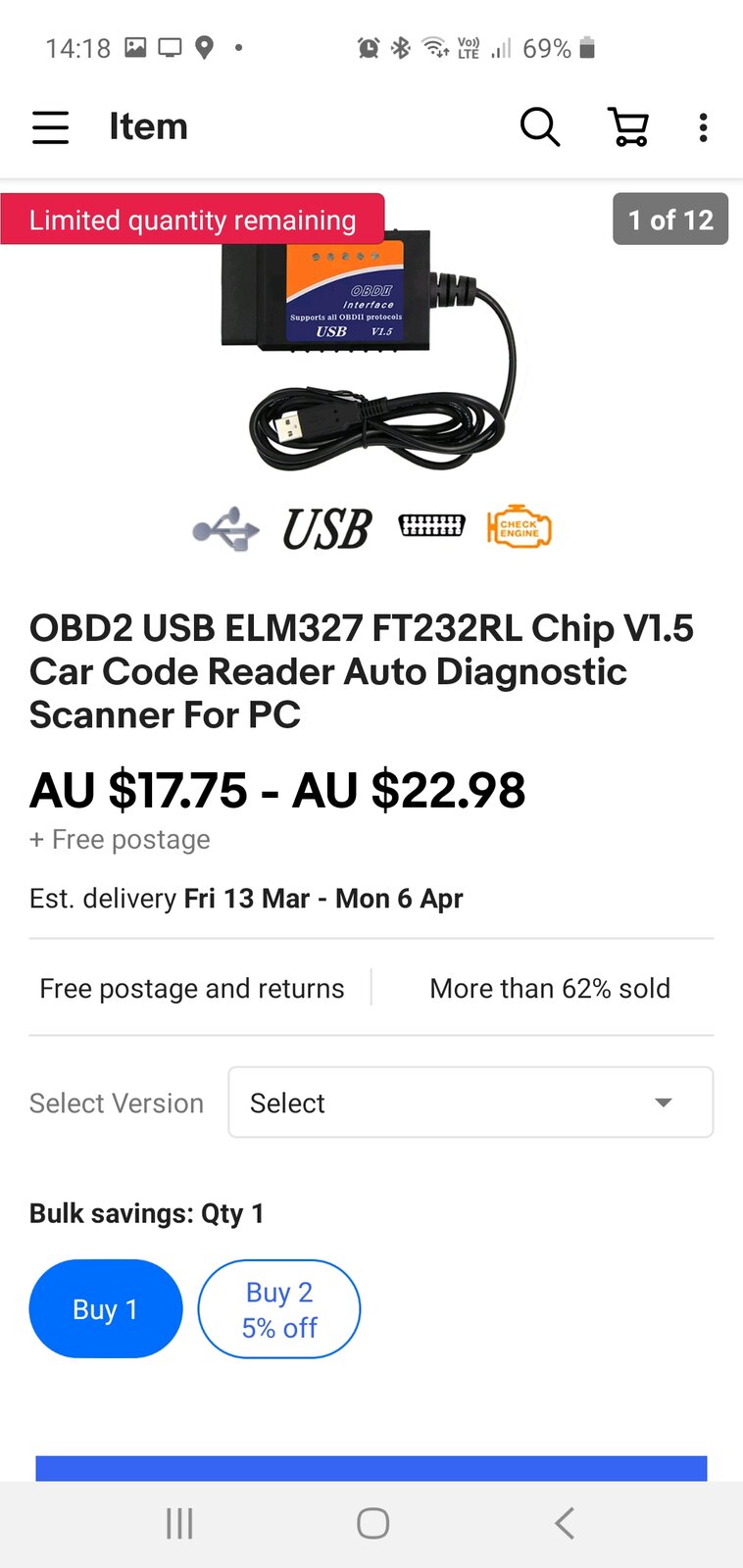

  10. Make sure the ELM327 USB Cable OBD2 is genuine and has been confirmed to work. Many on Ebay are Chinese bootleg where their cables contains a counterfeit "Prolific" chip that uses the same Vendor ID. Consequently, Prolific modified their newest drivers in Windows to render the counterfeit adapters unusable. As a result, any Windows OS drivers newer than the ones in XP will result in a "Code 10 error".
  11. ok will the software and those leads work with my 65 plate bosch unit (I'll try and cancel the ebay ones and order the above)
    edit: bugger can't cancel the ebay ones, I'll try them and if they are no good send back and order the other ones.
  12. Welcome to the club. That's how I found out about the bootleg ELM's.
