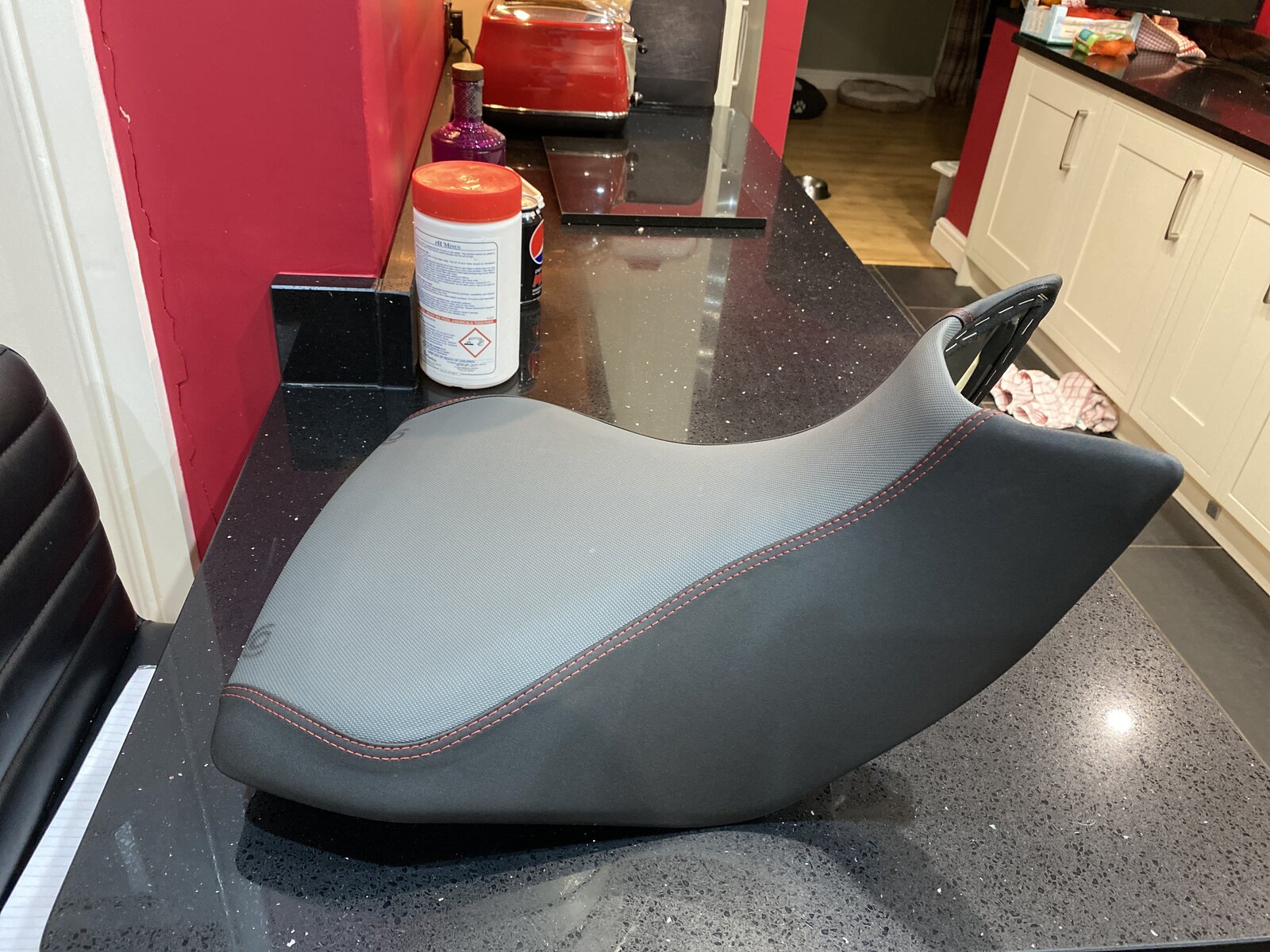

  11. I’ve got a Ducati touring seat for sale off my 1260. I’m too short for it

  13. It’s the comfort one -can send u a pic

  18. The DP/Touratech Comfort seat has the same seat-pan as the std seat. Risers fit and work fine, have them fitted to mine.
    Not sure what version Ant's seat is, and not wanting to piss on his chips, but it has the std 1260 cover by the look of things. Maybe he had that transposed across? The DP Comfort seat cover is black and is a more grippy material.
