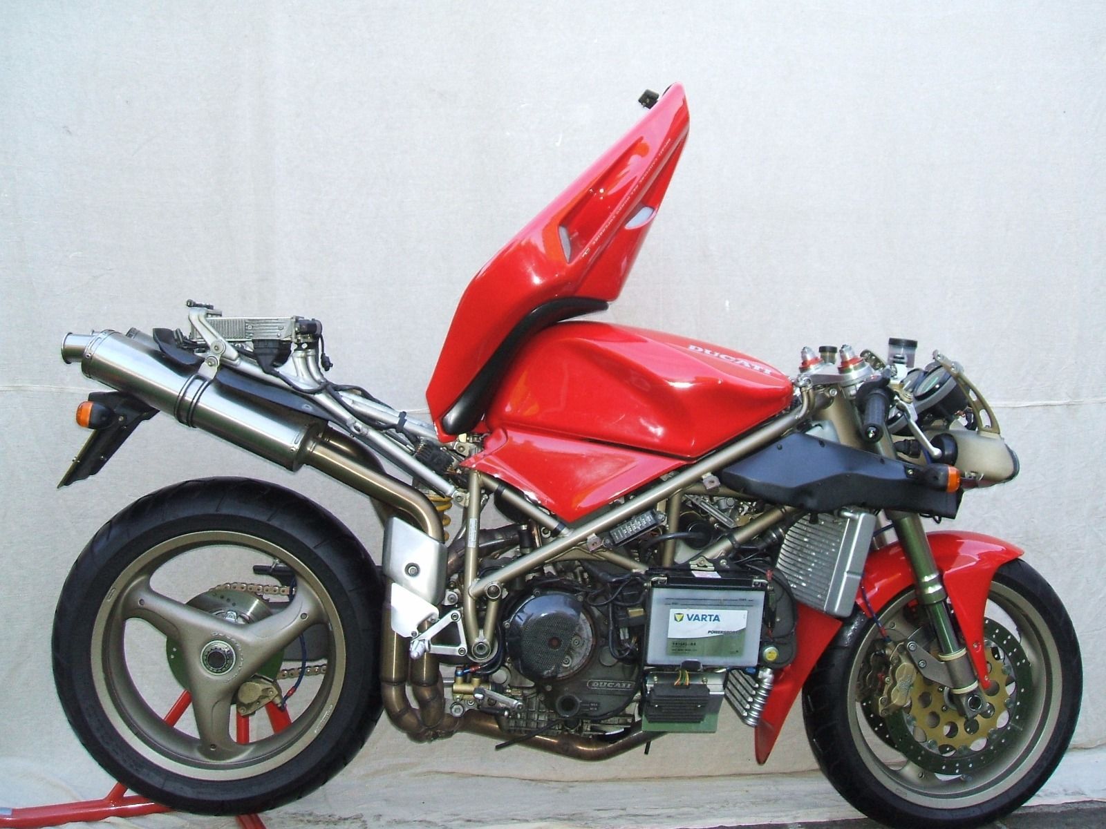

    Should they look like this ?
  5. Yes, that's a P8 ECU which, AFAIK was only used on the original Strada and then subsequent SP and SPS models. The biposto used the 1.6M and whilst it's easy to convert biposto to monoposto etc. 'converting' the ECU would be much more complex.
