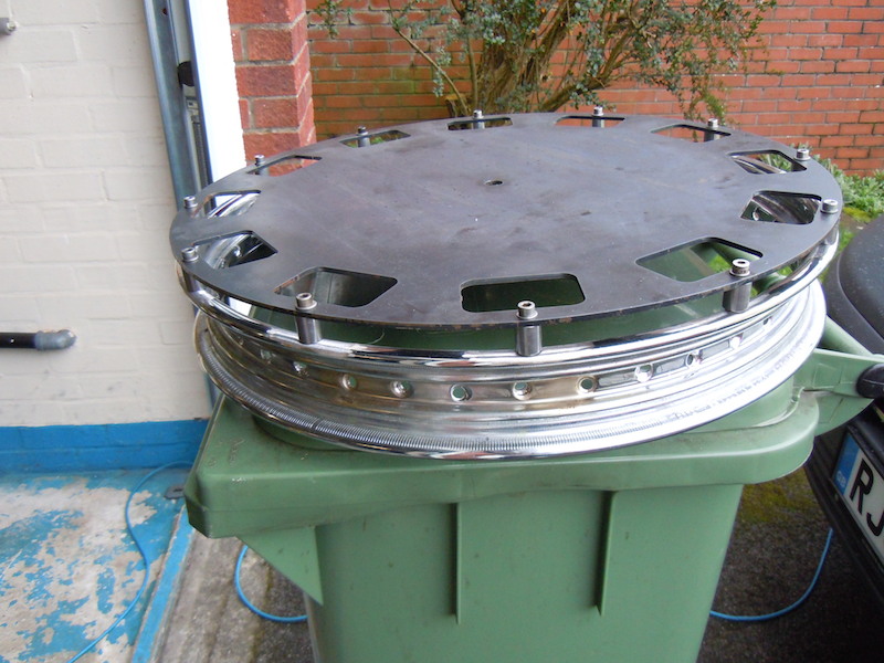

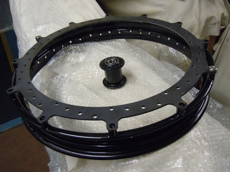

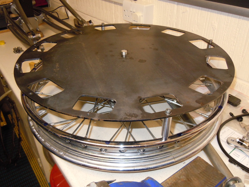

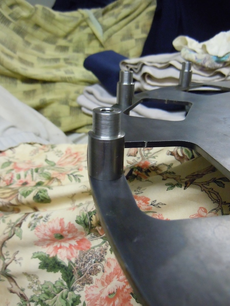

    Once the rim was drilled I stripped the wheels down, fitted the disc mounts to the jig & assembled it for welding.
    Once that was done the new spool hub & rim went for powder coating, (the disc in the picture is a dummy just for checking alignment).

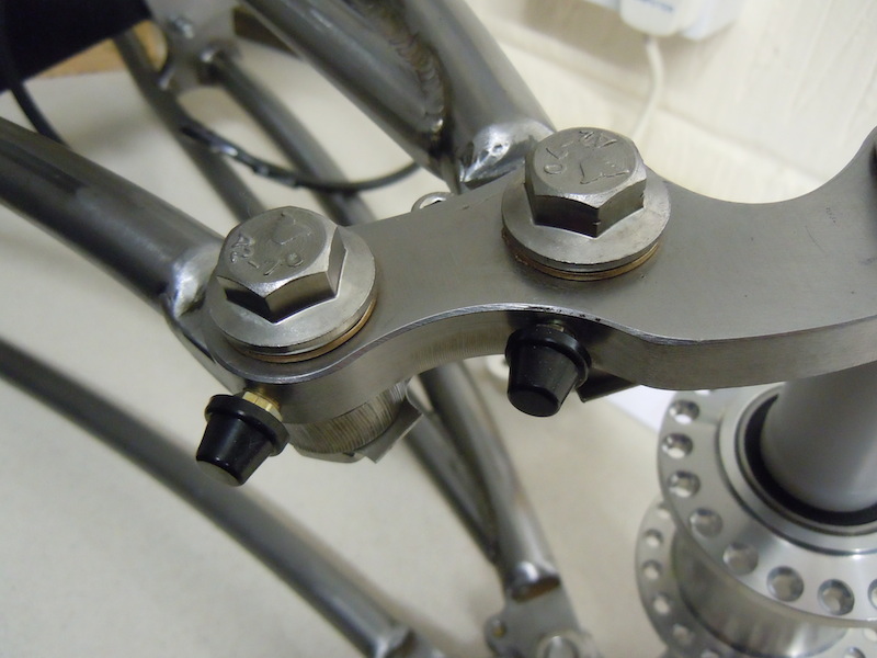

    Meanwhile the forks arrived from Holland & I fitted some grease nipples to aid future lubrication.

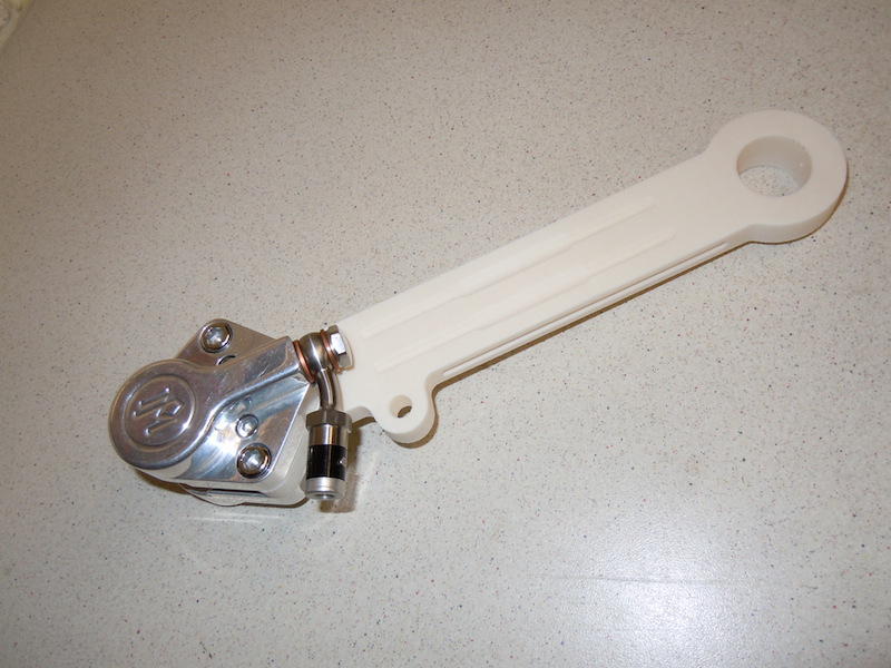

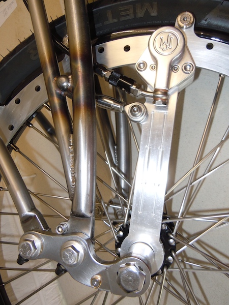

    Front caliper mounting arm was next. The previous one again I made on a mates miller. Once I'd finished it I had another mate draw it for me with Solidworks. That way if I ever needed another I could get someone to CNC it for me. So got it CNC'd after checking it all worked with a 3D print.
    DSCN3328.JPG The finished arm & torque link fitted.

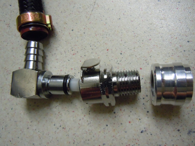

    The first bike had a single tank that fitted between the two top frame tubes, this will have twin tanks that will fit either side of the top frame tubes. The first bike has a limited range, around 50 miles because it had to fit between the frame tubes. I'm hoping by making twin tanks I can get them made a bit bigger & they will hold enough fuel to go for 70 miles !! Because of this they will need a balance pipe so I made some bungs to fit a balance pipe to to bottom of the two tanks. It will have quick release, self-sealing fittings at either end. I might then be able to mount some of the electrics between the two tanks too if they will fit. That way there'll be more room for the battery in the battery box.

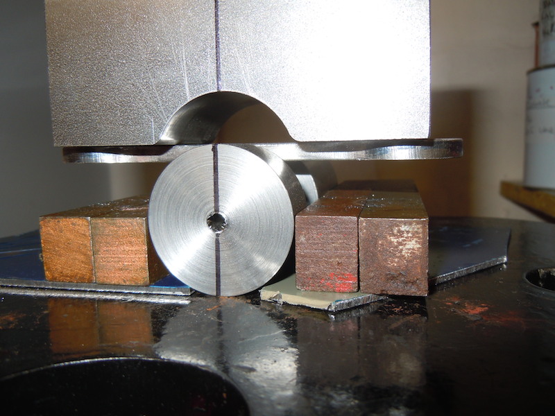

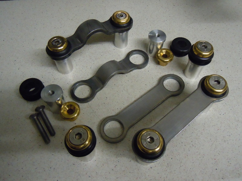

    I then made the mounting brackets for the tanks, the two curved brackets are for the top mounts & the flat brackets are for the bottom mounts, (brackets were laser cut by a local engineering firm 'cos I was lazy !!). The bending jig I made to go in my hydraulic press, which made bending the two top brackets much easier.
    DSCN3713.JPG Finished parts ready for the tanks to be made.

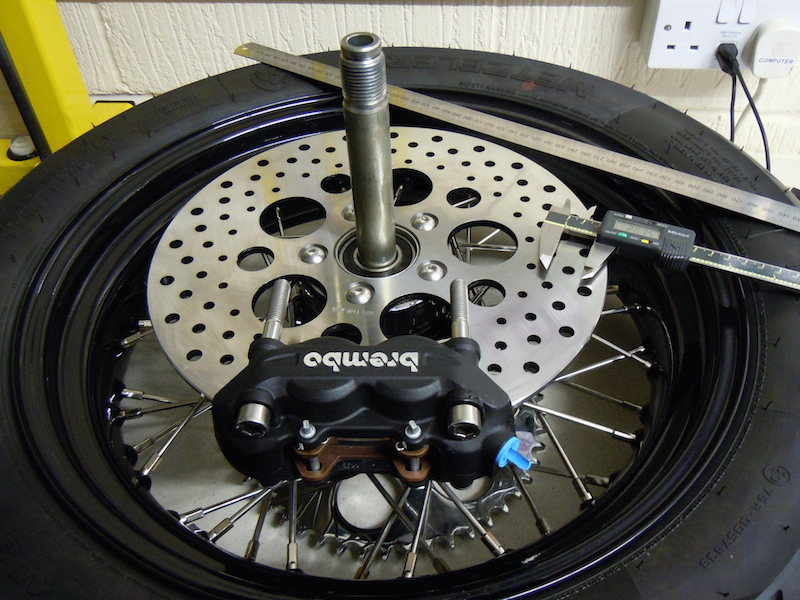

    I already had the rear wheel ready. I used a 240 section tyre on the first bike, but wanted a narrower one for this bike. Got a Harley Night Train 17" wheel off Ebay & stripped it, got it powder coated & re-spoked with stainless spokes.
    The advantge of a narrower wheel is that it means the primary drive can be closer to the centre line of the bike, so you can lean over a bit more when cornering. The first bike goes round right-hands bends slightly better than left-hand bends !! Neither of which are very good at all !! Cornering is not the first bike's strong point !

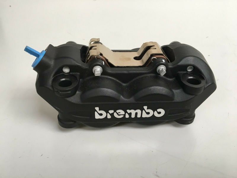

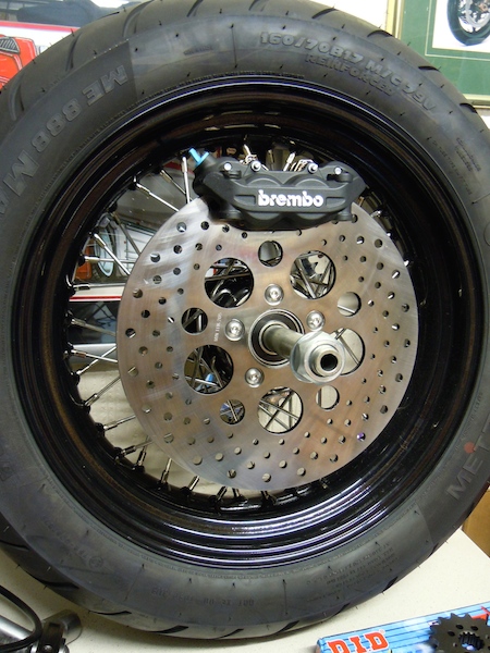

    This morning a caliper arrived in the post so I can get on now with drawing the rear caliper mounting arm & getting that made.
    s-l1600d.jpg When fitted to the bike the caliper will be under-slung, same as the first one.

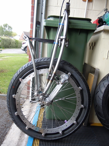

    DSCN3754.JPG This is where I'm up to at the moment.

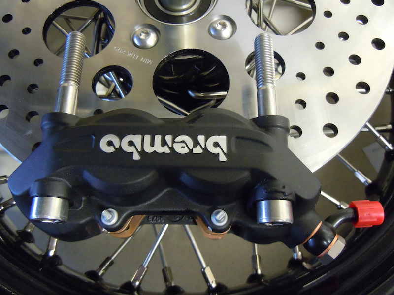

  12. Continued with my measuring today & noticed that the banjo bolt for the caliper was too long & didn't clamp the copper washers & banjo body before it tightened up in the caliper body. So, wizzed a millimeter off the bolt on my lathe. Tightens up nicely now. One job less to worry about when it comes to fitting the caliper in a few years time !
