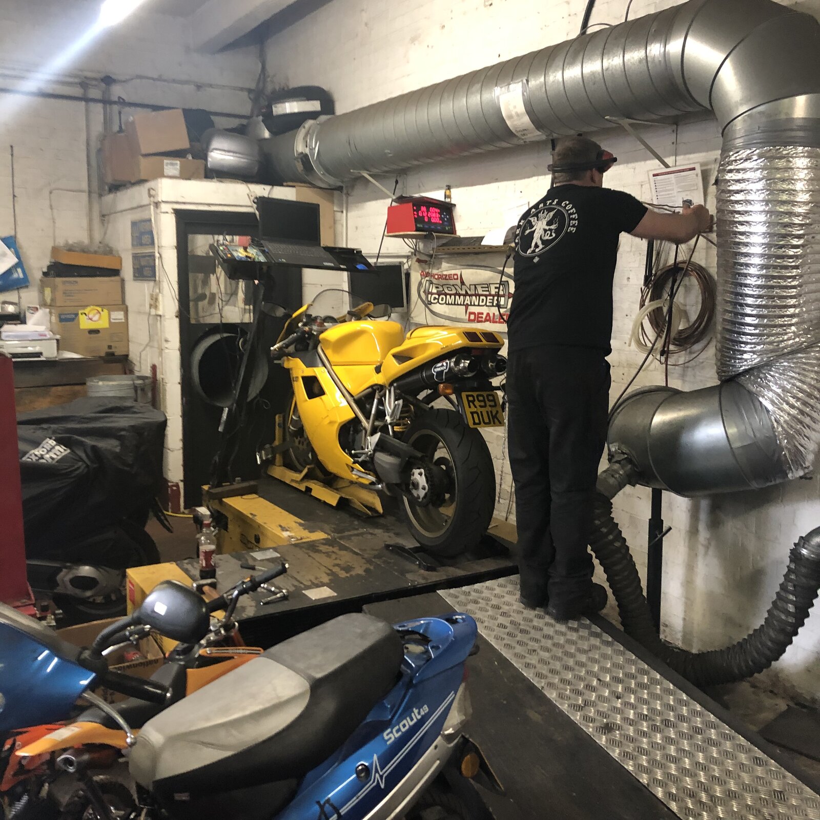

    I called them today and have booked in my 1998 916 for NOx testing, if below the TFL threshold they inform TFL and my bike will be exempt. I asked what the likelihood was for a 20 year old bike and they told me they have yet to find a bike that hasn’t passed!
    So fingers crossed ....

  4. @Shorty4045 Defijitely looking forward to your test outcome! When are you booked in?
  5. Monday 29th April ...

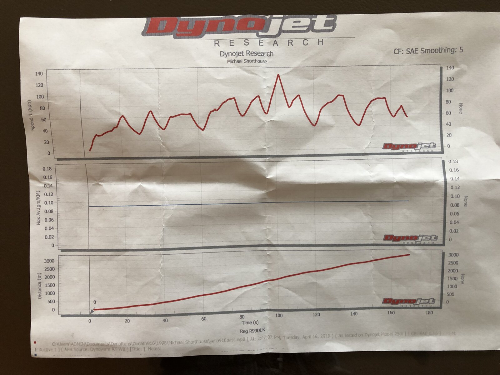

  6. Got a slot today .. first reading was 0.16g/km vs 0.15 and so a fail, but you can make adjustments and try again so taped up one of the air intakes which reduced the NOx to 0.09 g/km which is a pass.
    They will inform TFL who then confirm to me in writing that my bike is now ULEZ exempt :)
