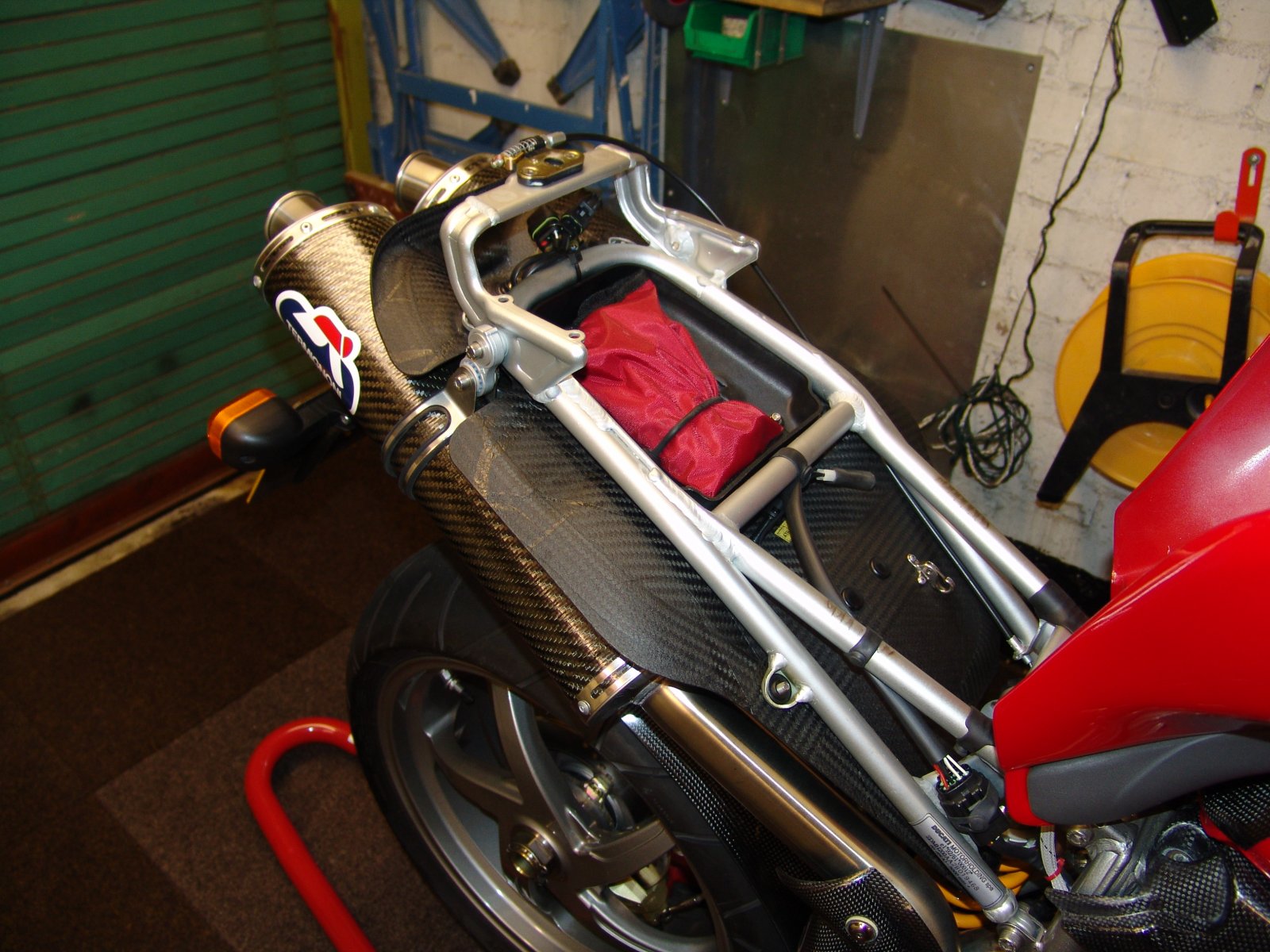

  9. Anyhow....mono seat can be fitted onto a BP subframe. You just need to adjust the spacers for the seat lock.
    Or...you can go the whole hog and fit a mono alloy subframe but you then lose the pillion pegs etc and it'll cost more.

  13. If it's of any Help this is a mono sub frame picture.

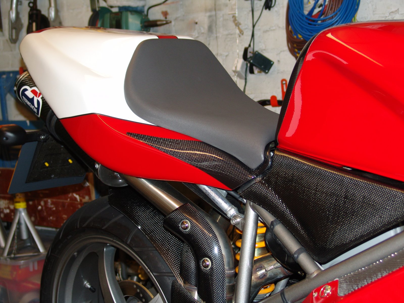

  14. Here's a picture of my seat unit.
  15. You will need spacers to raise the seat lock plate to the correct height, these tend to vary bike to bike and for different types\makes of seat. A bracket for the mono seat which takes the lock plate and the rear light unit, I use the 748R type bracket, or you can use one that is often sold via eBay but is more expensive. Finally the foam triangles which sit on each air vent or side of the seat to help prevent the seat rocking.
    If necessary you can use a riser block at the front but a genuine seat should not require it.
    If you check my other posts you should see a few that refer to this conversion in a bit more detail.
    If you buy a seat without any rear plate attachment points then I can advise on how you can set up the seat by glassing in some threaded spacers to give the necessary attachment points.
