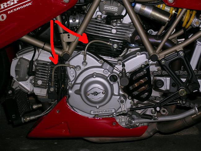

  8. Don’t forget that the 904cc two valve engine is designed to have the barrels oil cooled.
    The Oil and water galleries are similar on the 904 and 944 engines, but not identical. They can be modified to suit though. You would also have to clean the water gallery of all limescale and other deposits before connecting it to the engines lubrication circuit, otherwise it may not last long till new bearings etc. become necessary!
  9. There are two types of barrel on 904cc two valve engines.
    Early ones had external lines to/from the barrels, whereas later ones had internal galleries.
    This is the early ‘93 type (Thanks for the image @Nasher !)

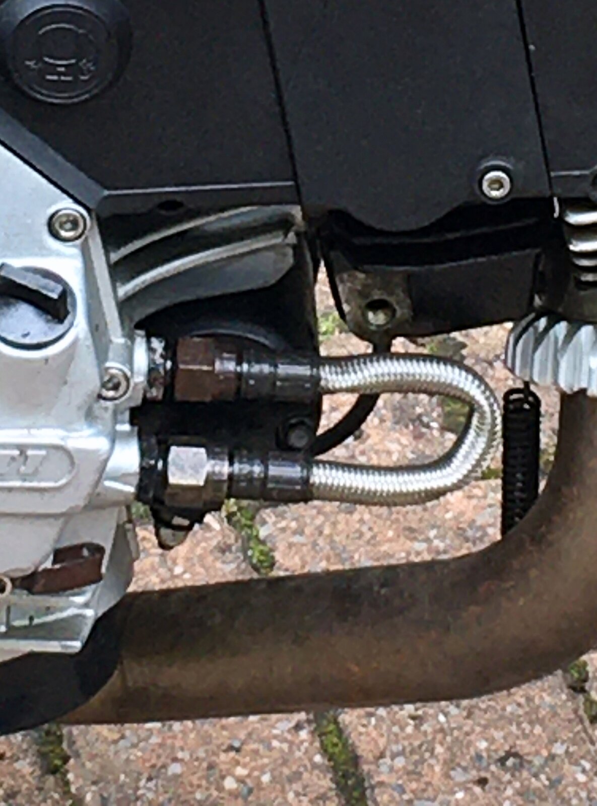

    Oil cooler eliminator..
    • Useful Useful x 2
  18. Is it a single phase or 3 phase motor? If you are not going for injection there could be difficulties in triggering an ignition system. I think the single phase might accept the flywheel and pick ups from a Monster or SS but the 3 phase definitely won't,
  19. In our UK climate an air cooled Ducati twin even when used in anger on the road rarely needs an oil cooler.
    I find myself often blanking off the cooler on my 950cc highly tuned air cooled twin.
    I made up a little alloy plate to cover the oil cooler that sits under the seat with a few spare cable ties for the job.
    Oddly so my seriously tuned 140 rwbhp 851/955cc Desmoquatro also suffers from over cooling, (it's fitted with a Corse 888/926 rad') on anything other than really hot days. Most of the time I tape off a 1/3rd of the rad.
    Steve R
  20. Or you can get the M600 pipes to connect to the carb heaters when there isn’t an oil cooler fitted?
