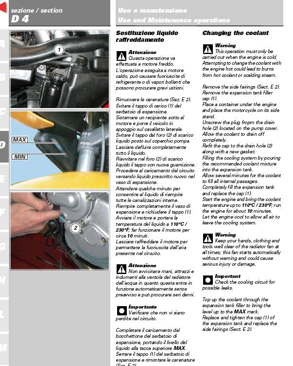

  1. I tried nipping up the drain plug and have stripped the thread:rage:
    I feel like there may be extra good thread behind the front 7mm that has stripped. Which means I may be ok using a drain plug/screw with a longer M10 x 1mm pitch thread. The standard drain plug has 8mm below the head with a 1mm thick washer.
    Has anyone had to overcome this problem before? Found a good solution?
    I would rather not go down the helicoil/screwed insert road if I don't have to, as it is only a drain plug.

  7. Can you put a picture up?
    You sure it was the coolant drain?
  8. That's why I'm baffled by the M10 drain plug. This is from the manual...
  9. Yep, #2.
  10. The plug head only uses a small Allen key but I'm pretty sure they're bigger than M6 thread :Bookworm:
  11. Yes it is definitely M10 x 1mm pitch. The head diameter is small than an M10 Cap head screw. Hexagon socket is the same size as the M6 engine screws.
    Banjo bolt is a good tip. I have borrowed a gauge so hope to get a better idea on the thread condition tonight.

  14. Deeper threads are perfect and there are 5.5mm of them which is plenty for this application. Just need to get the optimum M10 x 1 screw now.

  16. Sorry, just spotted your reply. I didn't have a banjo bolt to try but I would think it would work. However because of the poor quality of the thread in the cover, I had a screw made to give a tightish fit.
