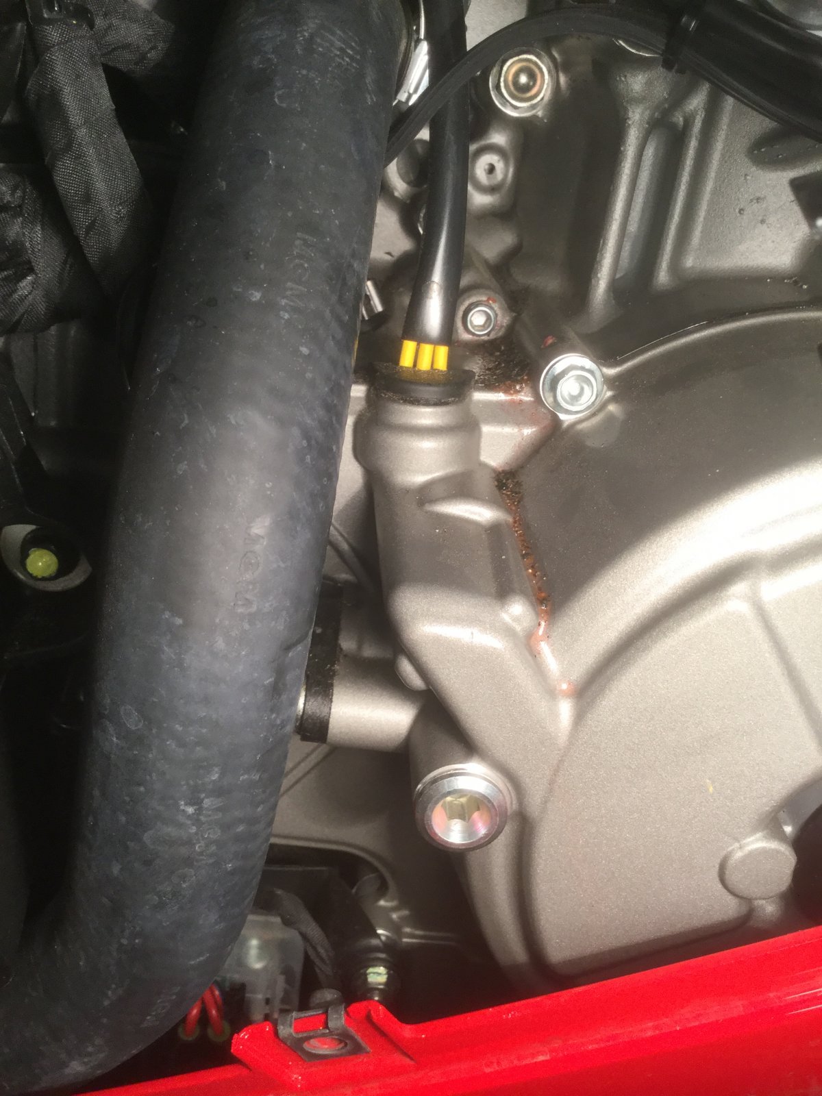

  1. Has anyone has this issue of a coolant leak on the left hand side? Seemingly coming from a small bolt in the side of the engine. I had this same leak on my 899.

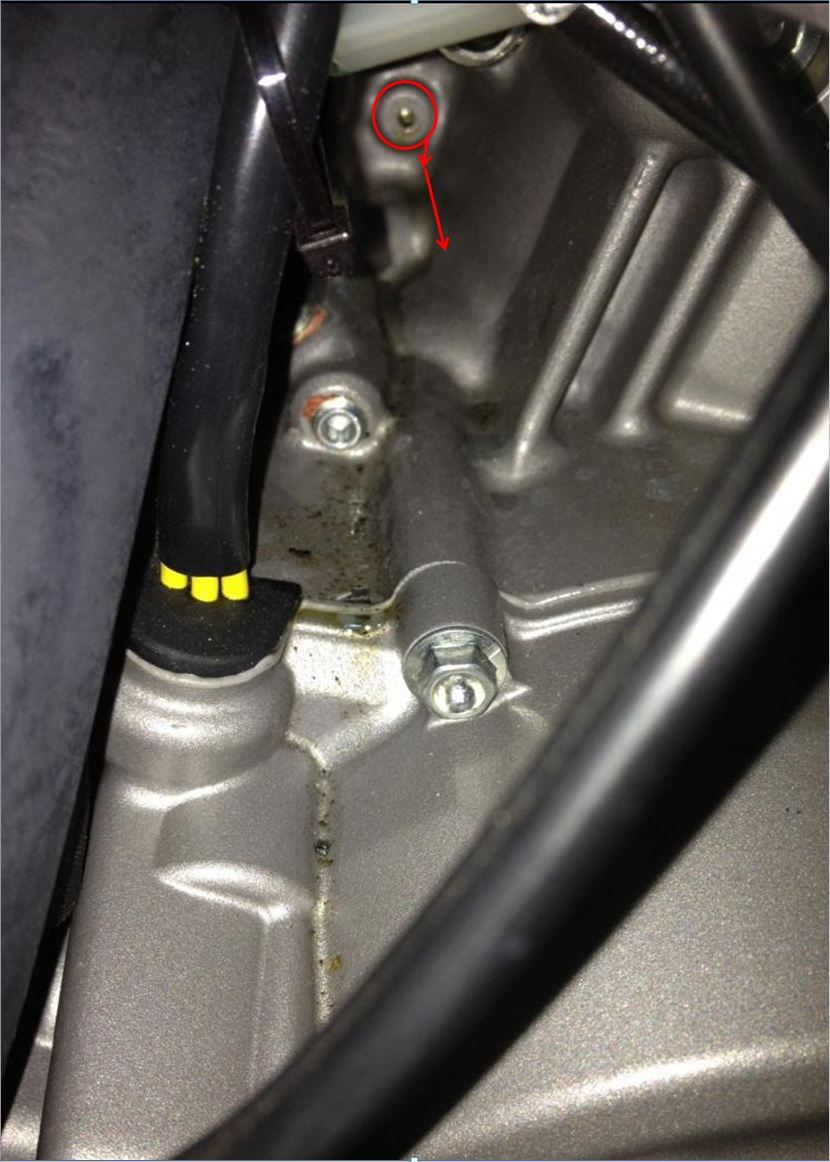

  2. Normally if it comes from the "weep hole", that is a sign of coolant pump seal failure. Hope that is not the case.

  7. lets have a pic then?
    water pump weap hole is normal for 1000-2000 miles, then it stops, the engine opens up, and you learn to ride it :upyeah:
  8. Flat fish - I don't see this peep hole. Do you have any more info?
    Cheers.
  9. appy polly loggy, it was an teeny oil weap, not coolant.
    here look.....

    Mine is leaking coolant from the front bolt in your picture. Out the top of it. Also your bike seems to have grey sealant where mine has black.
  12. post a pic dude. Many have coolant, or oil, or both from this area. 1199 and 1299

  15. Razz - that's exactly what mine looks like. Identical!
    Gonna call Ducati Cambridge tomorrow and talk about it. They're my 2nd nearest dealer.
