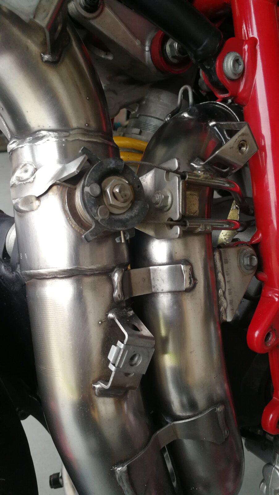

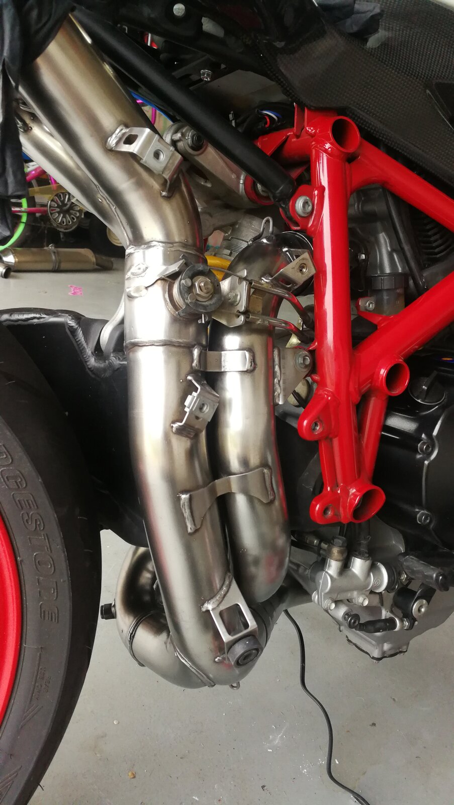

  1. I figure if I was going to be home I would finally tackle restoring the exhaust on my 848. I bought the bike used and the pipes were in a sad state with substantial tarnishing and stains. I haven't rubbed this hard for this long with my right hand since I hit puberty. Long story short, after 2 days, 8 Scothbrite green pads, half a bottle of Brasso, a 1/4 tube of Autosol, and endless regret for having even started this project I must say I am very pleased with the results.
    I really like the satin finish of the pipes. I purposely left some imperfections for a more industrial look.

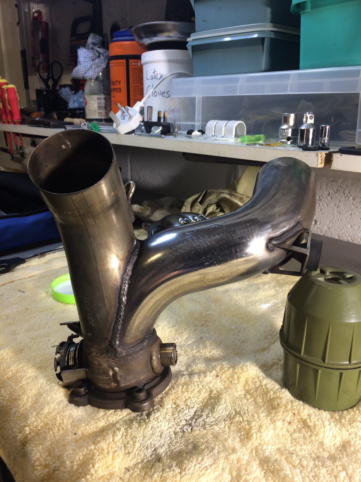

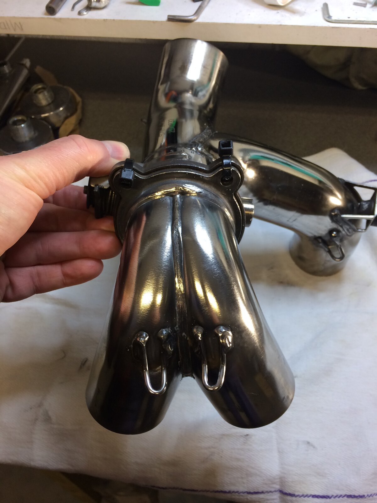

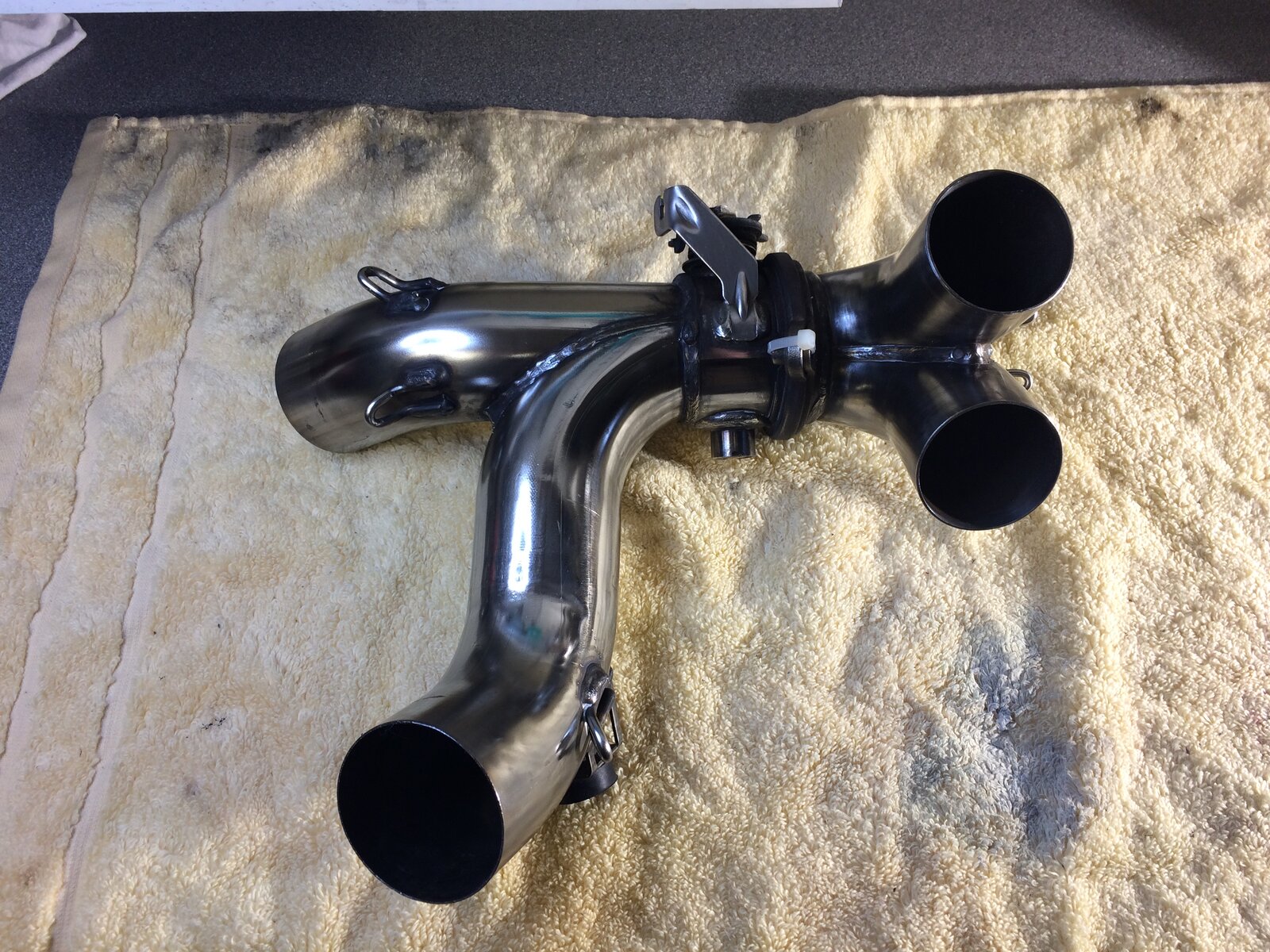

  11. Voila
  12. Luckily i’ve got one of these polishers for my job. It takes 75mm velcro fastening sanding discs aswell.
    Started carefully with 180 grit on some welding spatter and a scuff under bottom pipe and then 320 grit, 500, 1000, 2000 where needed.
    Then the metal polishes.
    A soft interface pad between polisher and disc of choice helps on curved surfaces.

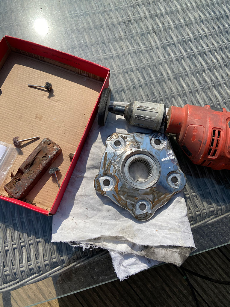

  14. Great effort @tboooe, polishing is strangely addictive. I use jewellers rouge bars and before metal polish, they're sort of wax cutting compounds. Maketh things very shiny.. IMG_0685.jpg
