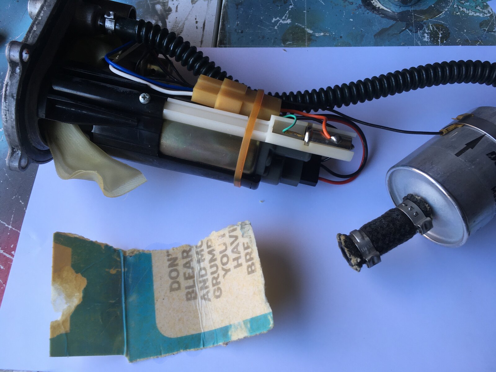

    Had to get my mate to rescue me with a trailer. So after a little diagnosis it turns out to be the classic fuel pump pipe slip. Which i’d Read about and never checked on my previously unloved 2006 SC.
    So dove in with fuel pump out, order new seals and filter, thank you eBay with part number and o-ring measurement avoided the factory prices and they weren’t delivering either. There was a chunk of cardboard floating around in there too..!

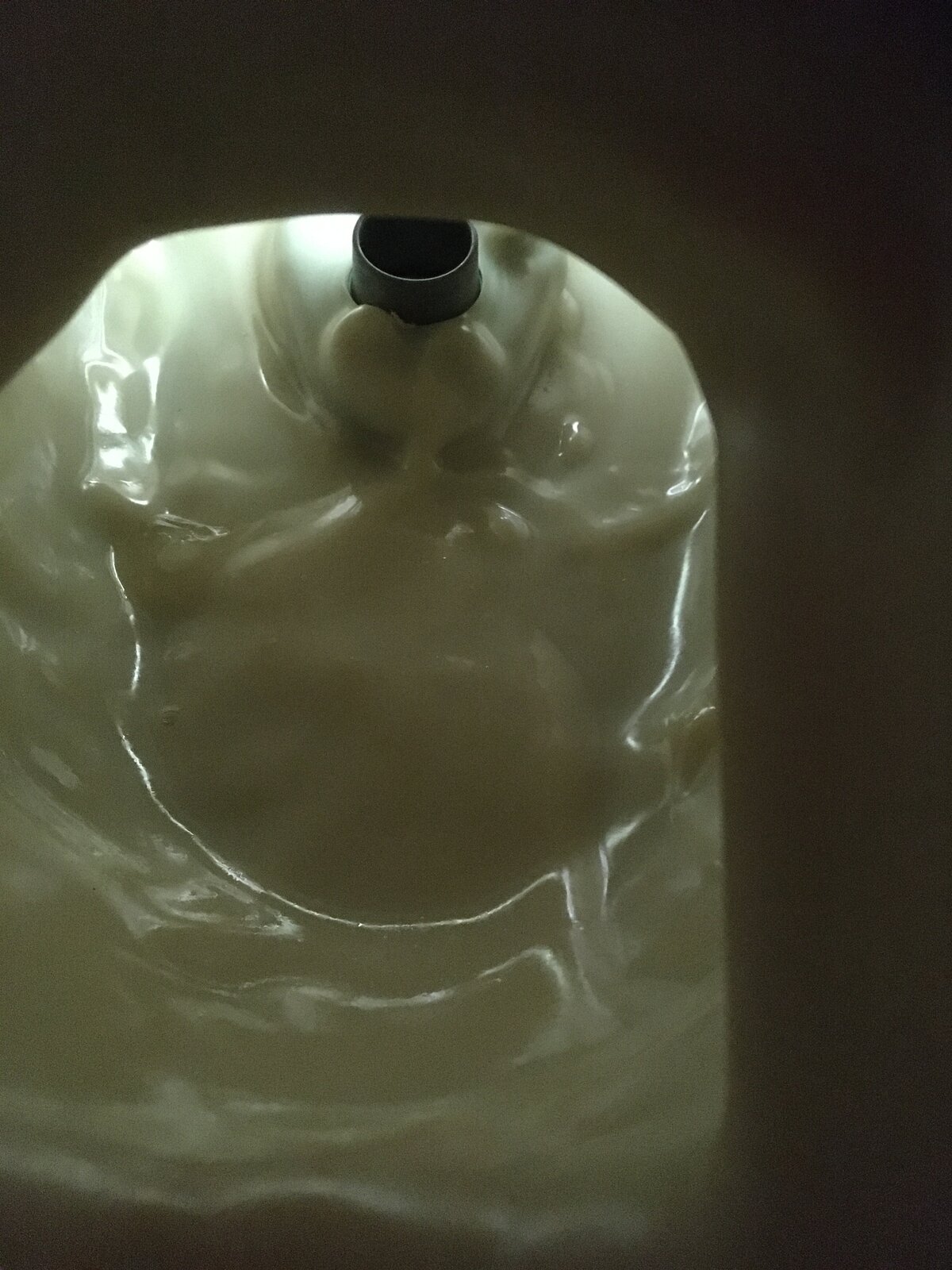

    As the bike has been imported from the USA and they have big problems with the E10 gas over there the tank has been lined with.. goo. Lots of it. It is pretty hard and ain’t going anywhere.
    Turns out it was the original fuel filter, at least from 2005, split it open just to see.. fairly contaminated. I replaced the short fuel pipe with some in-fuel stuff and then lockwired the assembly so it cannot pop off in the future. The bead is simply too small on that fuel pump.

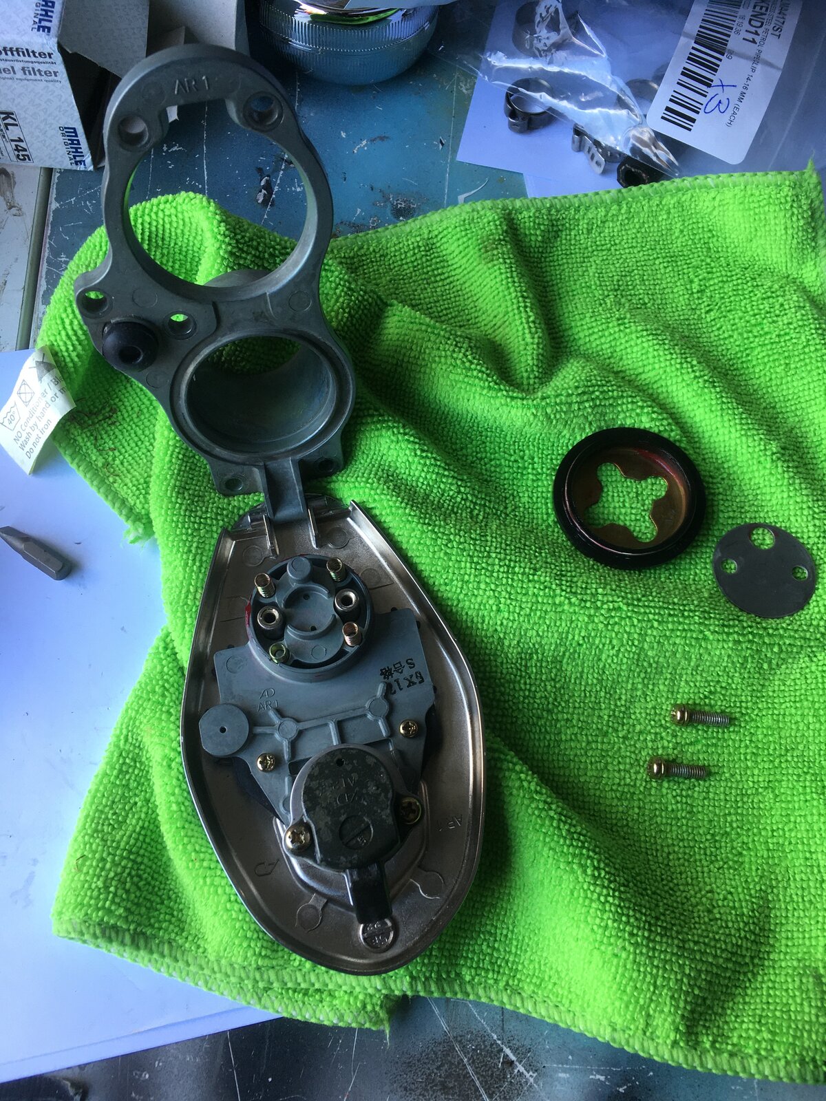

    At the same time changed the damaged o-ring on the filler assembly to stop the water ingress, which has previously halted progress on one occasion.. all a bit crusty in the seal mechanism, but easy enough to clean and lube.
    All back together and running as it should, I changed the old plastic quick release fuel unions for new ones which is a massive improvement over tired versions! No need for the cable tie and worry of a fireball..

    Here’s a shot of the bizarre coating in the tank..

  5. Good luck sorting the problem. Worth checking the pump relay - another common fuel system issue to stop them in their tracks.
    An initial check to confirm a loose fuel pipe is to lean the bike from side to side and try to hear if the fuel filter is clonking around in the tank. I heard that bit of advise out after taking the fuel pump out at home, it wouldn't have changed anything but would have spent less time trying to 'fix' the bike by the roadside..
