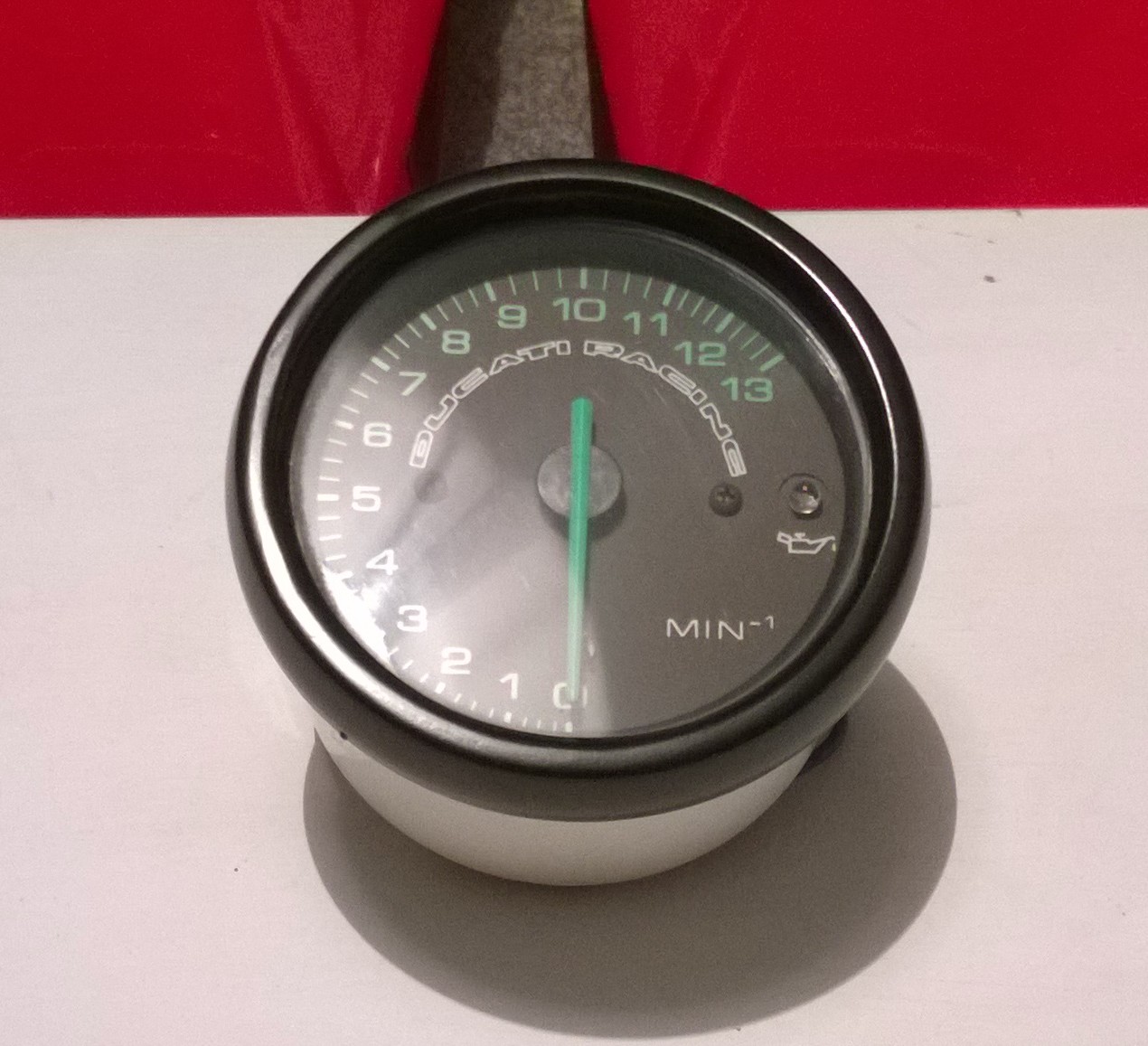

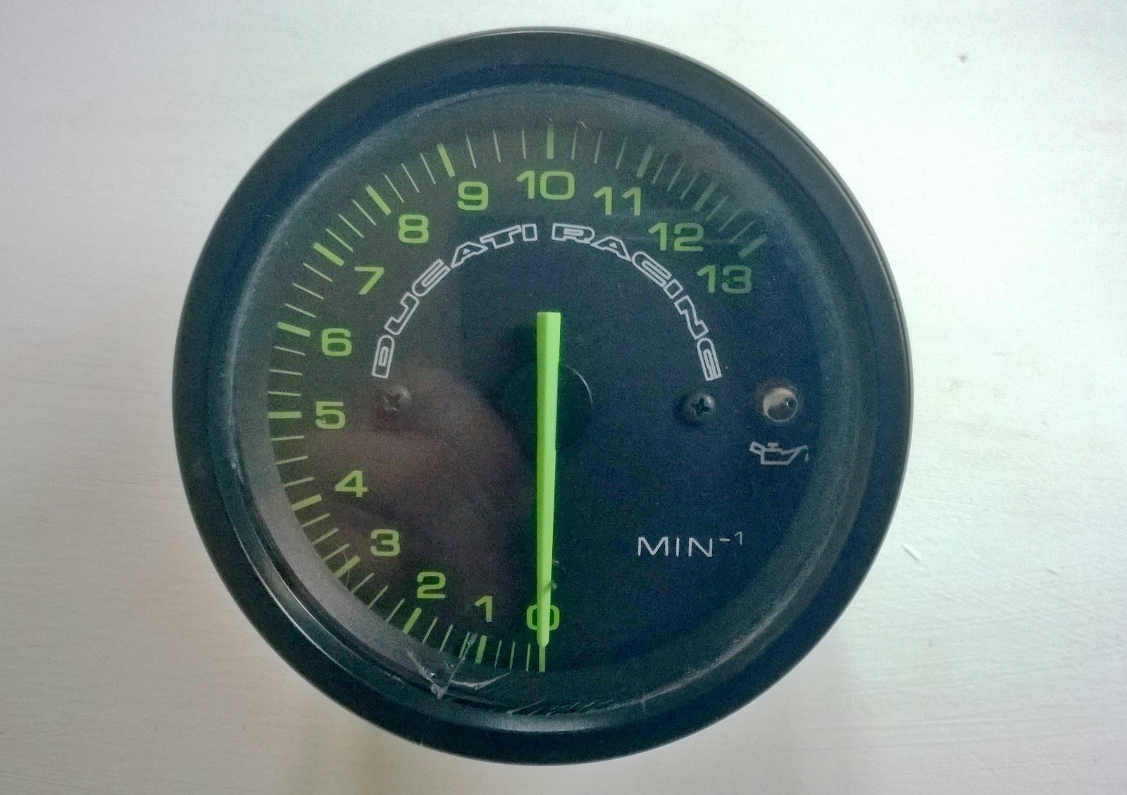

  1. A nice small project, another 916 with cracked instrument glass (well perspex) I've done a few of these in the past, but its been a while.

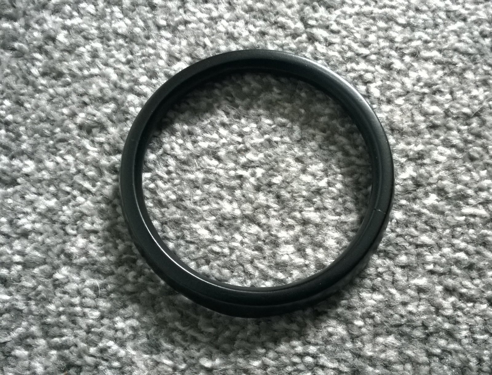

  2. First job is to remove the bezel. I use a new scalpel to cut the joint between the bezel and the body of the instruments.
    #2 Ed31, May 1, 2018

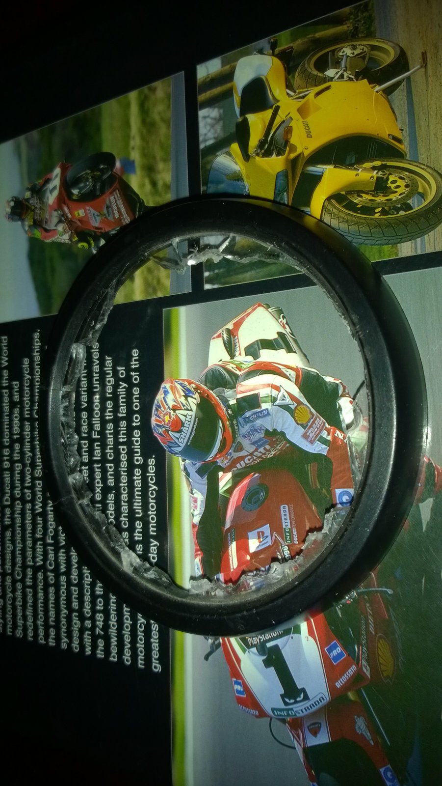

  3. The Perspex can then be removed roughly. I'm going to use a router to remove the final bits. The Perspex is bonded to the bezel to make it more fun.
  4. The bezel has a crack in it, so will infill the hollow back with a 2 part epoxy resin, before cutting new Perspex.

  10. With the Perspex cut out, I hand sanded a chamfer (400 paper) a bit like a valve/valve seat onto the old bezel and the new Perspex. This makes a nice accurate join, the plan being to keep it all looking stock and unmolested. The new Perspex is then glued into the old bezel (I use an activated super glue) After checking its water tight, I then used clear silicone to re attach the bezel to the instruments, that way it can always be removed in the future, without too much hassle.
  11. All done.
