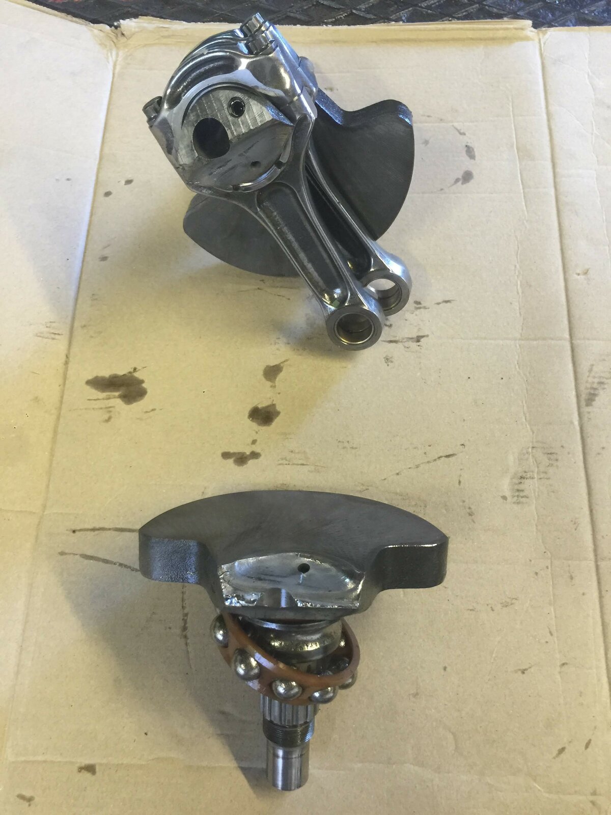

  1. Ouch just found my 2011 carbon has a snapped crank 18000 miles Full Ducati service history !!!! Nightmare to say the least.

  10. Thanks for info .mime has sheared behind the generator ,retaining nut was still tight

  14. its about where the mains bearing sit and the shape of the hole...the crank didn't just snap. it would of took time.. got out of shape and vibrated.
  15. It is exactly like the American lad on YouTube when you search Diavel snapped crank except my nut was tight . It happened changing from second to first coming on to a roundabout .bummer !!!
