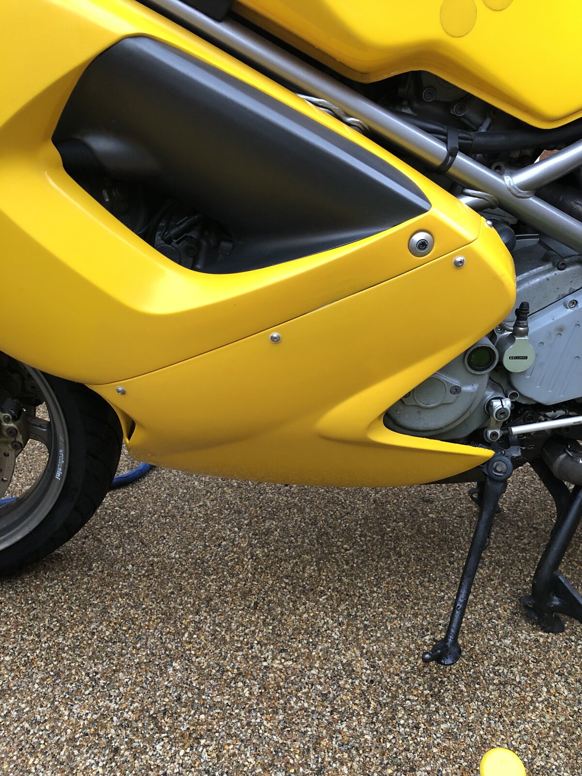

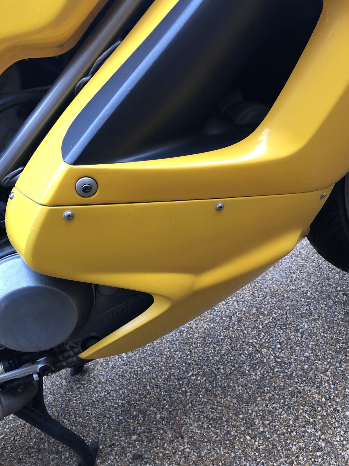

  19. Guys just a bit of an update I have taken the plunge are sealing up these holes and so far it doesn’t look too bad! Just ordered to Ducati yellow! Over the next few days I will be wet and drying to get the right finish. Photos to follow
  20. Not perfect but looks 100% better than the crappy holes!!
