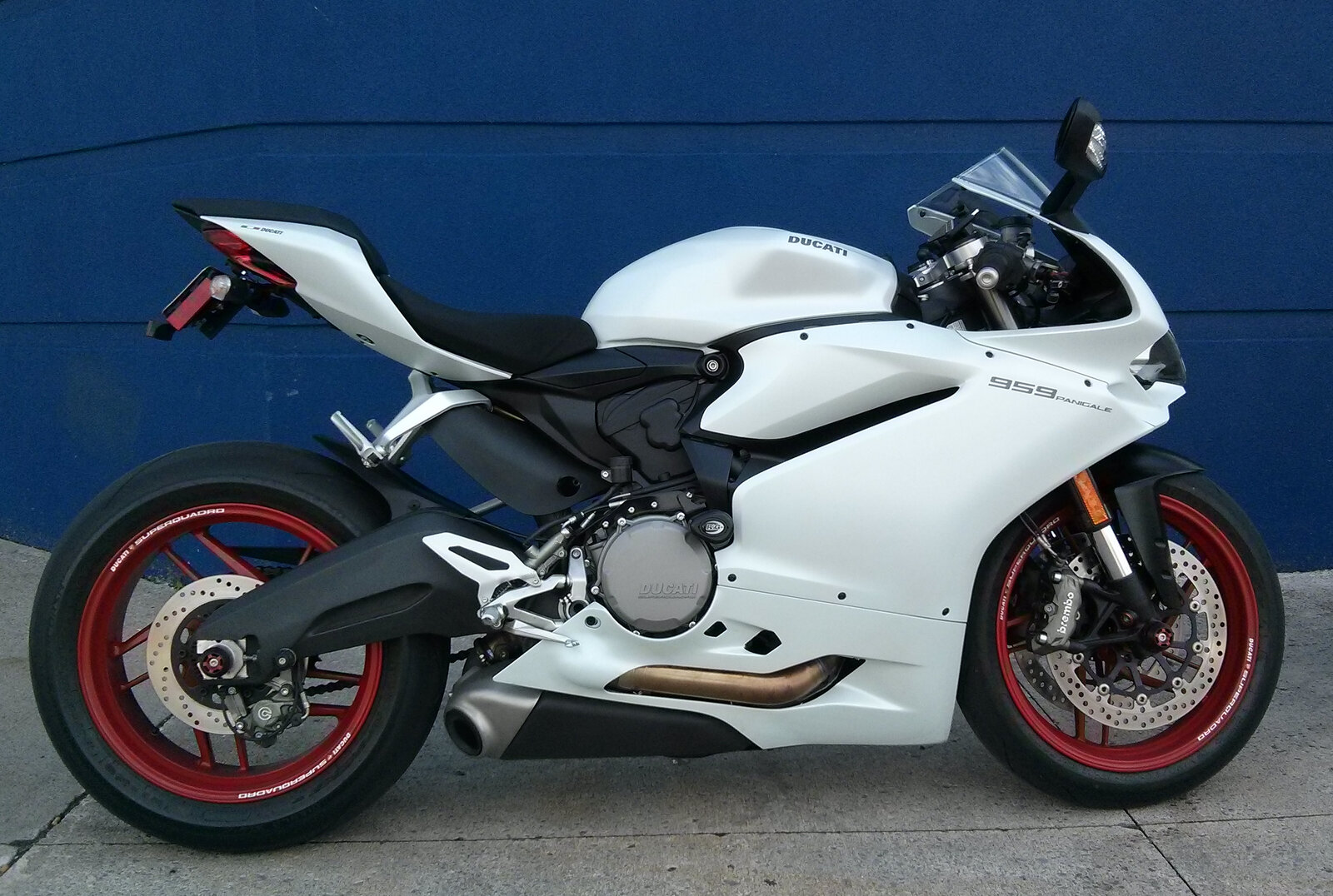

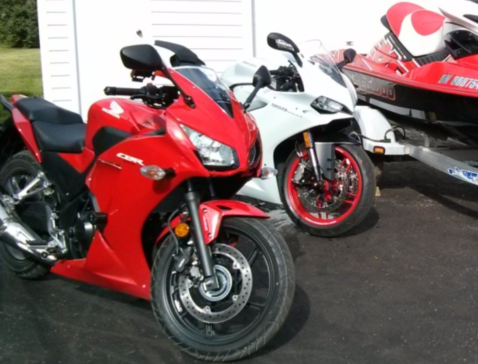

  5. I have mixed feelings about frame sliders.
    I had a set of R&G on both my Panigale and my wife's CBR300R.
    All they did was save the handlebar end on my wife's bike a few times.
    They did not help the Panigale at all when it inadvertently fell off the side stand.
    The clip-on and mirror took one for the team. Slider didn't even touch the ground.
    IMHO, they're just another thing to replace in a drop. As for a low-side, insurance is best here.

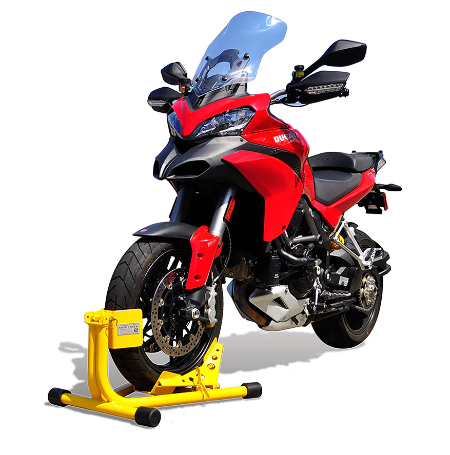

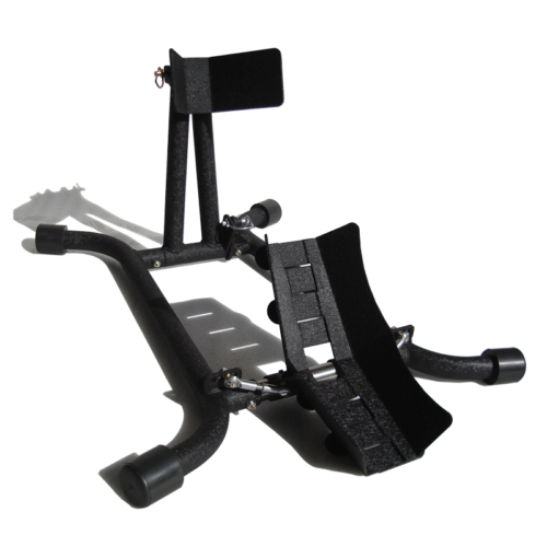

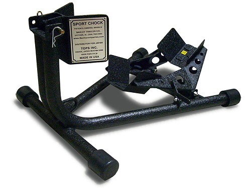

  10. If an inadvertent stationary drop is your concern (and it happened to me while I was reaching for my rear stand), spend the money on a Baxley sport chock:
    I did and it's the best. Safest piece I ever bought for that purpose. Great for trailer hauling and paddock also.
    I have the black one. The yellow is for illustration purpose.

  12. Thanks John.
  13. Baxley makes a version for heavy bikes called the LA Chock.
    Unlike imitations, the Baxley squeezes the tire once in.
    https://www.baxleycompanies.com/
