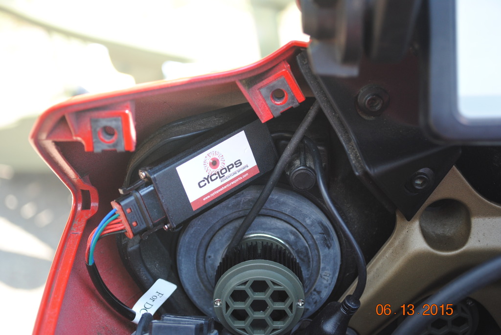

  7. Any photos is of the bulbs and ballast units?

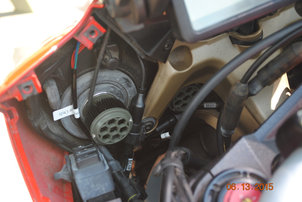

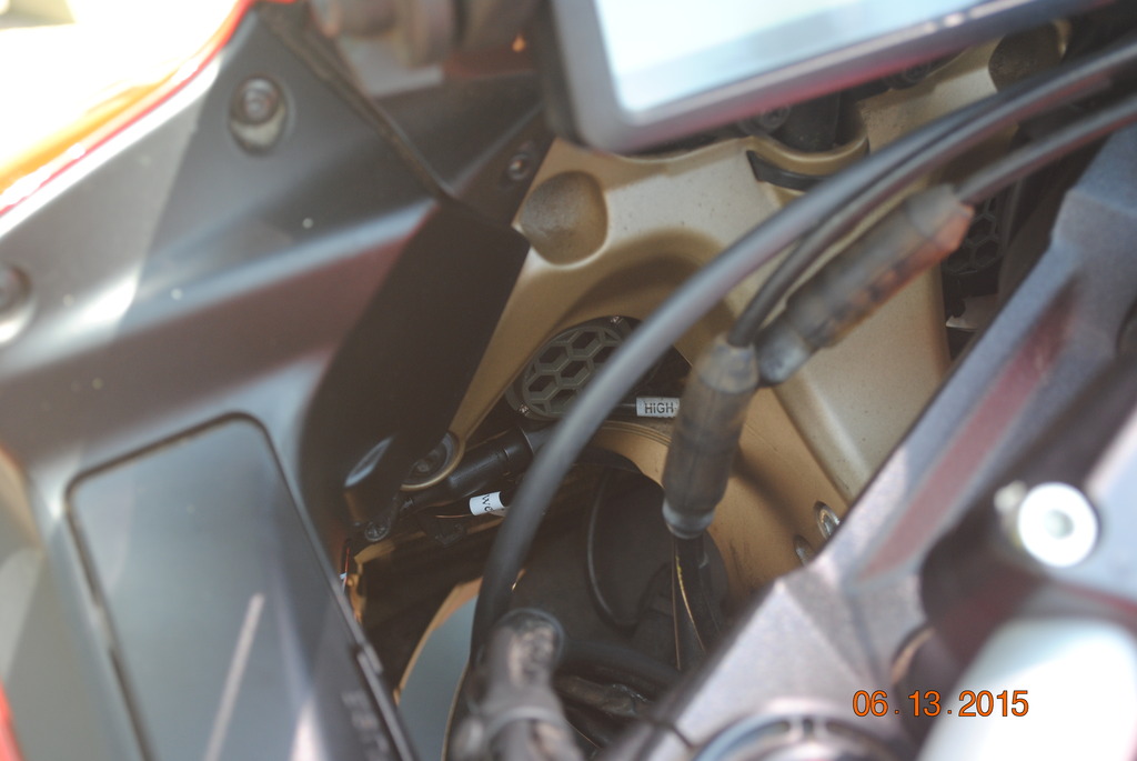

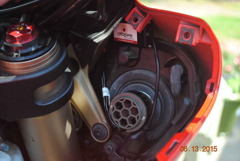

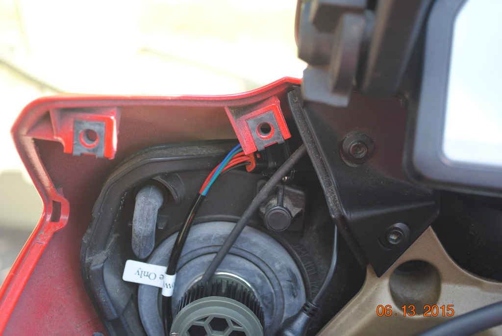

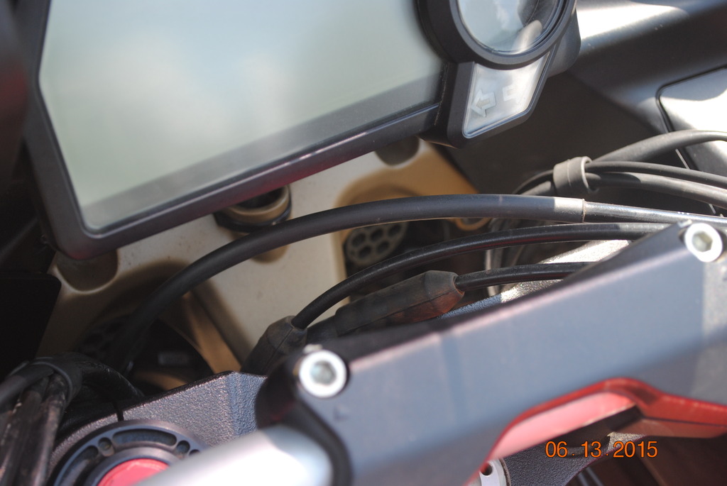

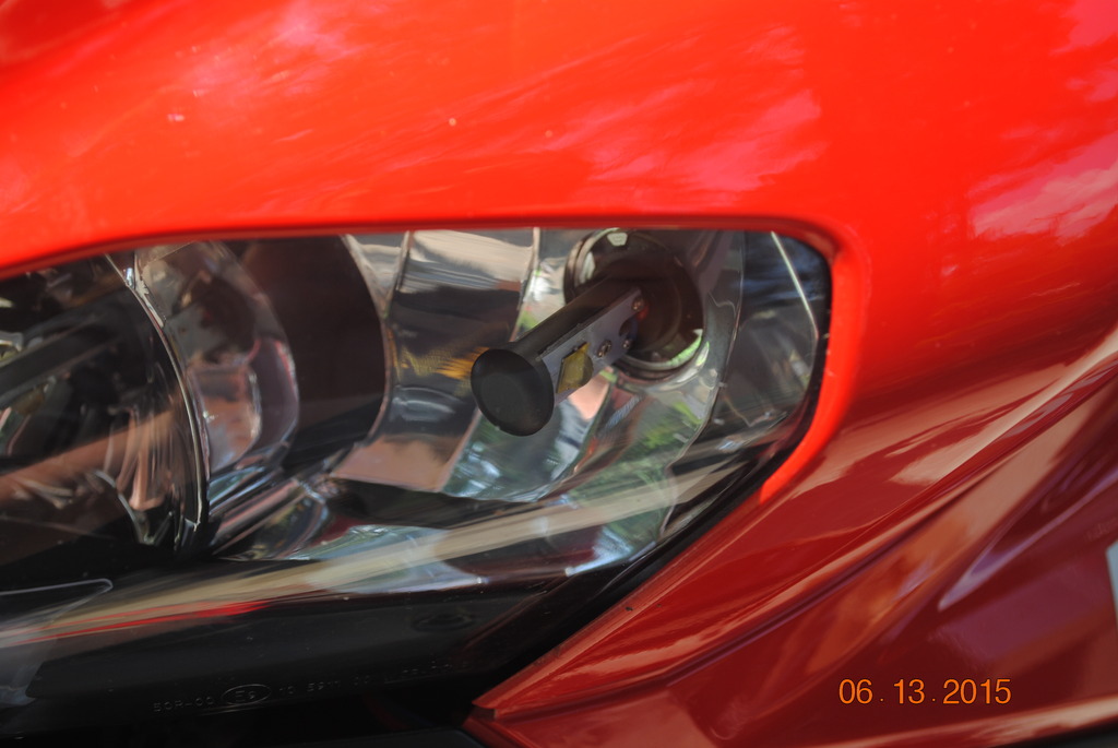

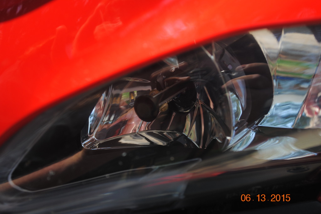

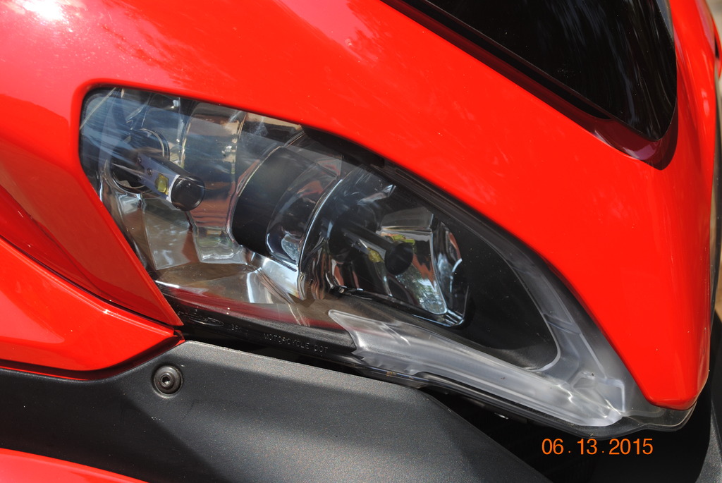

  10. Pictures of the install...
  11. Thanks for posting install photos - really useful [emoji106] [emoji4]
  12. Based on communications with the owner of the company that supplies these bulbs it was suggested that I "Clock" the high beam bulbs opposite of the 45 degree angle they are on now allowing more surface area of the reflector. I have done so (a quick 10 min job with a phillips screw driver and a small drill bit) and the results are fantastic... will be posting some updated pictures hopefully tonight.
