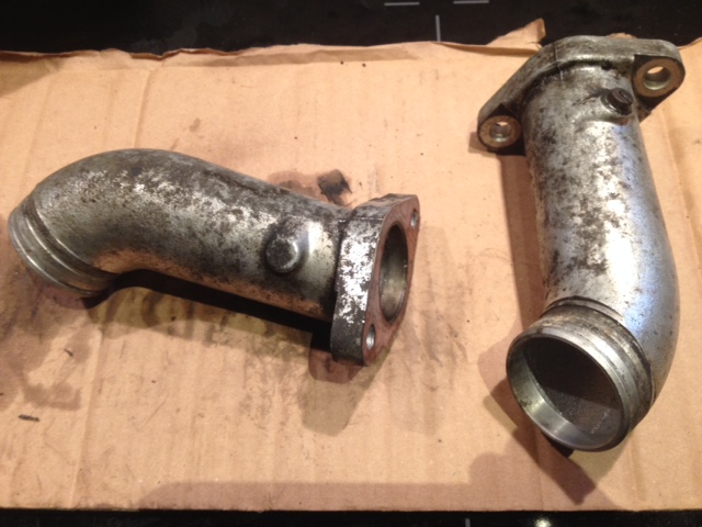

  1. Any advice for how to clean up these inlet ducts? Loads of ingrained deposits.
    Is there an easy way to clean these up? I've tried various methods including a rag with petrol.
    Wire wool/polish?
  2. I’d try a polishing mop in the end of an electric drill and a light abrasive polish like Solvol Autosol or a paint cutting compound before going in with a wire brush. Possibly give them an overnight soak in parrafin. Andy
  3. Steel or alloy??
    Test with a magnet.
  4. It looks like anodised aluminium to me, if it is it looks pitted and will need cleaning up with a Scottish pad or wet and dry paper, you can improve the looks but not get back to original.
    Just my opinion.
    Steve
  5. I sent mine for 999 to powder coaters and got them to sand blast then polished them up with some mops.
