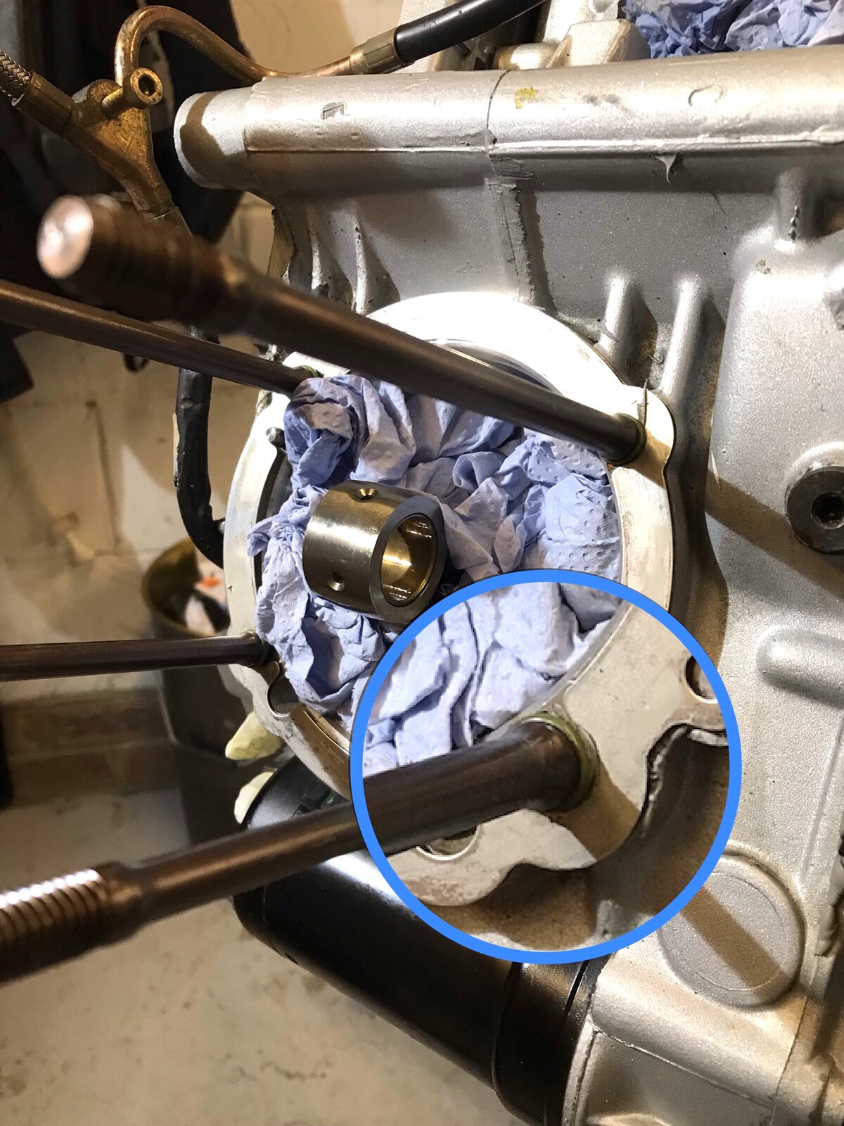

  1. Buggered if I can find a part number for the o rings that fit under the barrels, 4 per barrel. Anyone know? I’m doing gaskets on both cylinders so need to order 8.

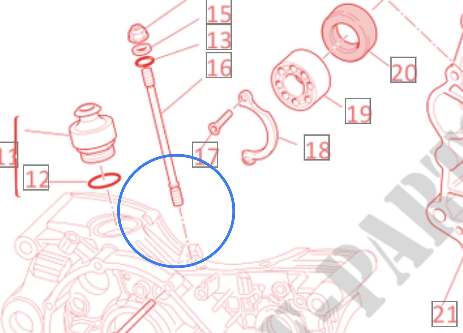

  4. I’ve got a load of o rings to order, side covers coming off the barrels for powdercoat, so dealer should be ok. We just couldn’t find them on the parts diagram in the shop.

  6. Part number is 88641181A. Pretty sure they’re the same as the fuel connector o-rings
  7. Got mine from Pete at GT Plymouth no problem.
  8. Thanks nelly mucho appreciado
  9. just to confirm, they are the same as the quick-release connector "O" rings used on many bikes around that time.
  10. Excellent my local dealer gave me two of those free last visit, 8 more might be pushing my luck though
