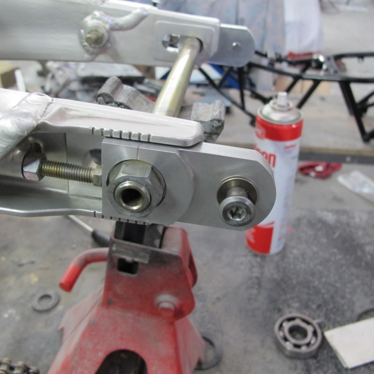

  1. A while back I drilled and tapped the solid section of my 900SS Aluminium swingarm so I could bolt some paddock stand bobbins to it and was/am happy with that.
    Whilst looking for something else last night I came across the picture below, and thought 'that looks trick' I'll machine up some of those in the morning for my 900.
    I did of course realise that it looks like a 1000DS swingarm, so I'd have to machine the stops out of the back of my 900SS arm to extend the adjuster blocks backwards.
    This morning when I though about it again I of course realised that with the bobbins on the adjuster plates, and the bike being held up by them, you can't remove the back wheel!
    I wonder if the guy who posted the image on a US forum realised that before or after he'd done all the work?
    Nasher
  2. Someone is a t*t;) - should have asked someone who had recently fitted an ally swingarm to their SS.:)
    Besides, even if it did work, it would put undue stress on the chain marker ribs because they aren't that thick and strong.:eek:
