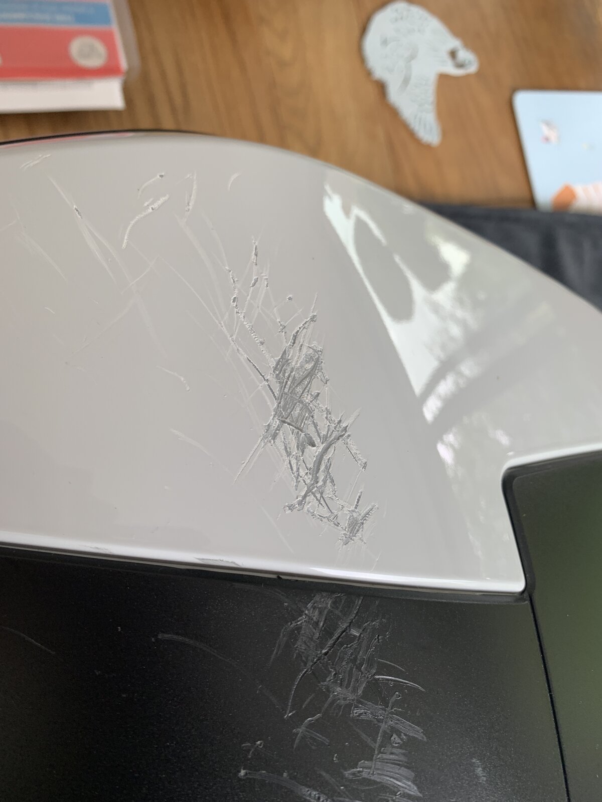

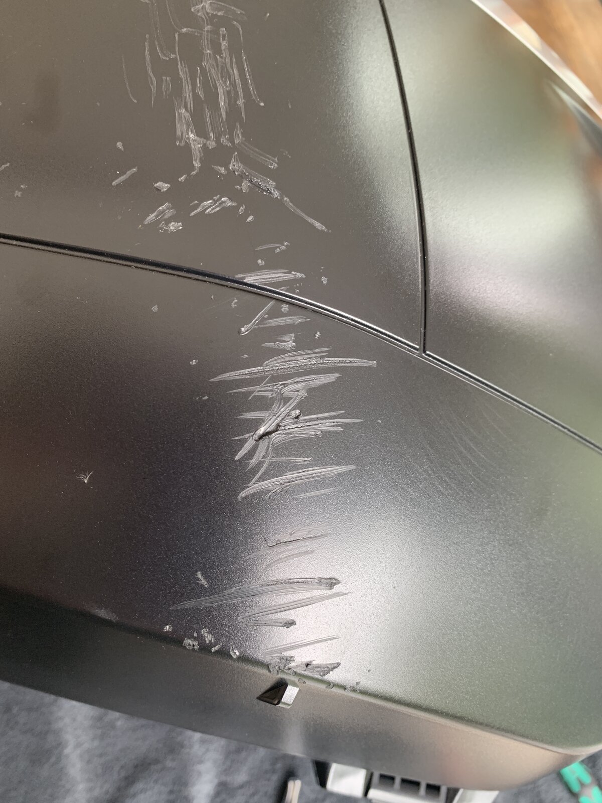

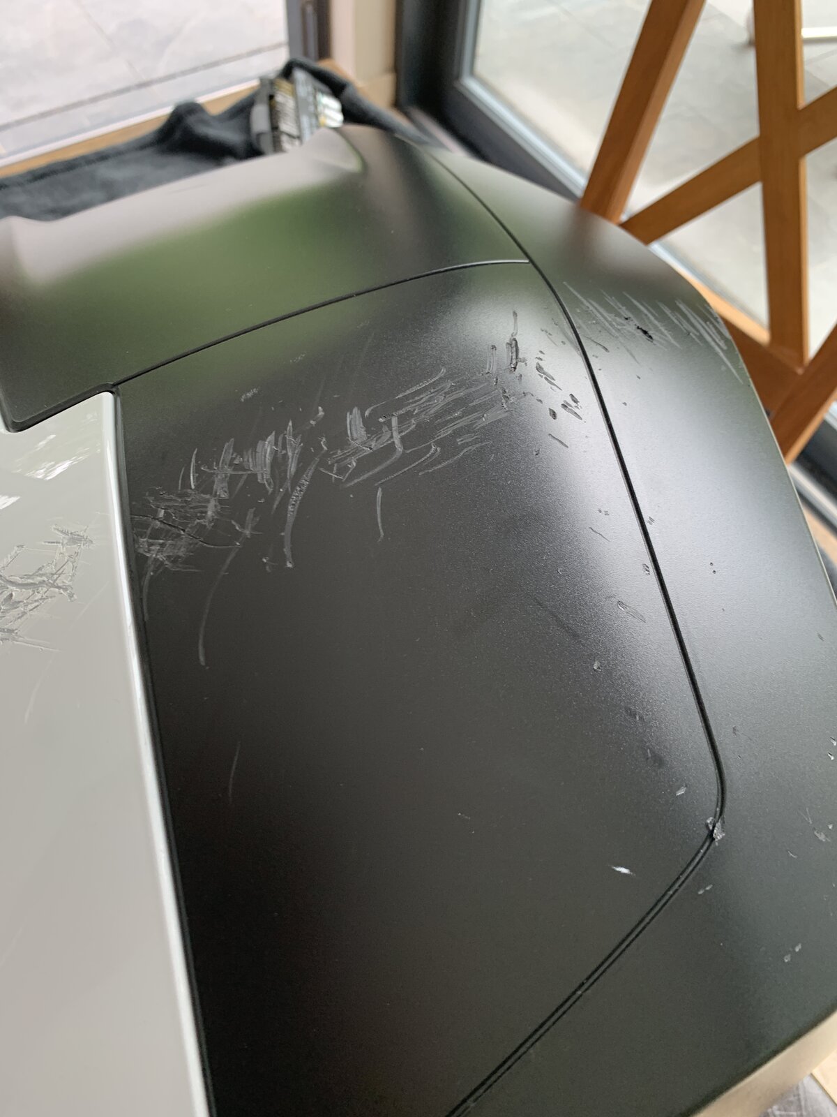

  1. I dropped the bike in France earlier in the year and it rolled over on the pannier. I'm guessing that I'll probably have to replace the lid and infilled panel (if I can buy this separately). But just on the off chance does anyone have any suggestions of how to repair this or at least make it look less grim?

  2. Use a modern body filler and then wrap the box. I believe infill panels are available individually through your dealer. Andy
  3. You can buy the covers (top and bottom), don't need the whole lid. Had the same problem myself.

  10. I've marked panniers after a topple over but nothing as bad as yours. I used wet and dry paper to get rid of the worst of the scratches. The problem is that the standard finish is matt and slightly rough, so filling and painting isn't going to work that well. I didn't attempt to fill the damage and used a wire brush to rough up the plastic to get a similar finish.
    I'd say you were going to need to replace the damaged parts.

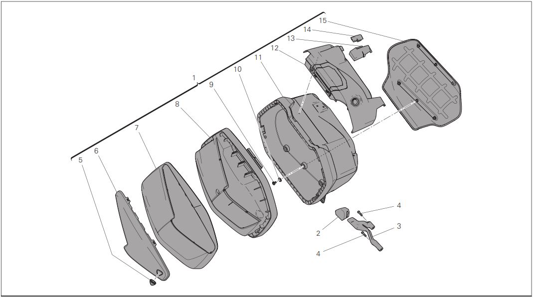

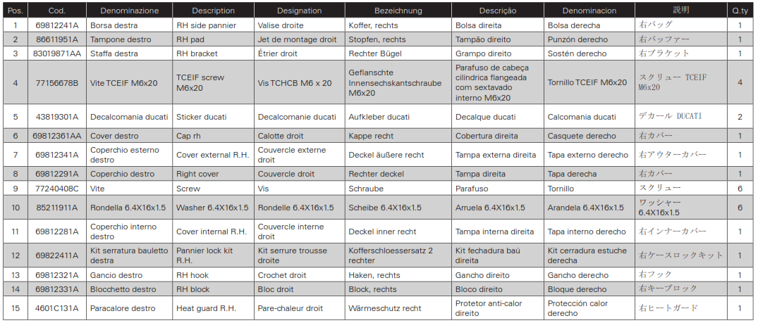

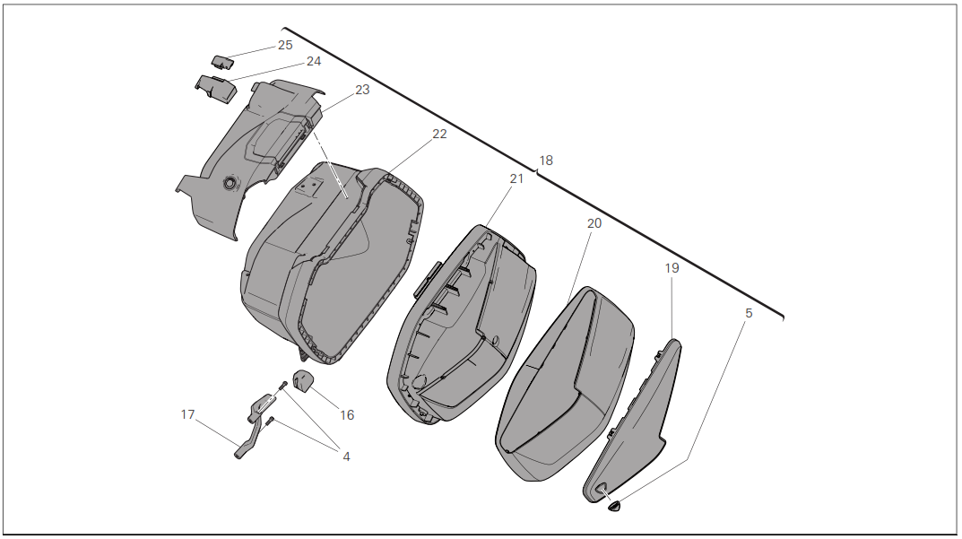

    The installation instructions for the OEM panniers include a parts list at the back:
    The black plastic lid covers are about 40 Euro from KFM Motorraede:
    I've now found these parts are cheaper on the Star Twin Motors website:
    • Item 7 Cover External R/H 69812341A Link to Web Page €37.99
    • Item 20 Cover External L/H 69812351A Link to Web Page €37.99
    A set of the painted covers (Iceberg White 96780671A ) are £122.46 on the Ducati UK Website
    The Star Twin Motors online parts list of the panniers (left / right) has different part numbers for the cover, depending on colour (the original installation instructions may just be for the silver painted covers which were shipped as standard on the early 2015 models).
    The KFM Motorraede and Star Twin Motors websites shows that painted covers are available separately:
    • Item 8 Cover External R/H 69812361BC €58,87 / €54.28
    • Item 21 Cover External L/H 69812371BC €58,87 / €54.28
    The Ducati Sticker [43819301A] is €12,99 / €11.98

  11. Just fill and flat the panniers and paint them both with some plastic paint. They'll both match then.
