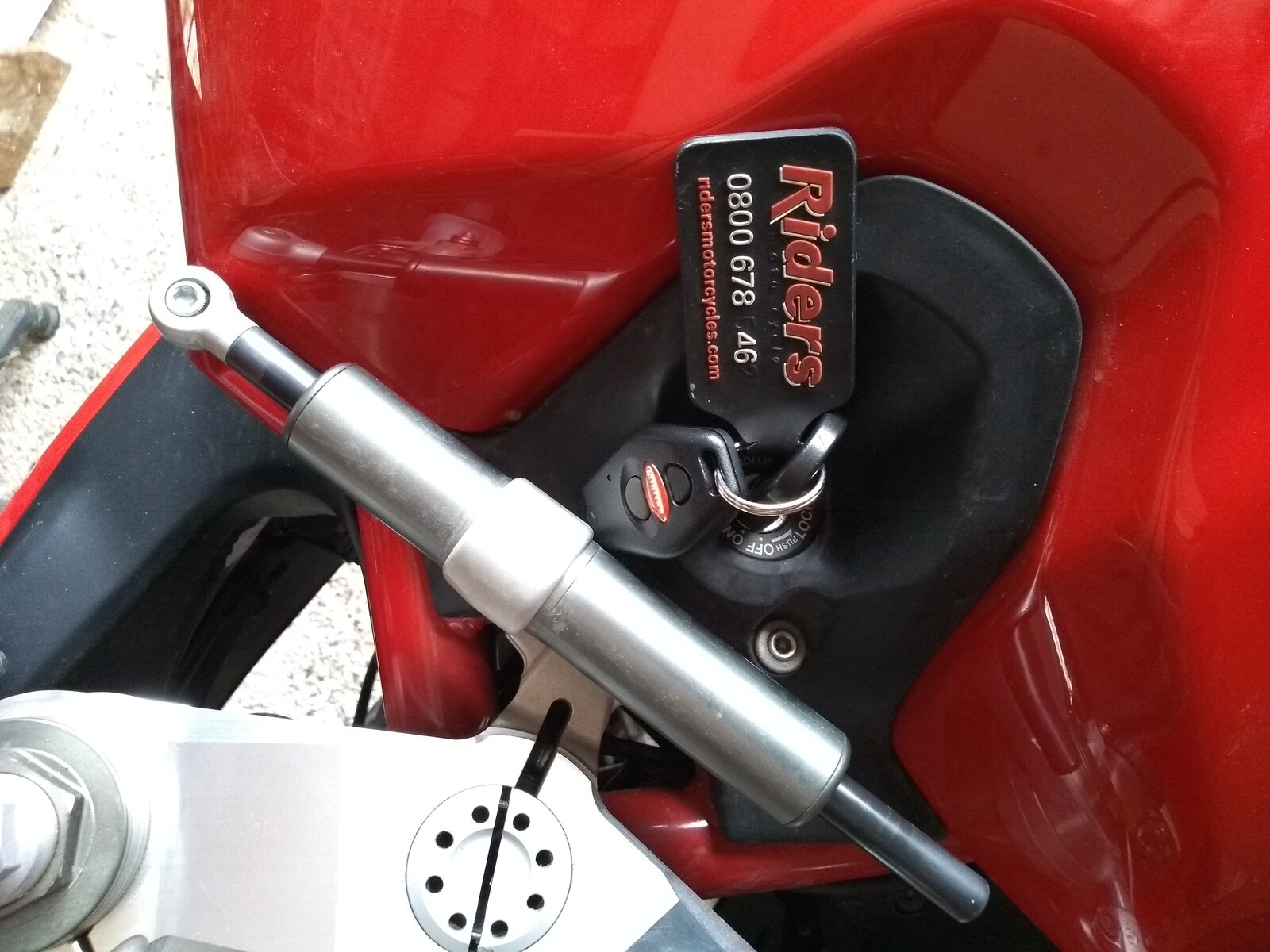

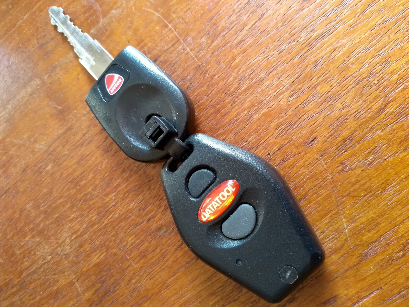

  1. My bike came with a datatool alarm and the fob was on the standard keyring, whilst moving the bike I noticed a slight 'stick' in the steering. On investigation the alarm fob had slipped between the tank and the steering damper and was getting crushed - not great - simple fix with a cable tie with the added advantage that it does not flap about in the breeze. IMG_20210501_183252130.jpg IMG_20210502_103549738.jpg

  4. I’d be tempted to put the fob on a lanyard with the possibility to unclip the ignition key to insert it for use… those things tend to rattle about at speed.

    Never again.

  9. If you must keep the alarm, put the fob on a long lanyard around your neck and take it off the key ring.
