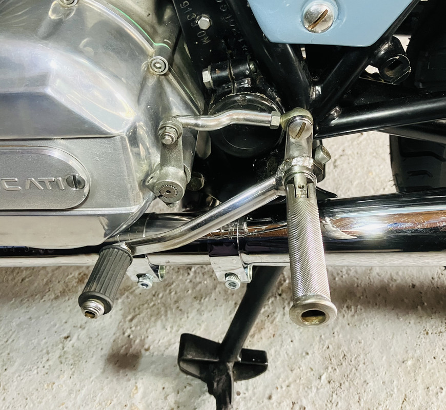

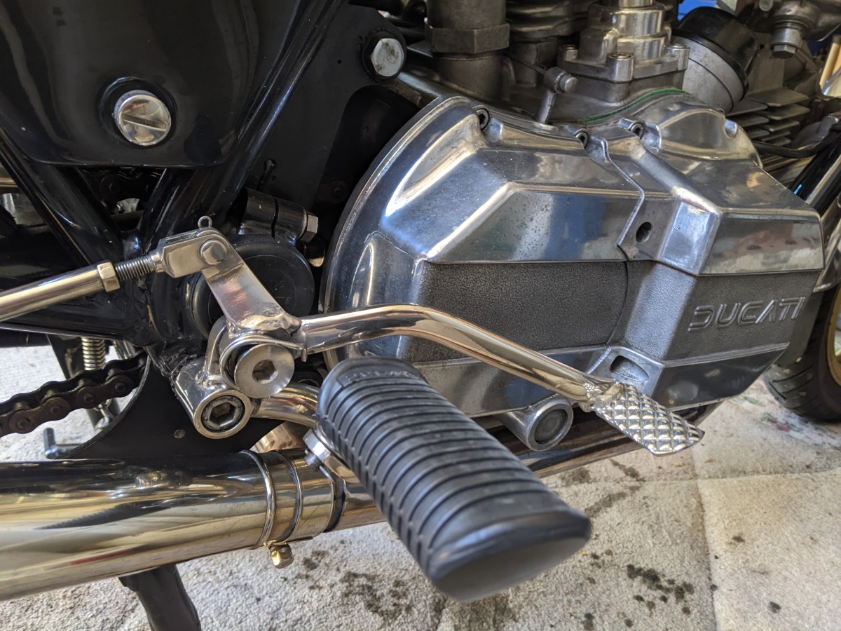

Is there any chance someone could provide some detailed pictures of the footpegs, gear and brake levers of a Darmah SD. I am trying to make a set for my SSD so that I can enjoy it before the end of the summer. I can't bend my knees enough yet to ride with the standard SSD pegs.

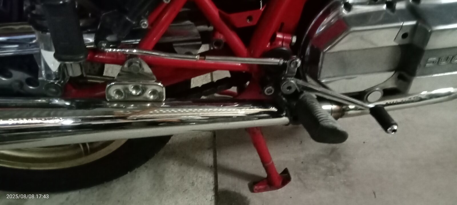

Hello Paul, What year is your SSD? Has it got the early foot pegs system or is it the later one with lowered pegs already? Mine is from 1980 with the lowered pegs system.

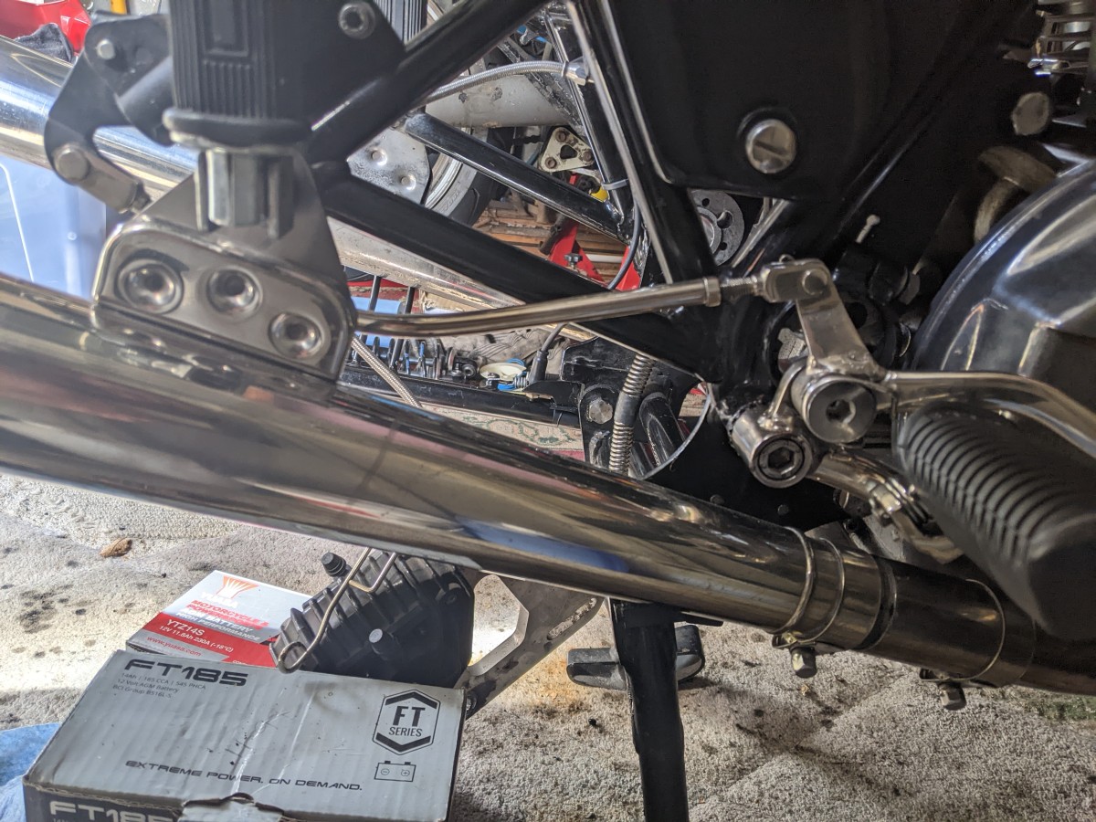

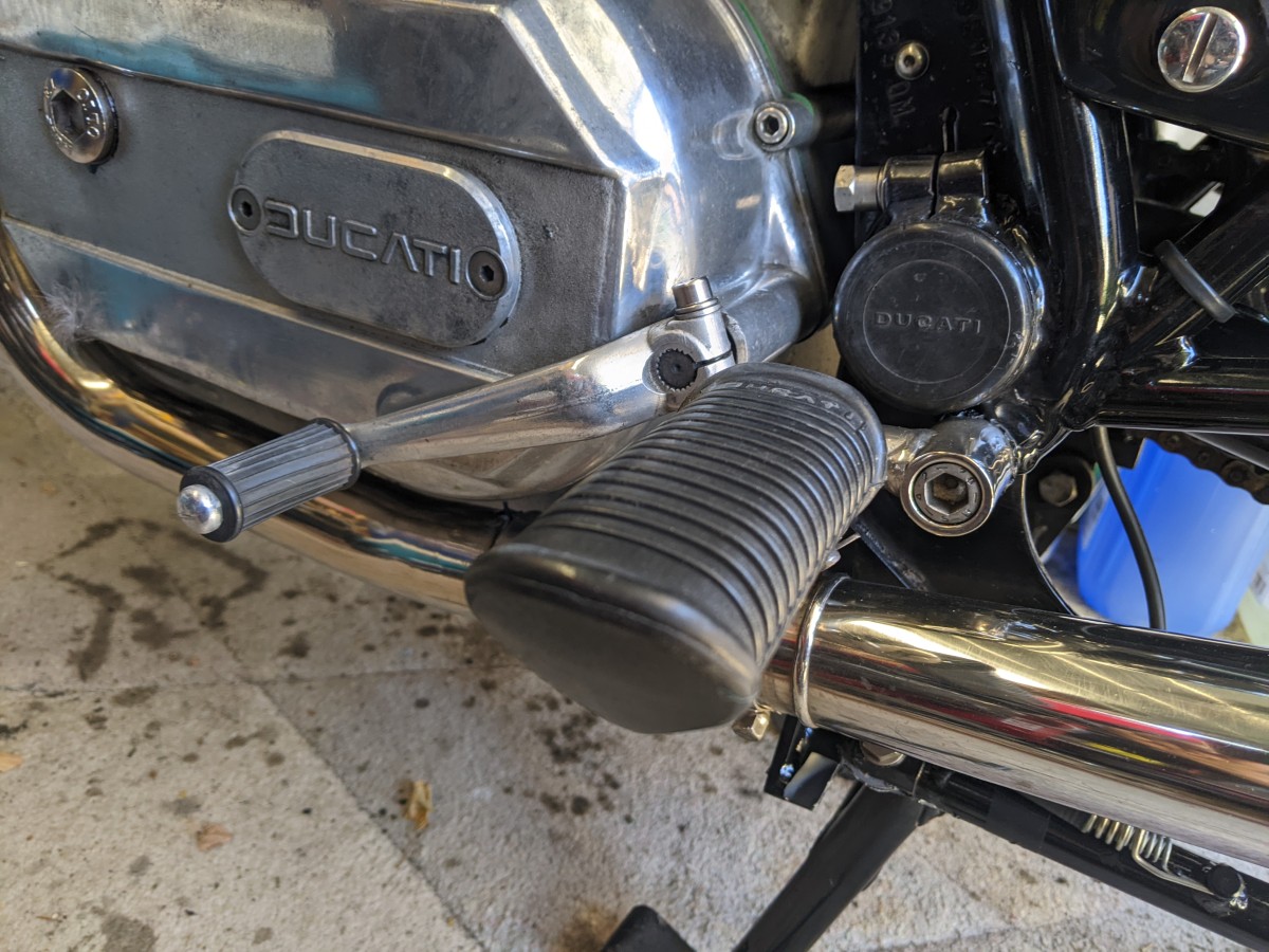

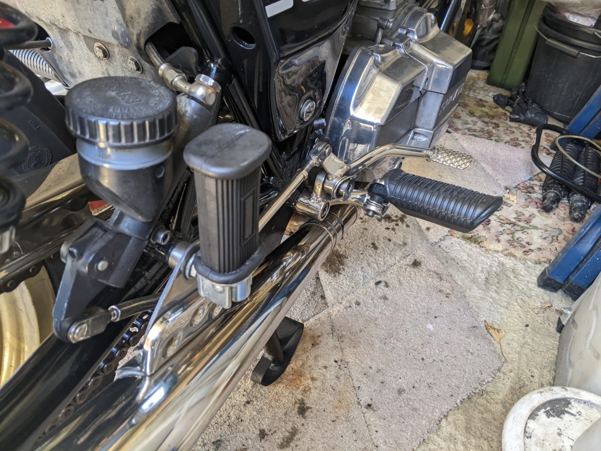

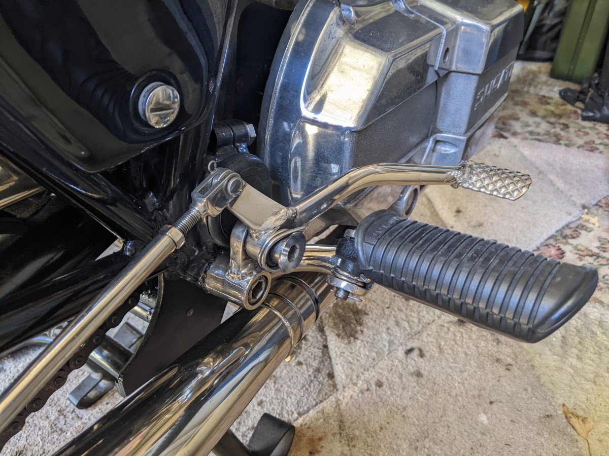

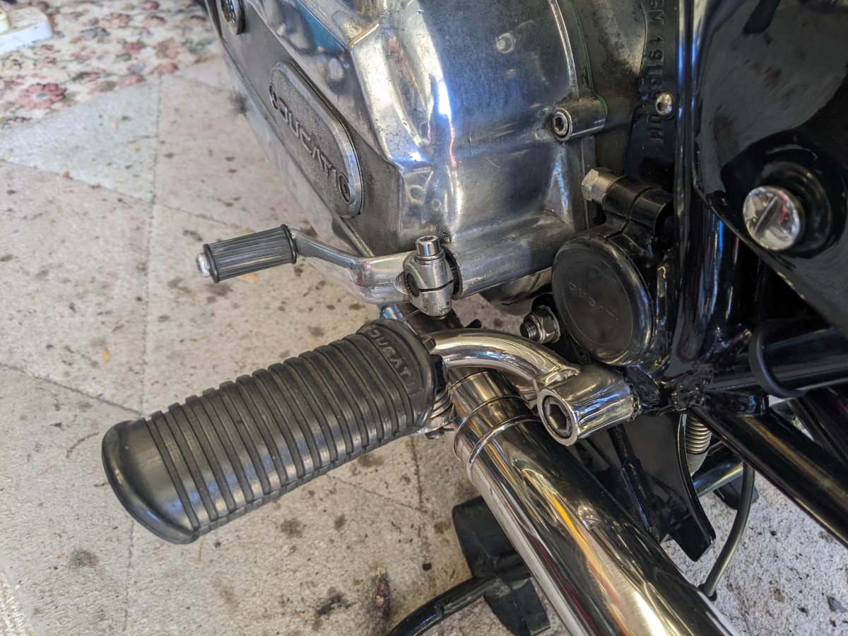

Back to Classics do both the SD rhs & lhs footrest assemblies with 'delivery time'. You'll have to contact them to see exactly what delivery time is and what the assemblies consist off. See https://www.ducaticlassics.com/parts/900-sd-and-ssd-darmah/all/stand-and-sd-foot-rests And here are the photos of my SD footrests:
Guillaume Thank you. I think yours are the later style, only because my original bike, which was a 79 model had the same set up as my new one. Love the rebuild that you have done on yours. The way you have documented everything with input from others on the forum is incredibly useful.
Andy Thanks for the pictures. I think this is what I am trying to achieve because it will mean I have to bend my knees less than with Guillaume's set up. I think I can make the footrests fairly easily but it's all the linkages that are the issue. Being able to see your brake lever set up is very helpful.

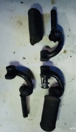

@PaulVN Someone over here (France) has some SD foot pegs listed. He’s asking 40€ a piece, with what looks like worn rubbers that may need replacing. https://www.leboncoin.fr/ad/equipement_moto/2895943103 Would you be interested? If so, I can contact him, purchase them for you and then send them your way. Just let me know. He is also listing SD brake pedals. https://www.leboncoin.fr/ad/equipement_moto/2895954382
Guillaume yes please on the footrests. Let me know the total cost including postage and I will set up a bank transfer, if that suits you. I will pm my address.
