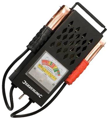

  3. To answer the Duff battery question.
    What is the battery voltage before you start the bike and what is it when running?
    It should be as close to 12V as possible, upto 12.8V for a fresh YUASA YT7B-BS battery.
    If it in low 11's then possibly undercharged or damaged / worn.
    You really need one of these machines to test a batteries capacity to start a bike.
    The example below is about £15 from Ebay or Amazon.

  8. That little gadget I mentioned is great for checking all vehicle batteries... it allows you to check the useful capacity, much more important than volts.
    Note even a furbar battery has over 3/4 of the chemical energy of a fully charged one, so be careful how you dispose of it.
