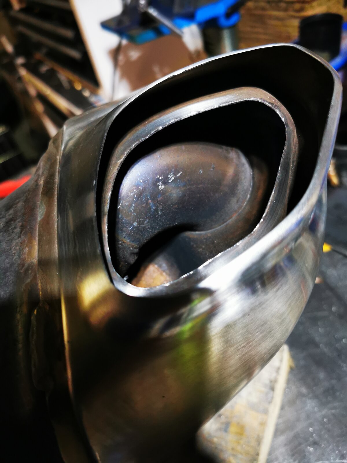

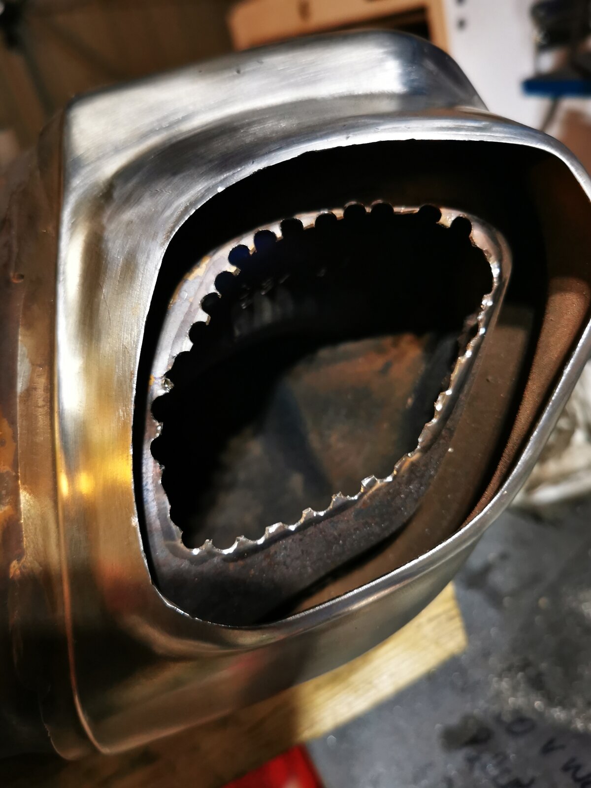

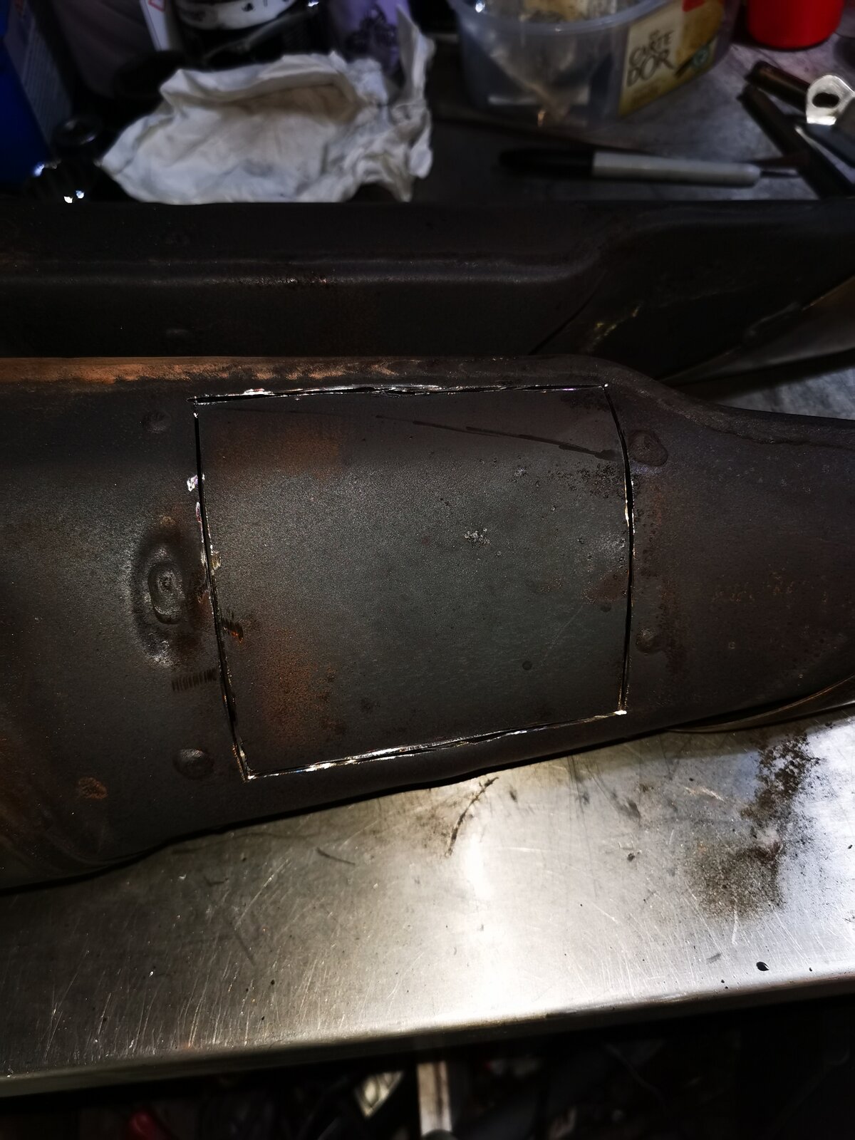

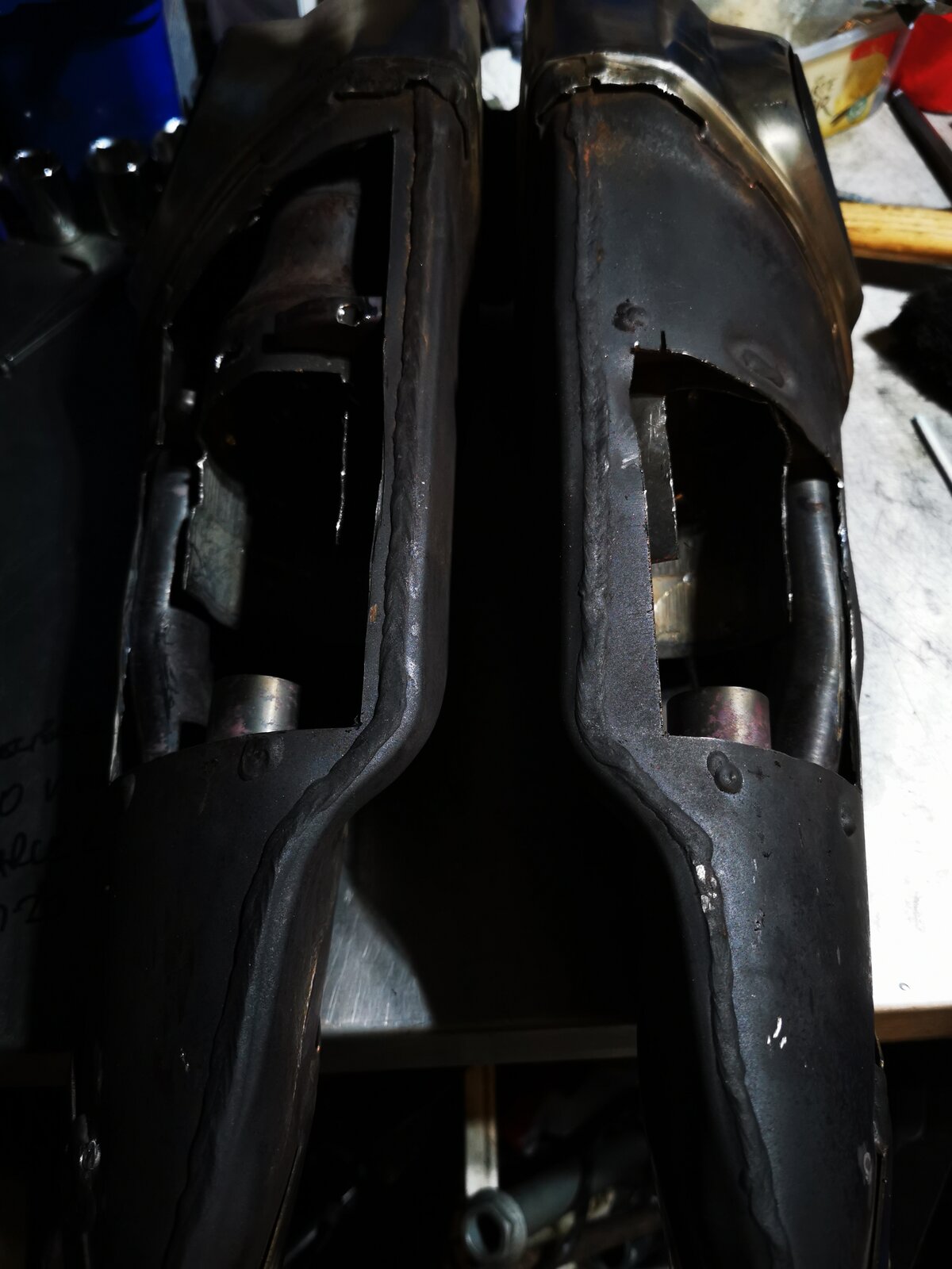

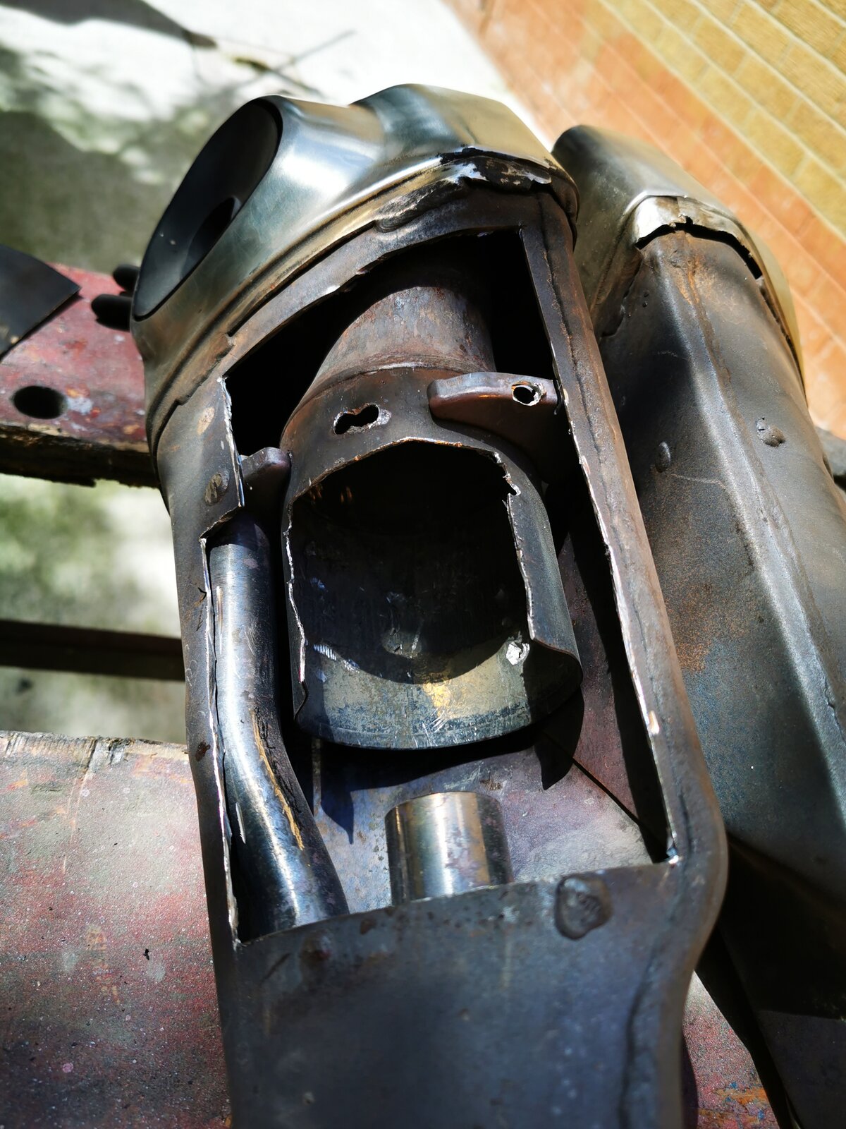

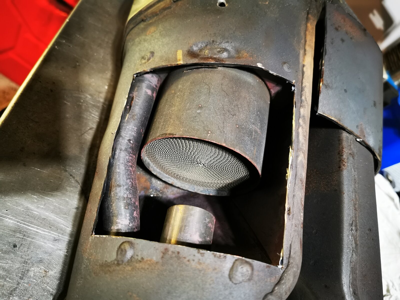

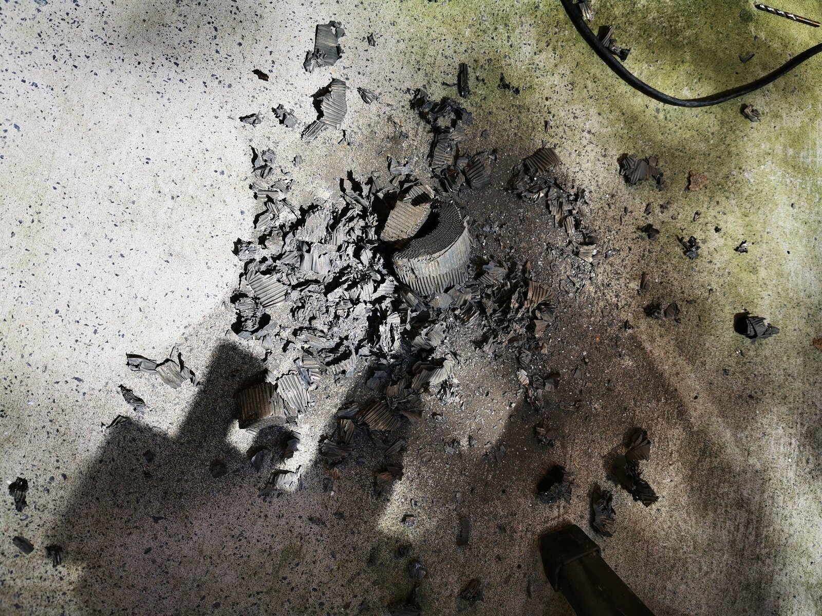

  1. Exhaust arrived today only £55 and started the the de-cat process horrible job, the cat is like a mass tight roll of corregated thin alloy and fusion welded by the carbon deposits anyway got them out, will weld it back up soon with pics as for the exits I'll be removing the inner pipe and will tac some SS mesh on the inside for a factory look, then give it some coats of heat resistant satin black paint and refurb/polish the all the outer parts job done :upyeah: IMG_20200706_131901.jpg IMG_20200706_155042.jpg IMG_20200706_131908.jpg IMG_20200706_113800.jpg IMG_20200706_131901.jpg IMG_20200706_113736.jpg

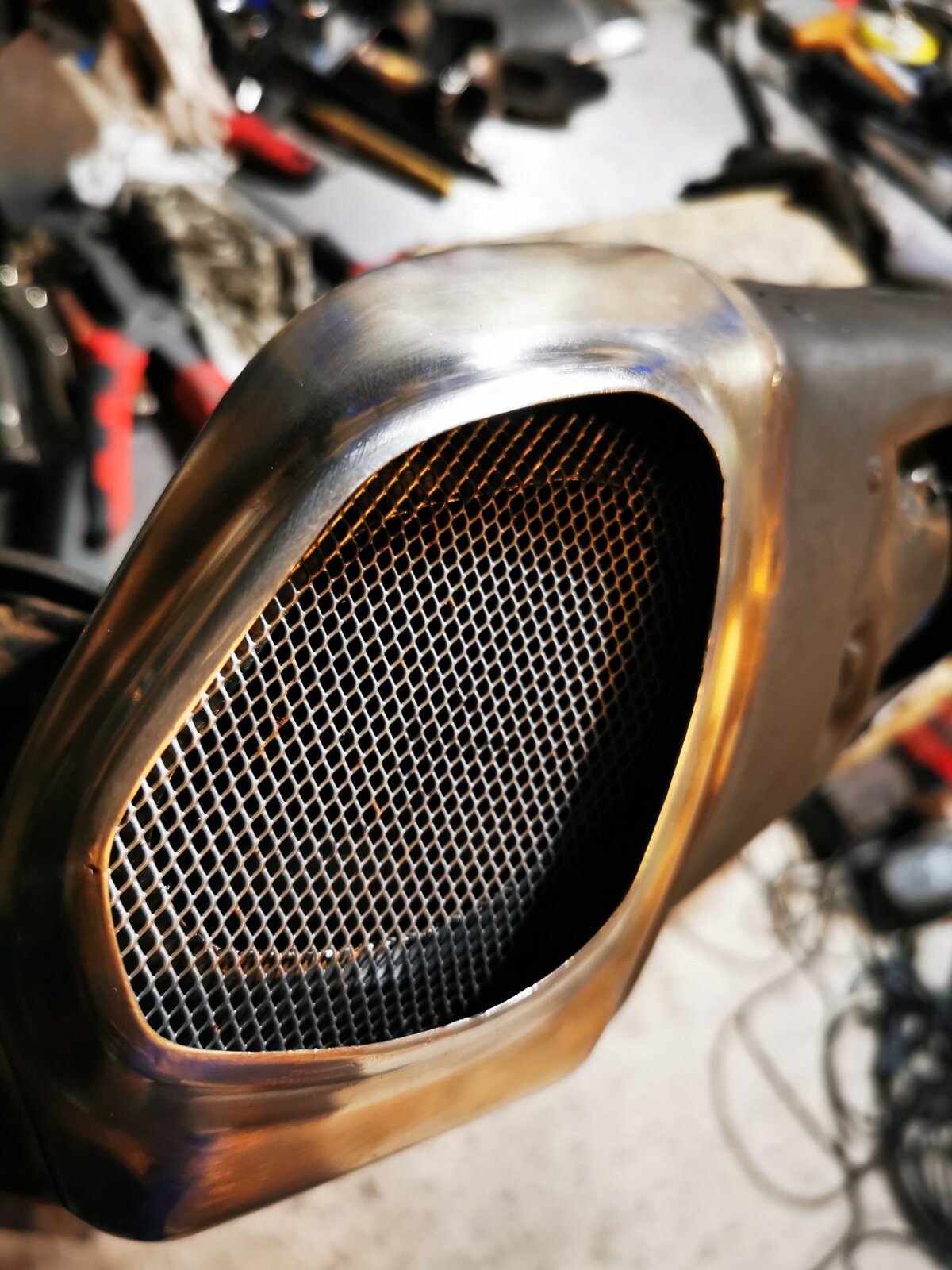

  2. Bit more work done today see pics, coming along nicely won't be using this mesh got some stainless on order :p
  3. Did similar to my old Zx12r, just be cautious when you start it for the first time, no matter how well you clean the inside out, you will get some s&*%e forced out the end. Thats gonna sound meaty.
