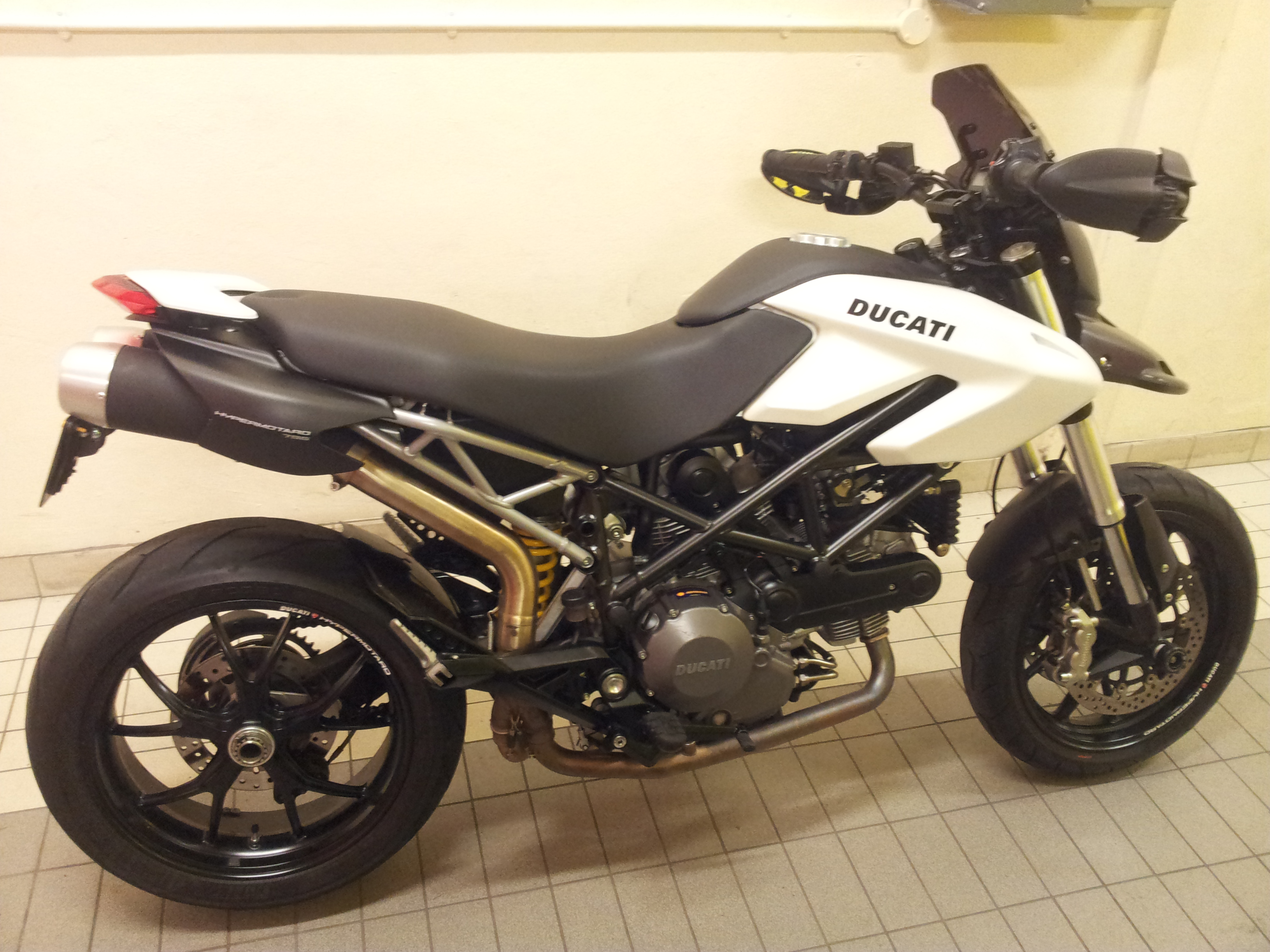

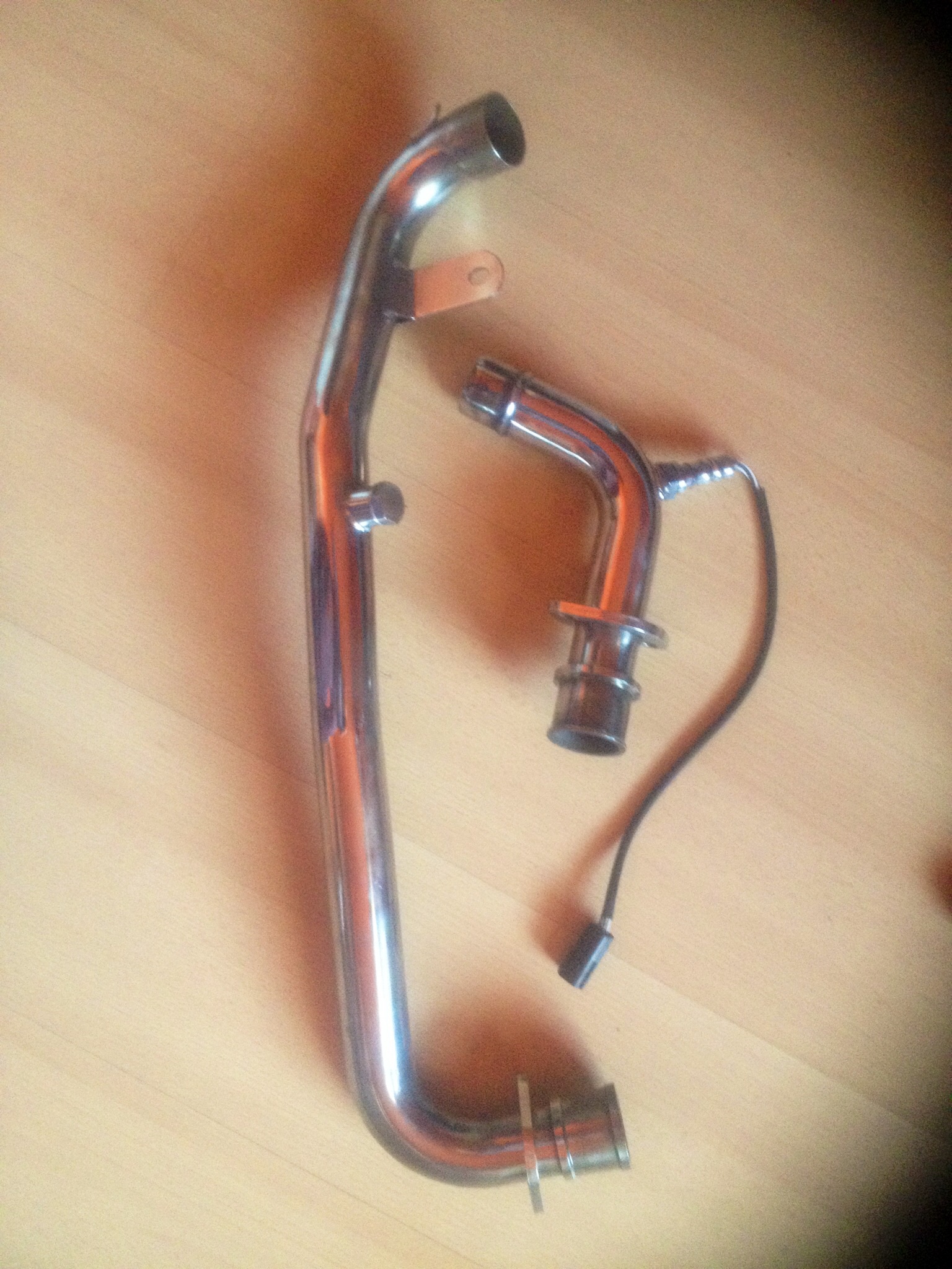

  20. ok, so i spent much of the afternoon today fitting the leo vince decay pipe.
    Was fairly straightforward to fit and used the oxygen sensor clips.
    I have attached a couple of pictures below.
