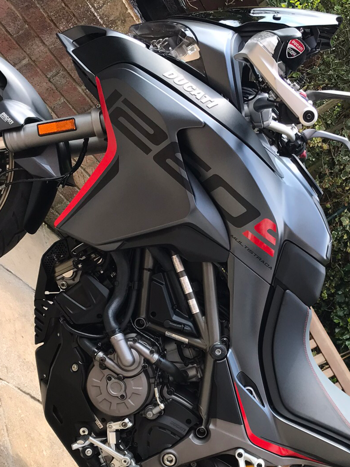

  4. I left mine in place. Its easier to match the decals to each other that way. They are straight BTW - the angle of this shot looks to be distorting things a bit (honest lol)
  5. Looks very nice!

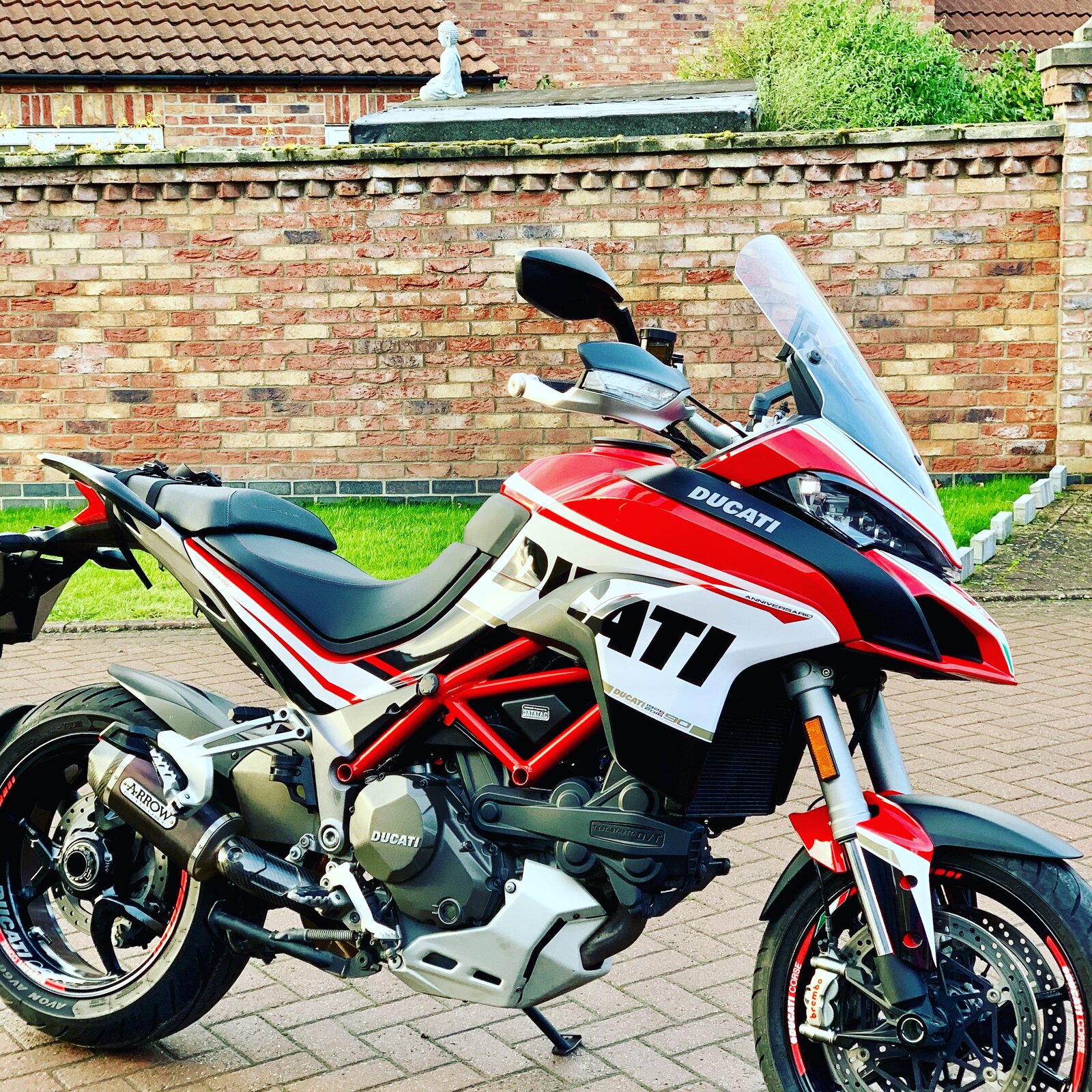

  19. I paid £60 to have mine fitted by a local company. She said that some of them were tricky. Mine were from Italy and cost around £160. E7B6DF46-F0B5-487A-8351-7C9ED1CBC441.jpg
