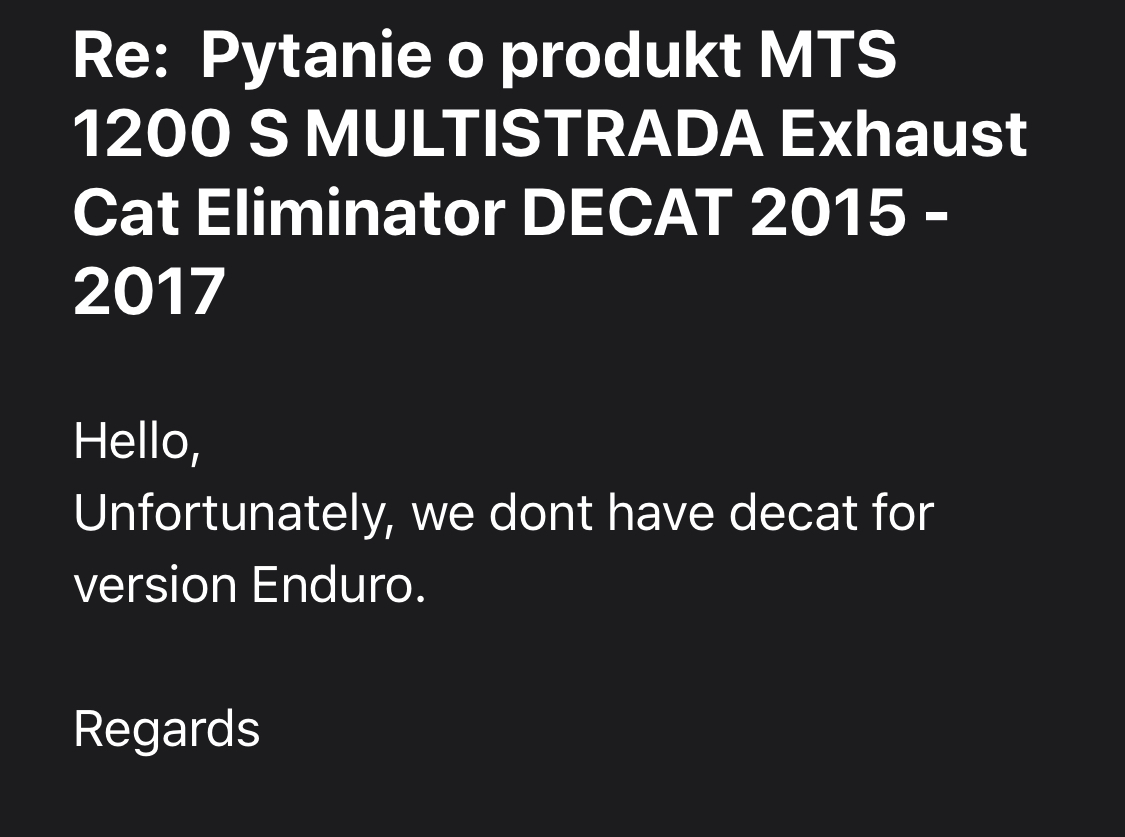

  9. I'd be interested in whether this fits the Enduro too - looks like a nice quality part, and a nicer design than the Delkevic. Would of course require an additional silencer of course, unless you like noise!
  10. Just had a very prompt message back from the manufacturer, and unfortunately they don't do a version for the Enduro. I don't know if the outlet is in a different position perhaps. Pity!
  11. Won’t fit the in the Enduro.
