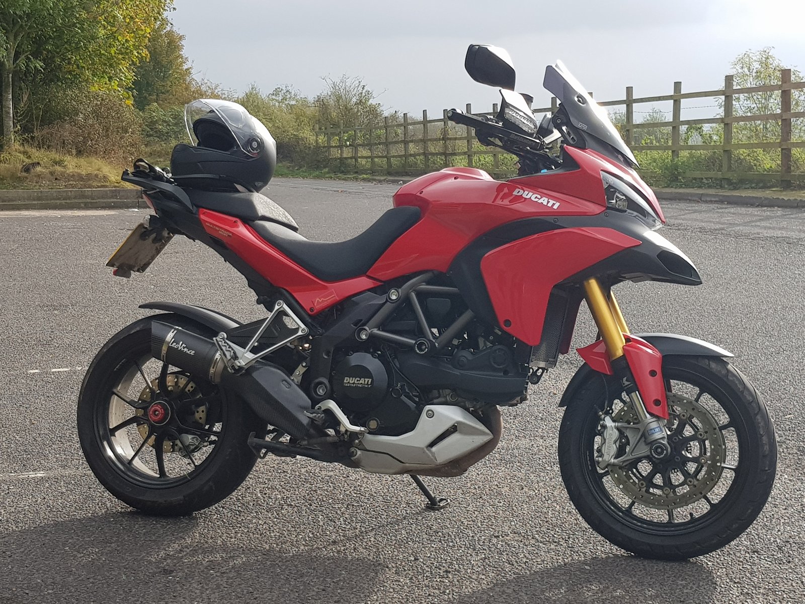

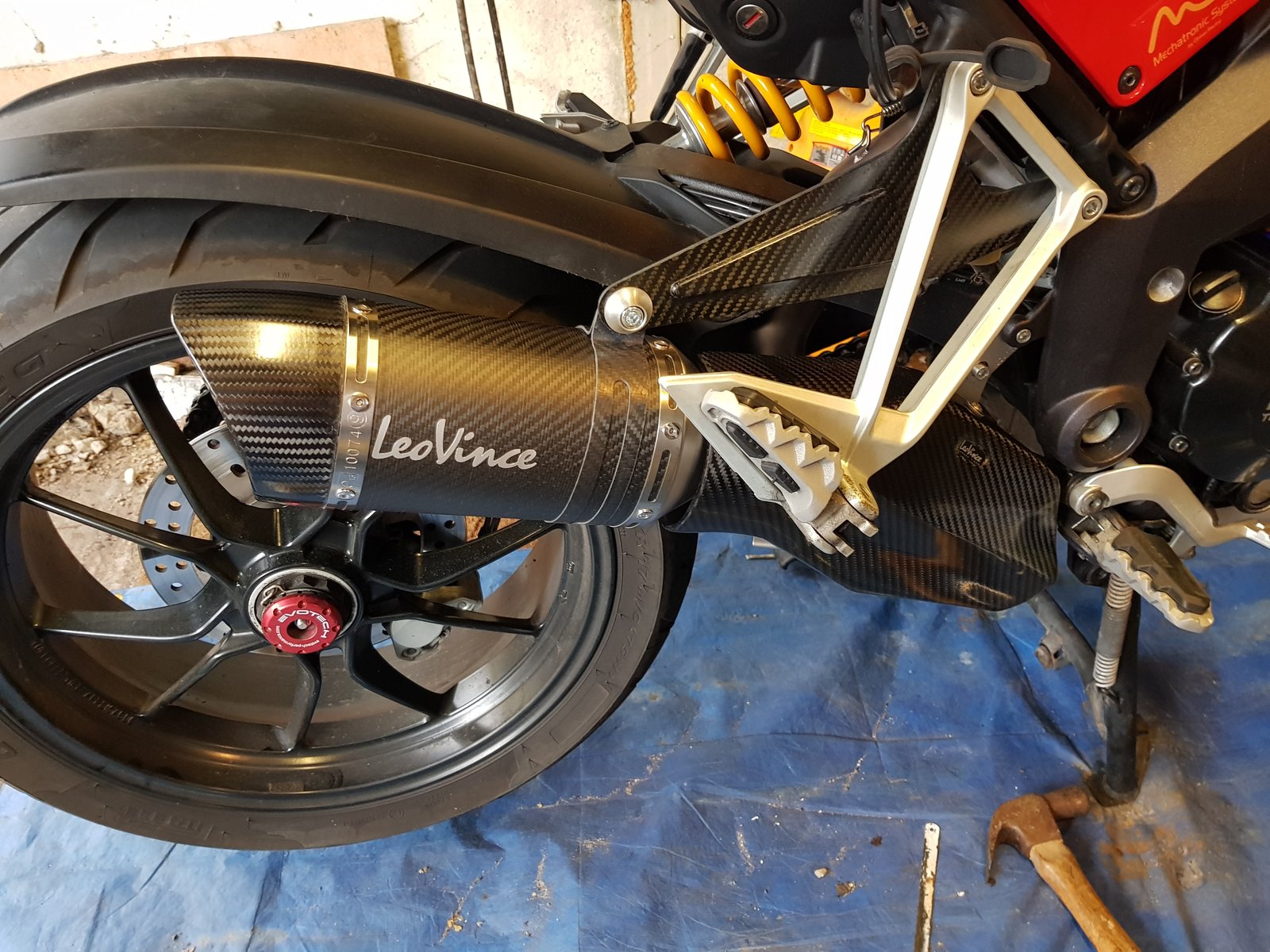

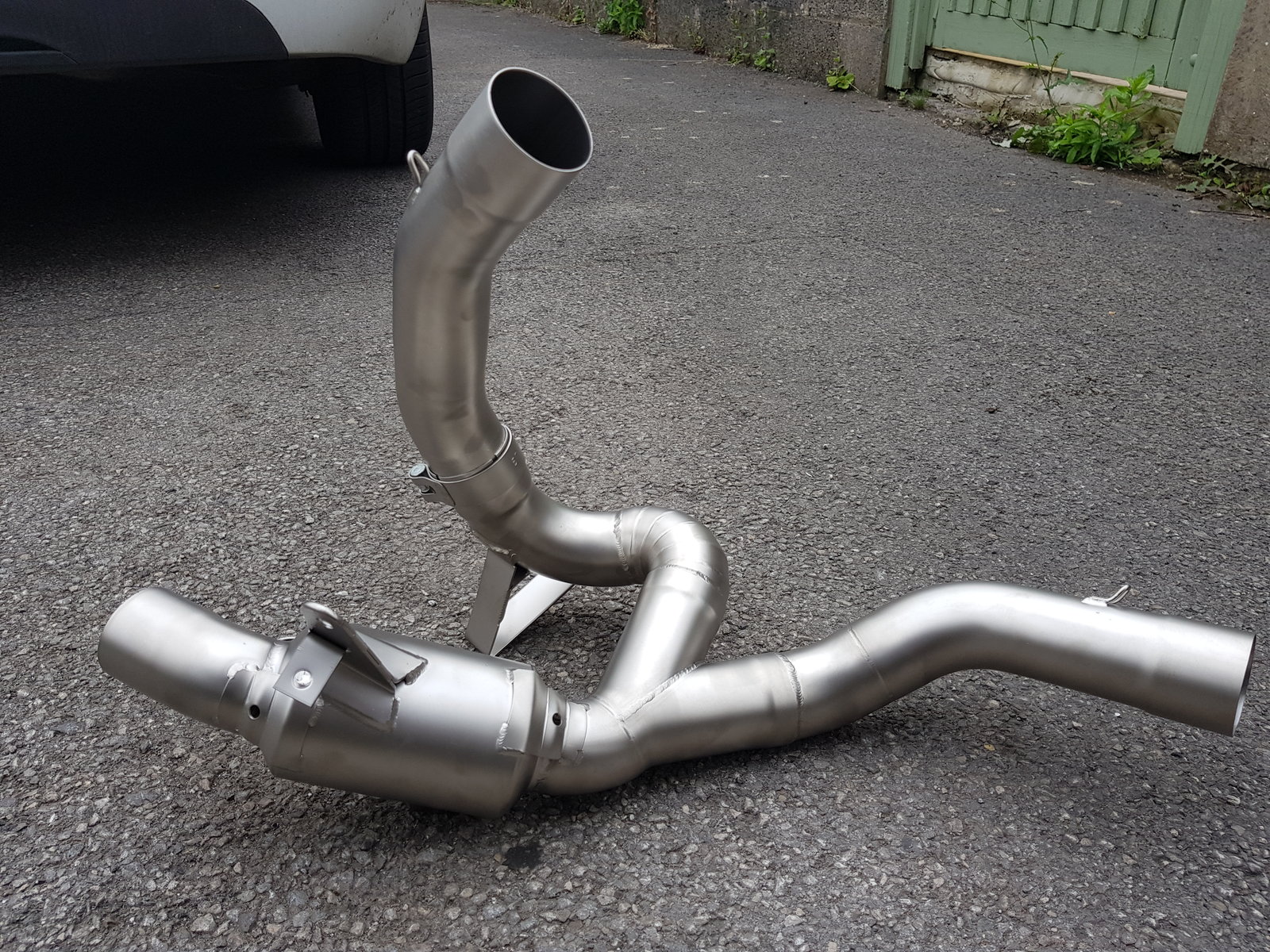

  7. The decat pipe has a small baffle built in that reduces noise a little but it does need a silencer also to make it 'bearable ' Having said that I always ride with ear plugs as my hearing has been damaged by loud music and bikes anyway, so for me with the plugs in noise is not a problem and my neighbours seem to like the sound as well.
    I can't fault the quality of the pipe or silencer , everything slotted together perfectly and the finish is really good. I will get a tune up done as the bike is thirstier now, although it runs a lot smoother and it will run a gear higher between 2 and 3000 rpm as is .
    For the first ten minutes or so the engine does pop and bang a little but improves a lot when fully warmed up , it will spit flames from the exhaust if you give it some welly !!
    In conclusion , in my opinion , the engine now feels like it's running how it was made to, it's smother , picks up quicker and 'feels' much happier.

  9. It is road legal with the baffle in for the MOT.. I fitted a plug in exhaust valve eliminator which takes care of the ECU and taped up the cable out of the way.
    I will have to check out the clearance for the pannier and get back to you tomorrow. I do have them but don't use them so not a problem for me.
    Both items were ordered from Leo Vince's uk web site and the cost was around £780 and delivery was within a couple of days.

  11. The exhaust valve eliminator plugs in to the loom instead of the solenoid that works the exhaust valve and 'cons' the engine management ECU into thinking the valve is working normally so that you don't get any error messages. I cannot remember which one I bought but if you google one for the multistrada it will give you options.( They are quite common across a whole range of bikes). They are just plug and play , my valve was rusted out and sticking producing error messages so it's worth doing even if you don't change exhausts.
    As to clearance for fitting the pannier to that side , I have tried mine and it is not an option ..:confused: The Leo Vince end can is too fat for the cut-out on the pannier and longer. With the tail tidy I fitted the indicators get in the way also. A short end can may give you clearance on the Leo Vince decat pipe,or from memory their are exhaust options which are designed to give you clearance so all is not lost.
