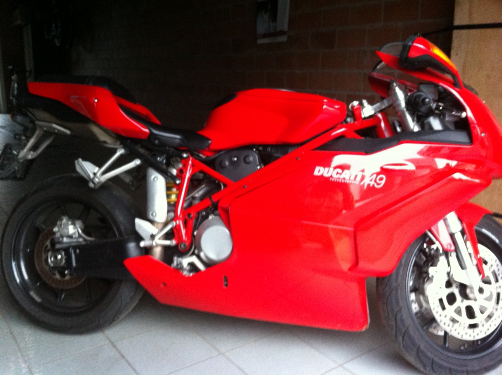

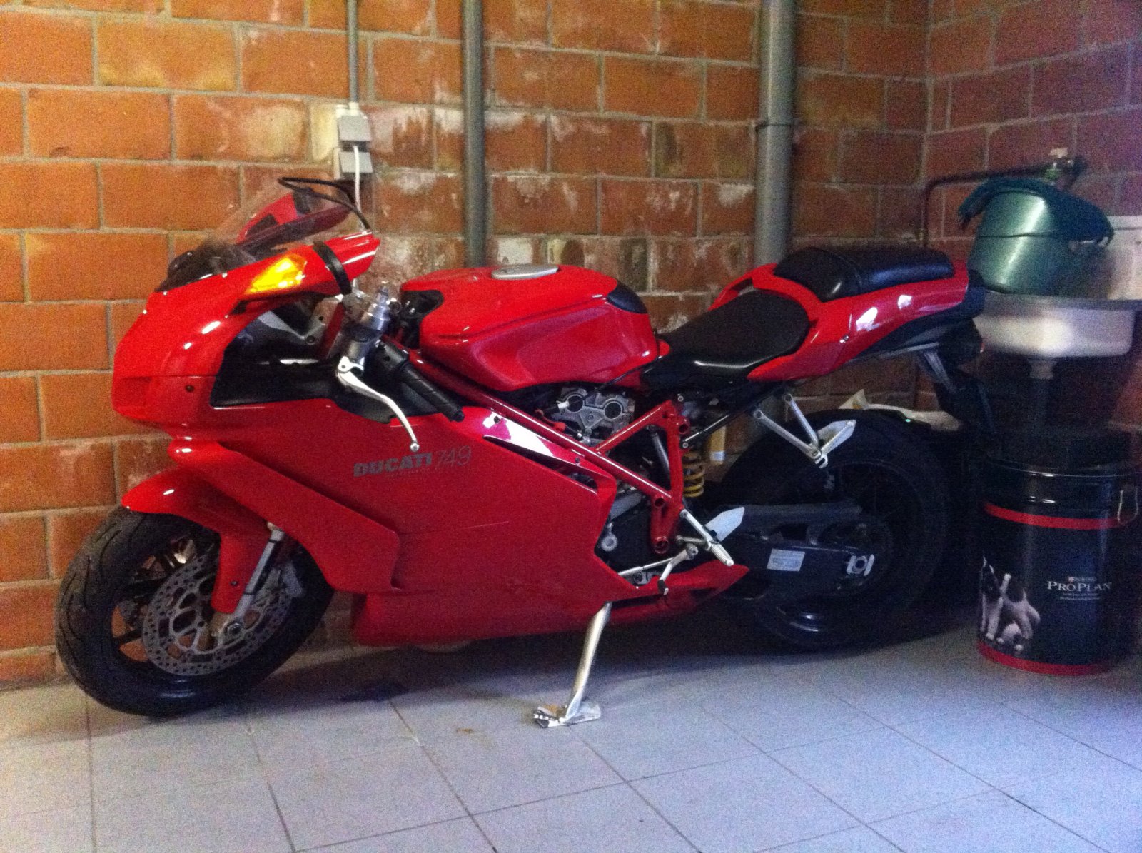

  1. I'm a little bit confused. I was looking to get a termi system for my 749. Think it is an 06 model cause the dude i bought it from got it permitted for road use mid 06.
    I was wondering if this is a Deep or shallow sump model. Apprently this matters when choosing the right termi system (as does the swingarm).
    Any help would be appreciated!
  2. There are people much better qualified than me to tell you but Black swingarm plus red frame equals deep sump I'd say.
  3. 749 models all had shallow sump, except for the 749R (all years).

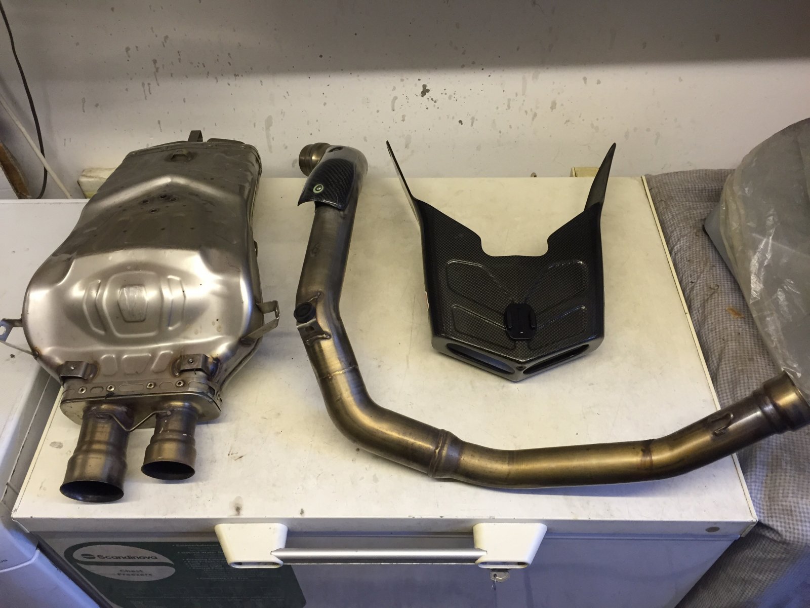

  4. Will this fit my bike then?
  5. Not the same as the 999 then...
