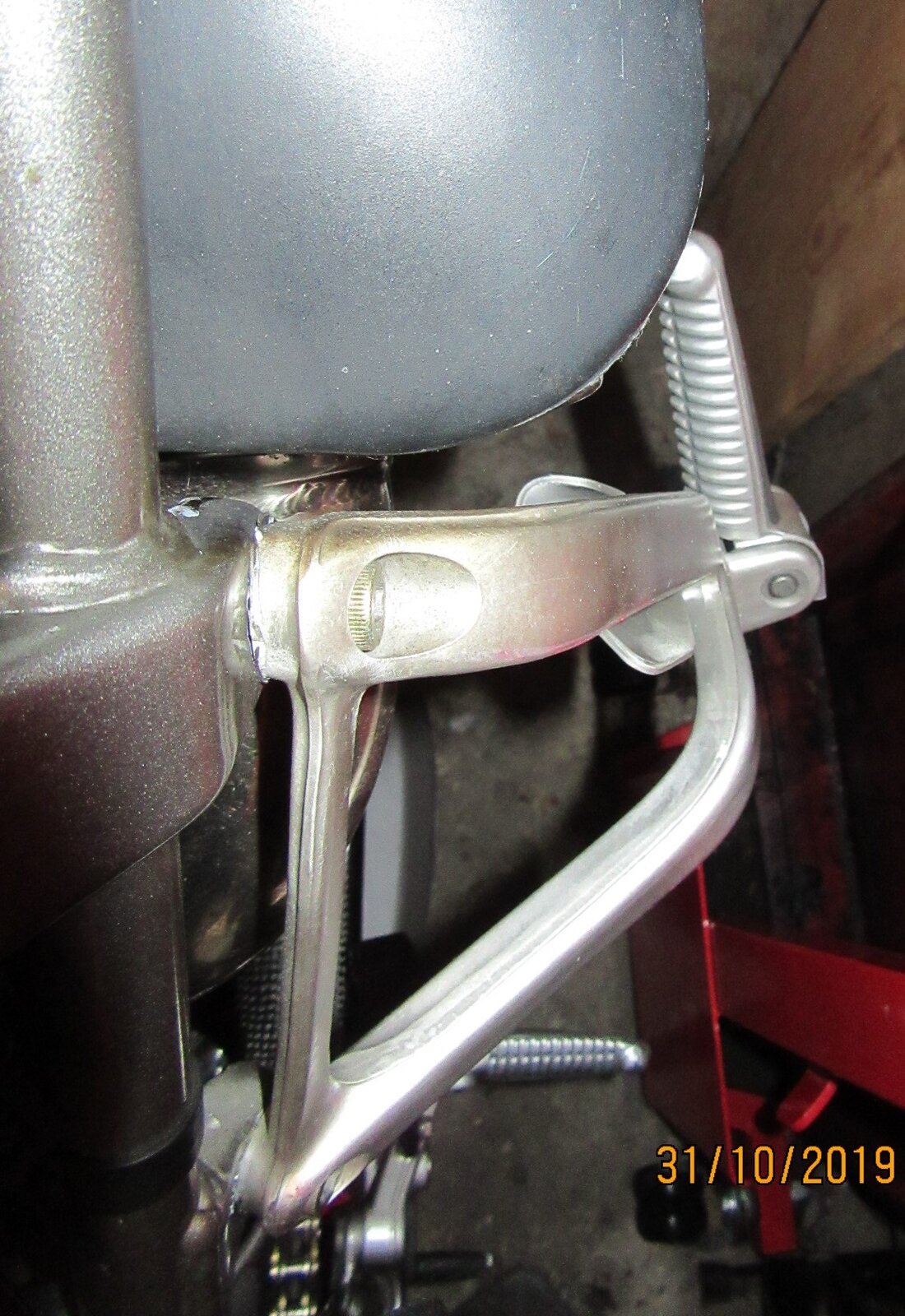

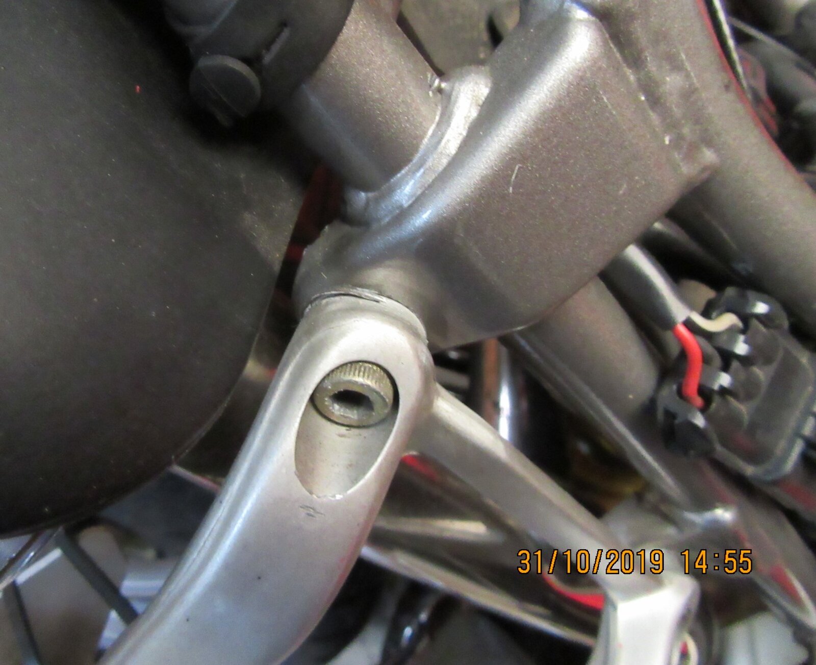

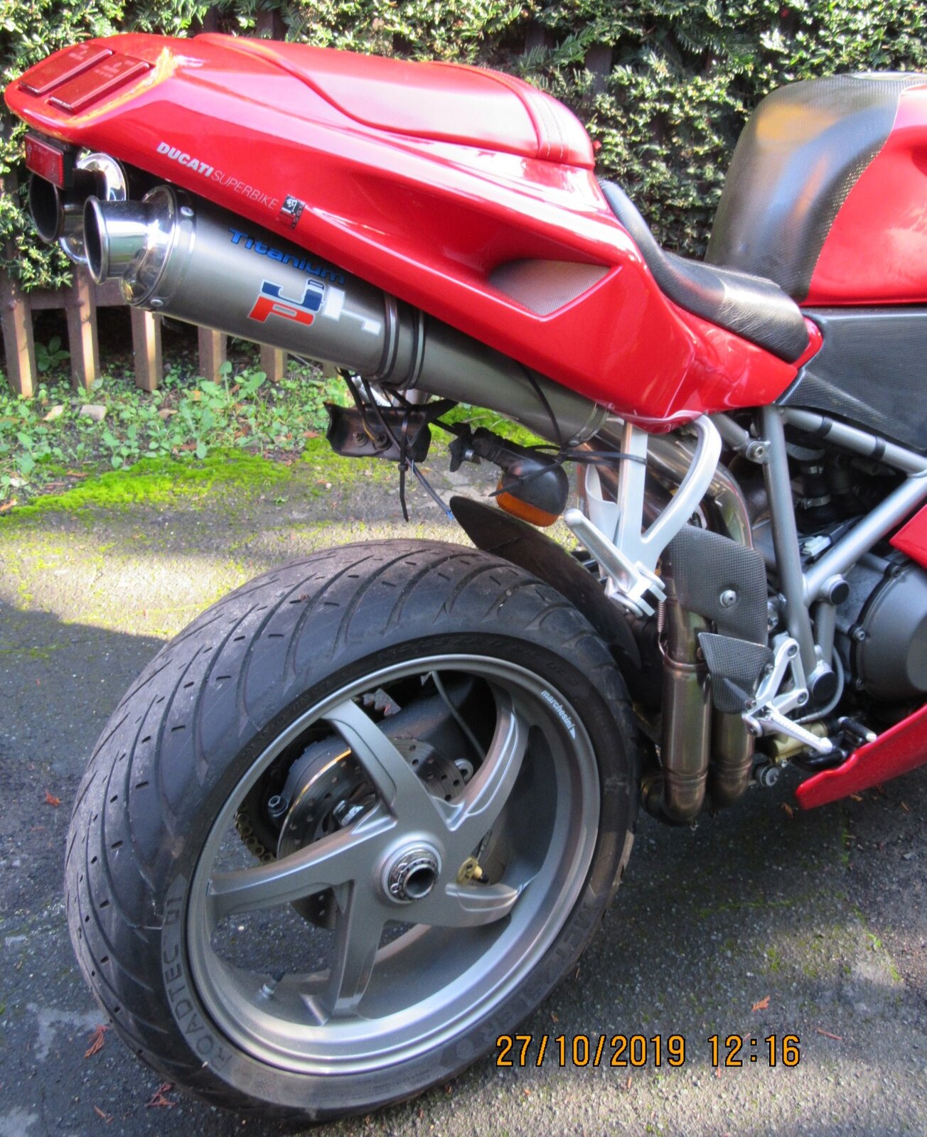

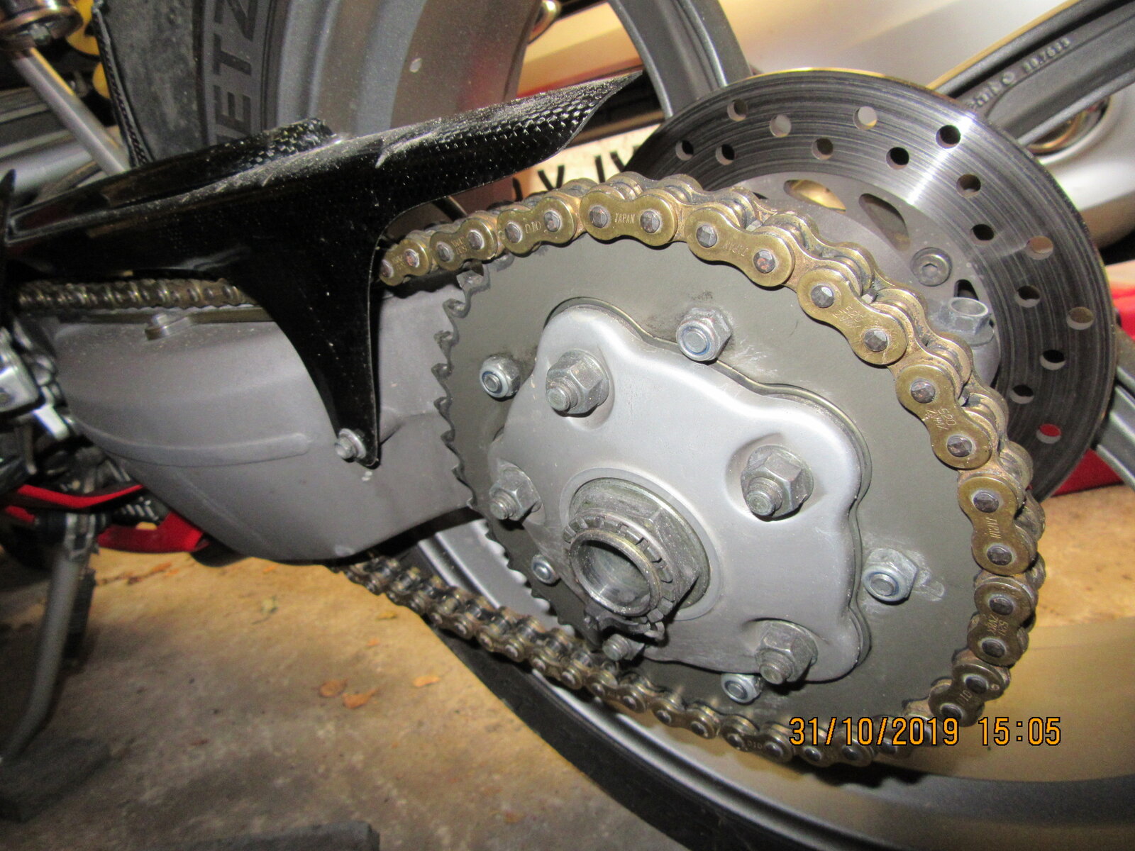

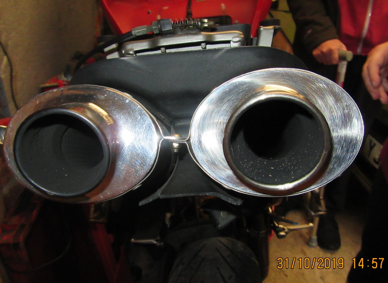

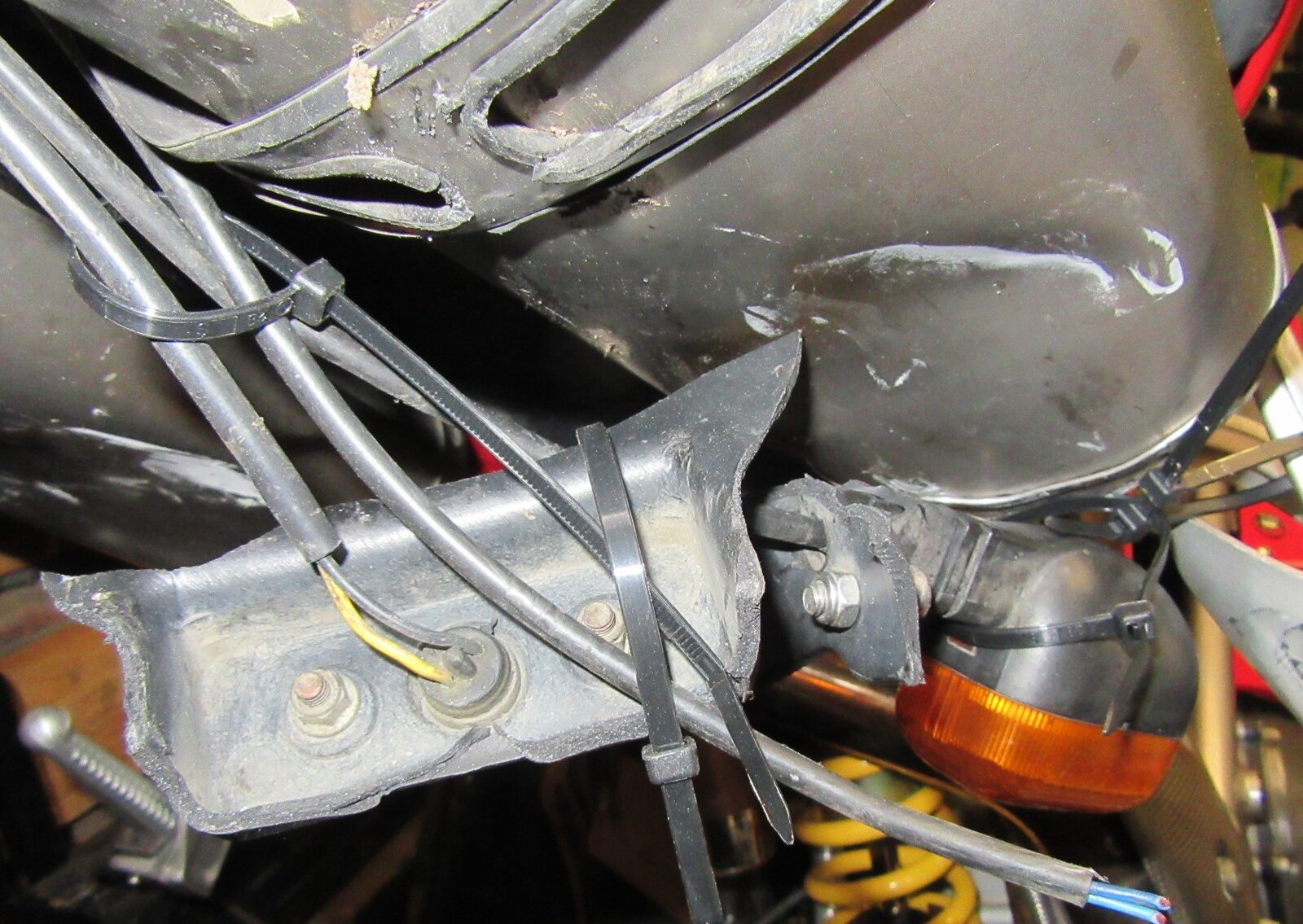

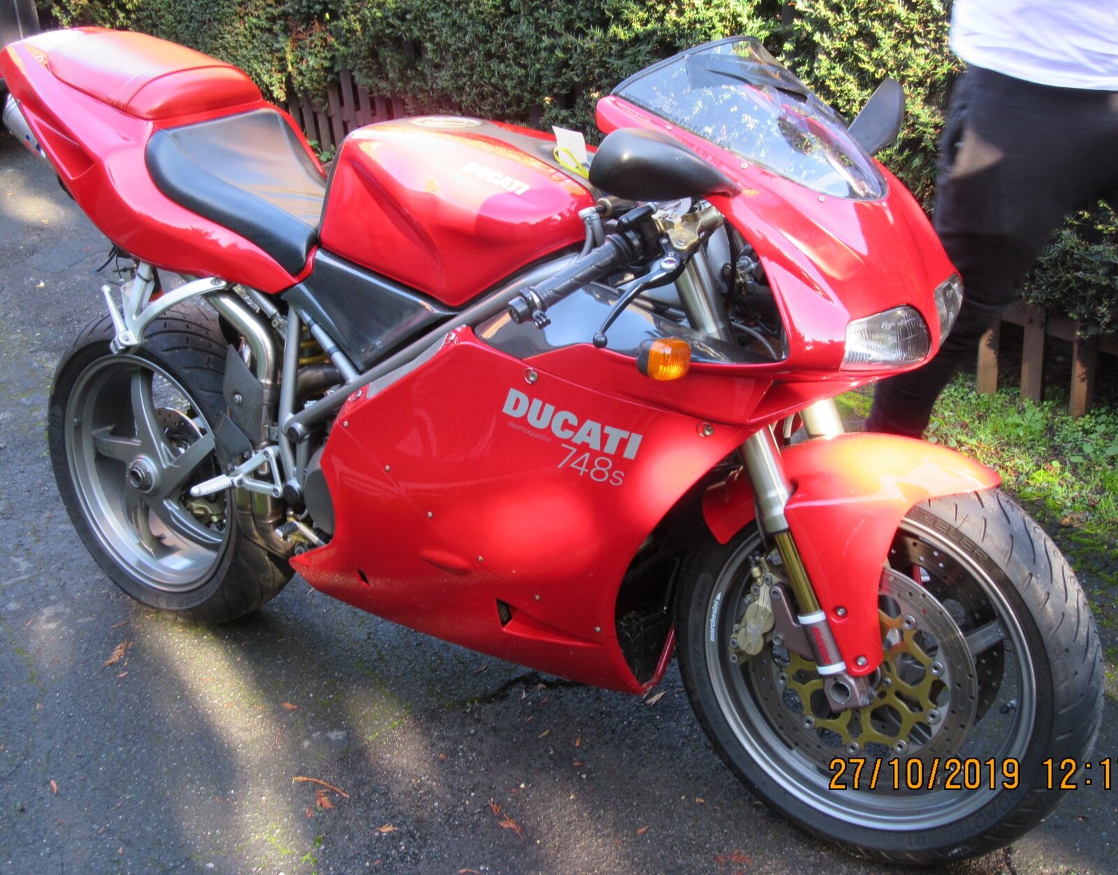

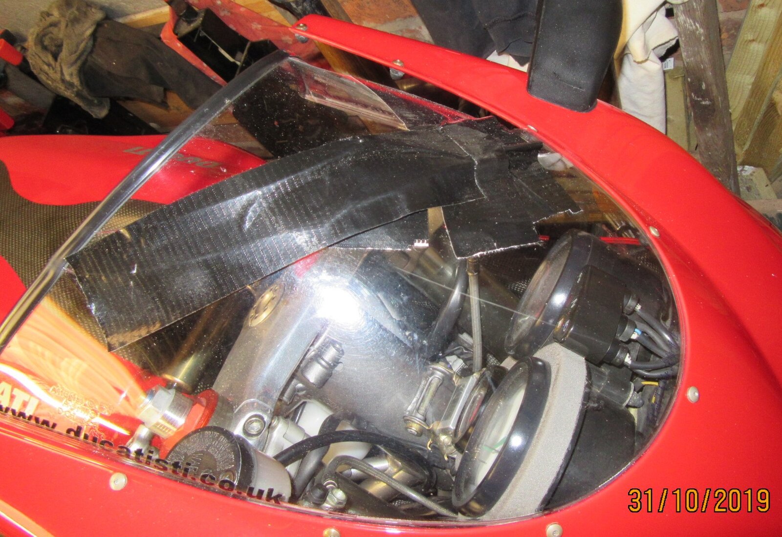

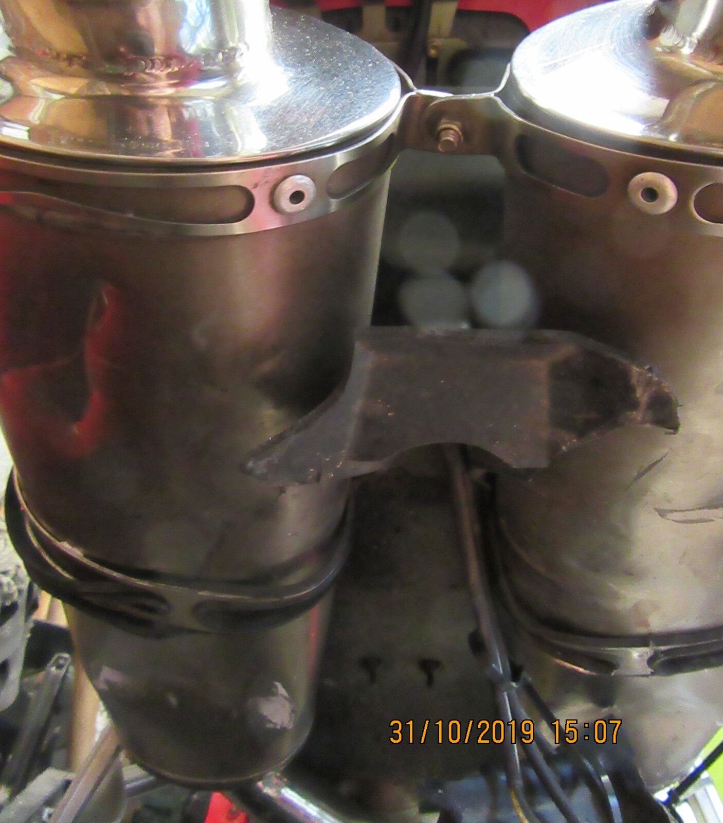

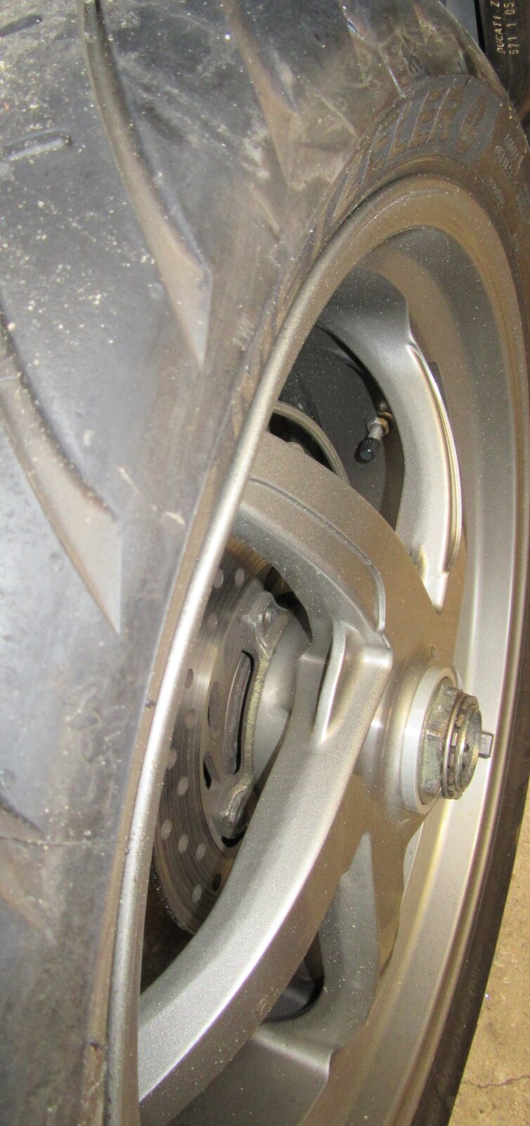

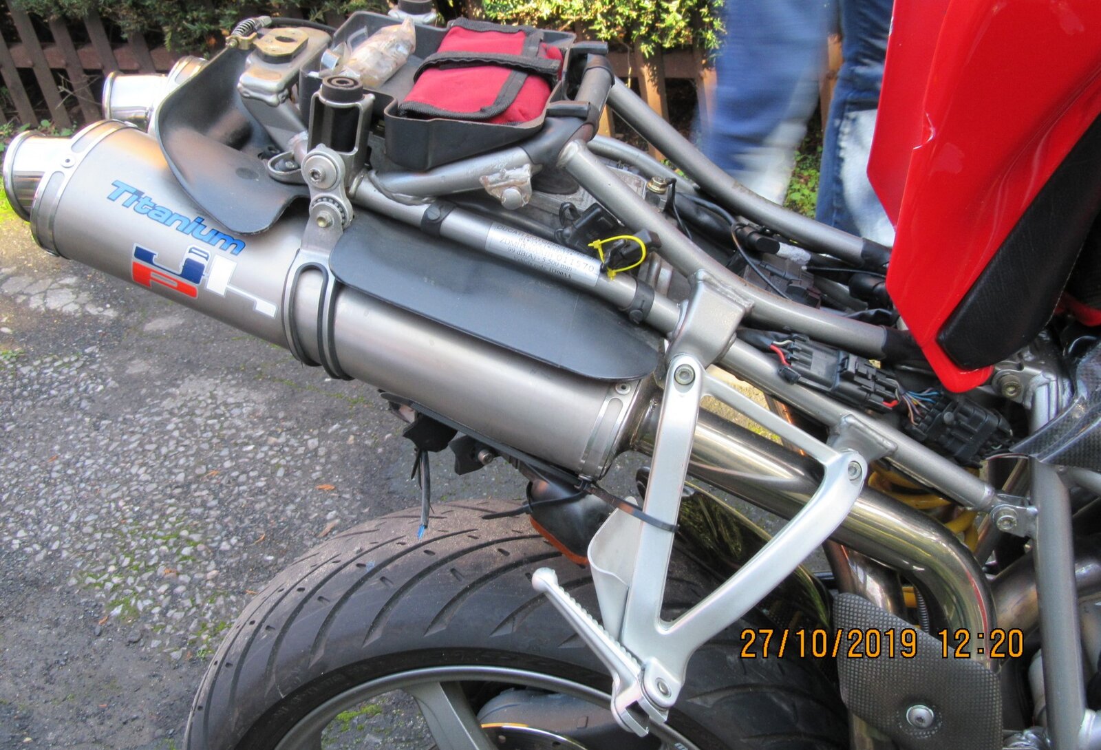

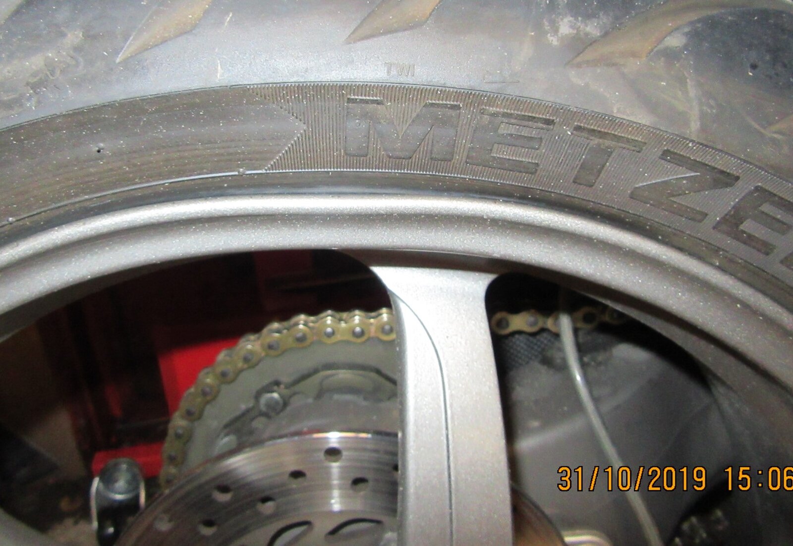

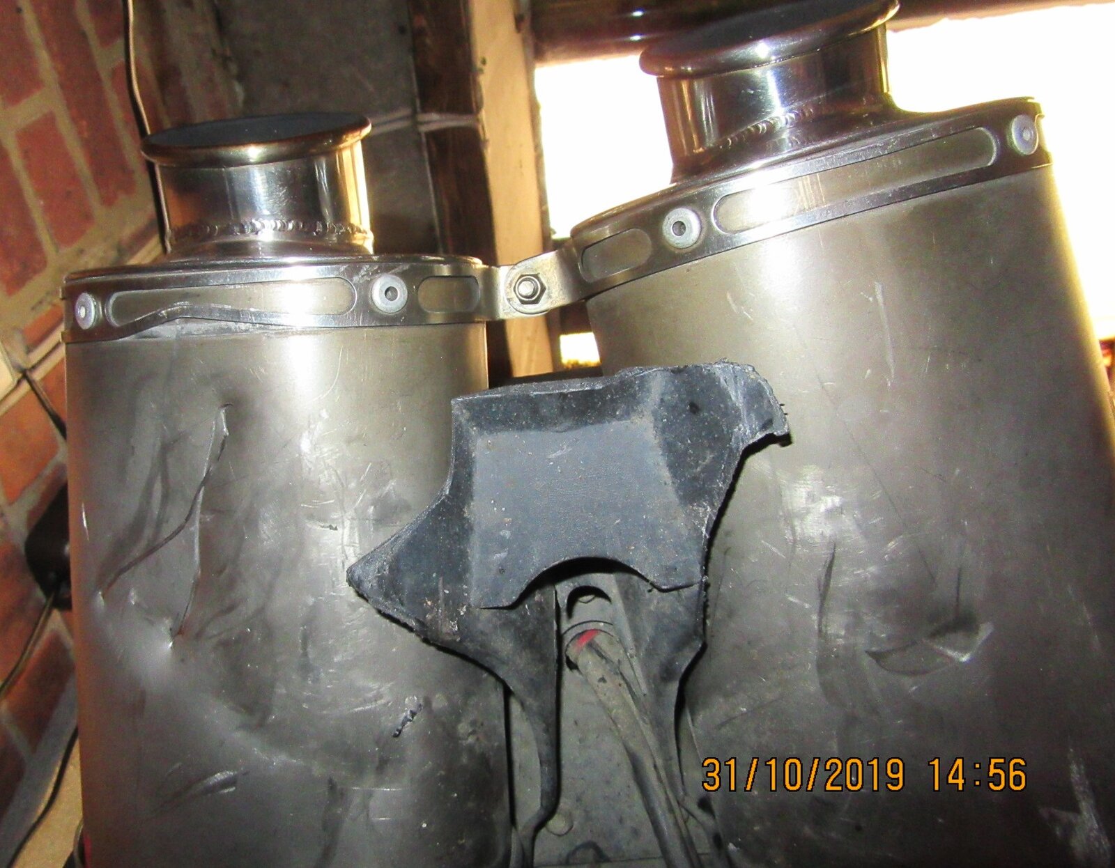

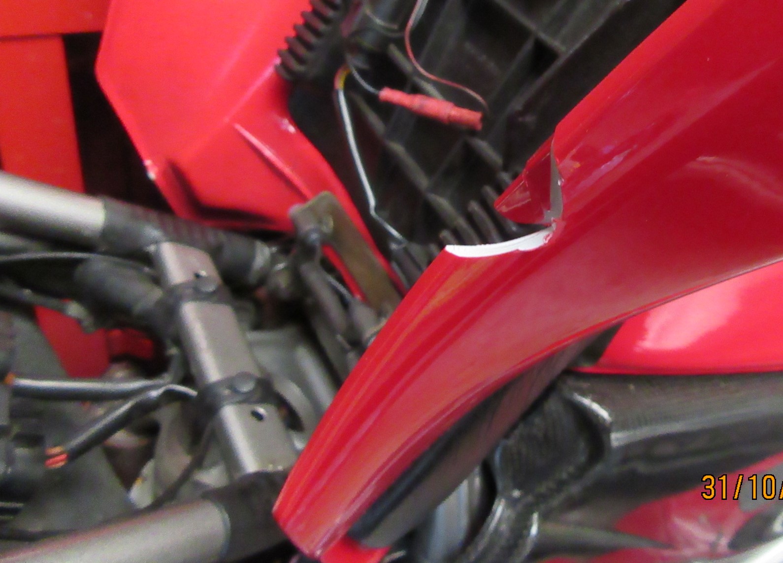

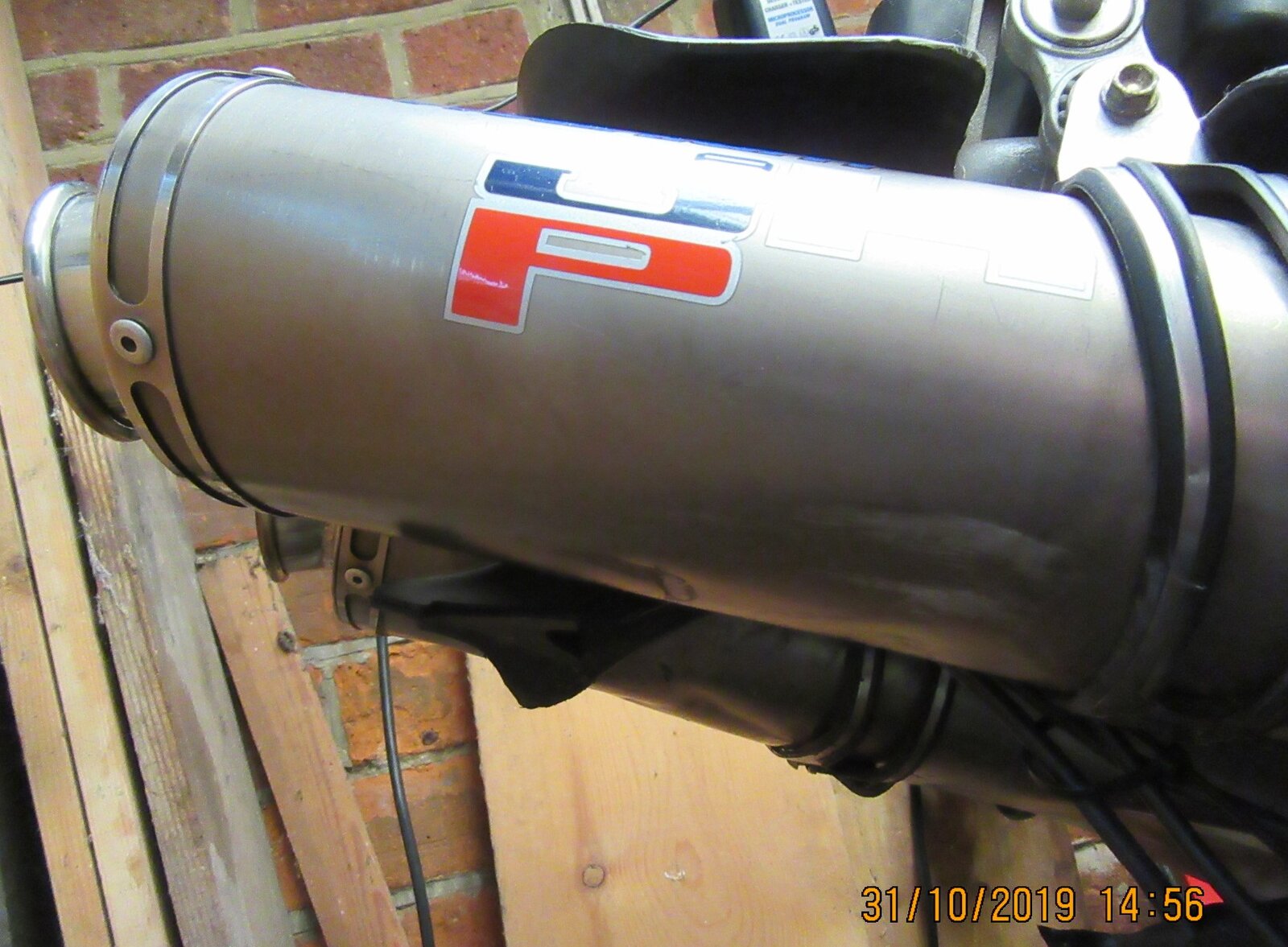

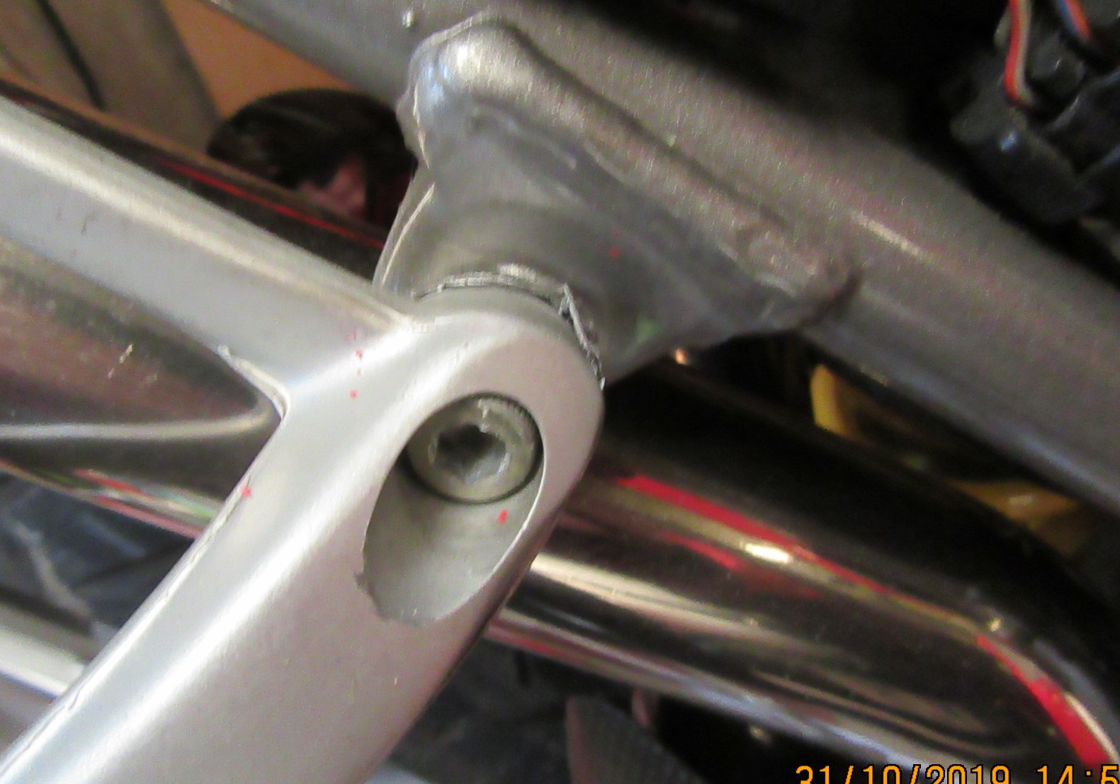

  1. I now have the 748 back at home and am still pretty much housebound, not even allowed to put the kettle on. Today Denzilina helped me to get some more record shots of the damage to the bike. For those that missed the thread I was rear ended at a set of traffic lights by what I now know was a 57 plate BMW 320D and shoved 5m before being ejected over the front of the bike a further 15m onto the road. The bike ended up wedged upright in the front of the engine compartment of the car with the bonnet and cross member wedged between the back wheel and biposta subframe on the 748. Here are some more photos to show the remarkably light damage. I had to crop some down for the file size.
    There is no evidence of stress on any of the frame welds forward of the subframe including the sub frame mounts themselves but the frame will need an alignment check anyhow. The swingarm and wheel bearings will need replacing. Not sure if the rear wheel is suitable for repair considering what happened to it although the buckle is only the bead and is no worse than pot hole damaged ones I have seen repaired previously. The subframe and rear pegs have been opened out as well and the subframe bent upwards which seems to have absorbed the violence of the impact. Had I have not been hospitalized and the bike not wedged into the front of the car it was/is drivable. Rear numberplate gone, plate light and rear indicators destroyed but all other electrics 100% working.
    IMG_0001(1).jpg IMG_0002(1).jpg IMG_0004(1).jpg IMG_0005 (1).JPG IMG_0009 (1).JPG IMG_00010 (1).JPG IMG_0013(1).jpg IMG_0016(1).jpg IMG_0019(1).jpg IMG_0022(1).jpg IMG_0024(1).jpg IMG_0025(1).jpg IMG_0032(1).jpg IMG_0029(1).jpg IMG_0023.JPG IMG_0014(1).jpg IMG_0018(1).jpg
