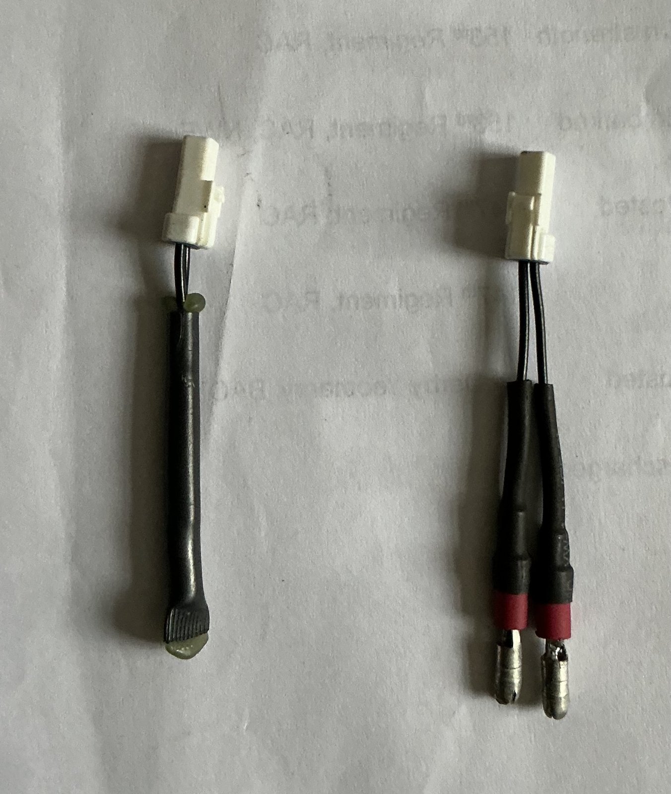

  2. I’m not familiar with the Desert X but have the Garmin XT2 fitted to my V4 Pikes Peak. The Ducati pre wired sat nav loom has a blanking plug that has a short length of wire covered in heat shrink. I stripped back the heat shrink and soldered the Zumo wiring to it. Did the same on my first gen 1200 Multistrada which had the same style of pre wiring. I have a spare somewhere so will try and post a picture. Andy

  3. If your Desert X is the same as my Pikes Peak, this is what you are looking for (L) and what I did for the XT2 (R). Andy
  4. Thanks Andy, even to me that looks pretty straight forward :upyeah::)
  5. @Light Buzzyear, a word of caution, you will need a digital volt meter to make sure the bike’s +ve and -ve match the Garmin’s. My first attempt on my 1200 Multistrada failed miserably :joy: Andy
