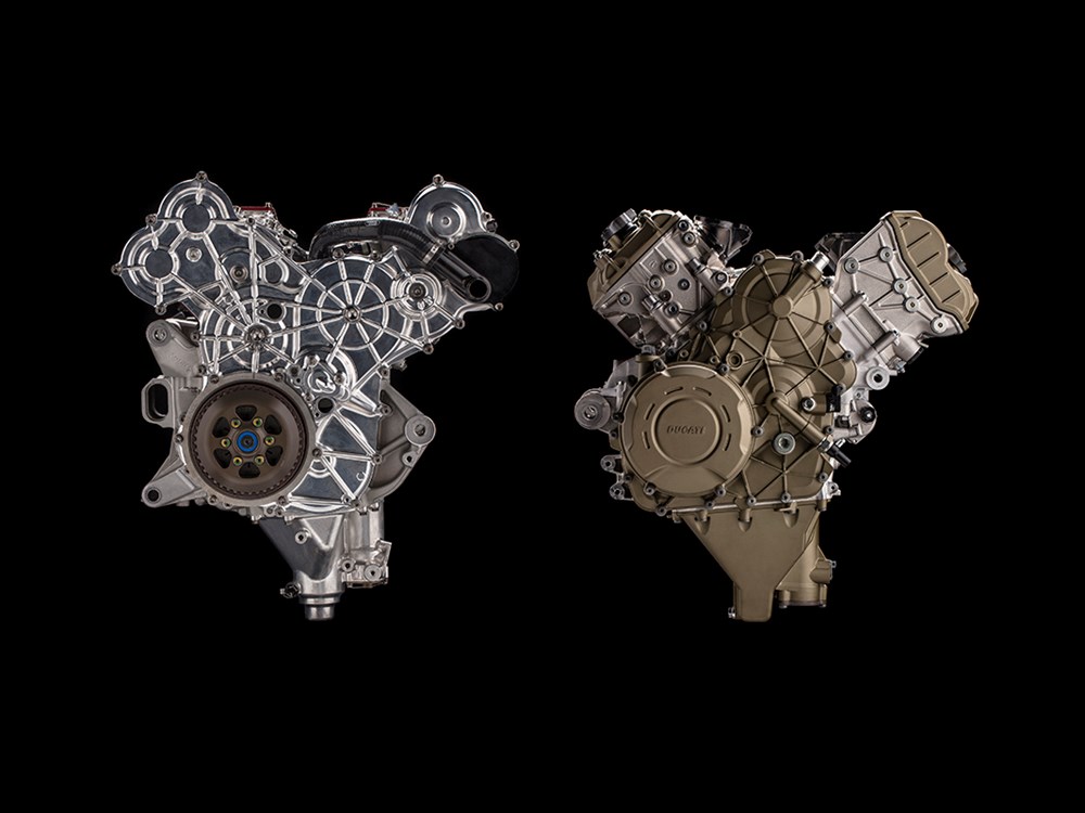

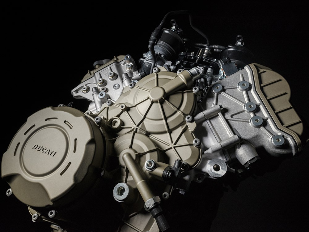

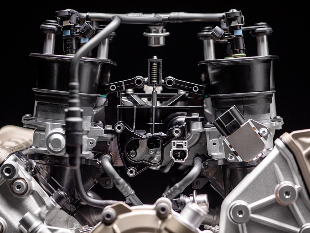

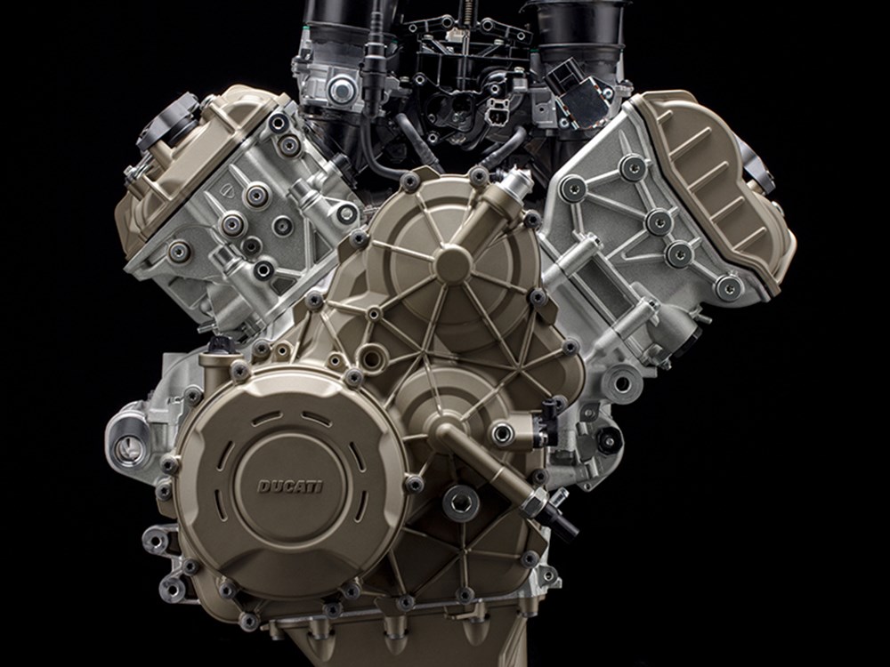

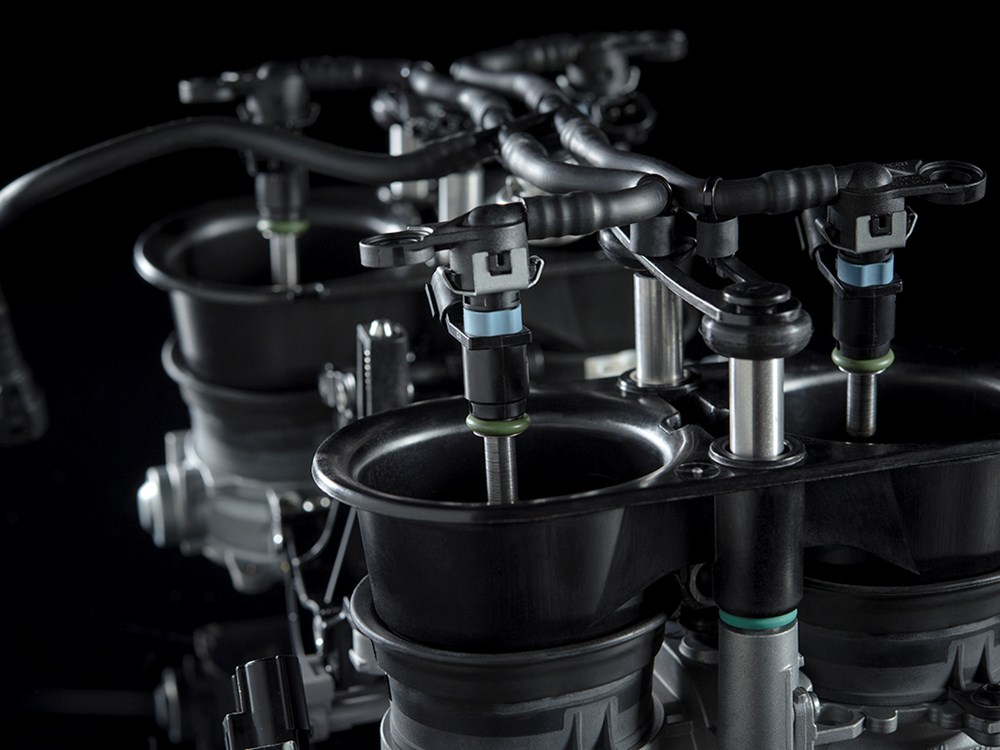

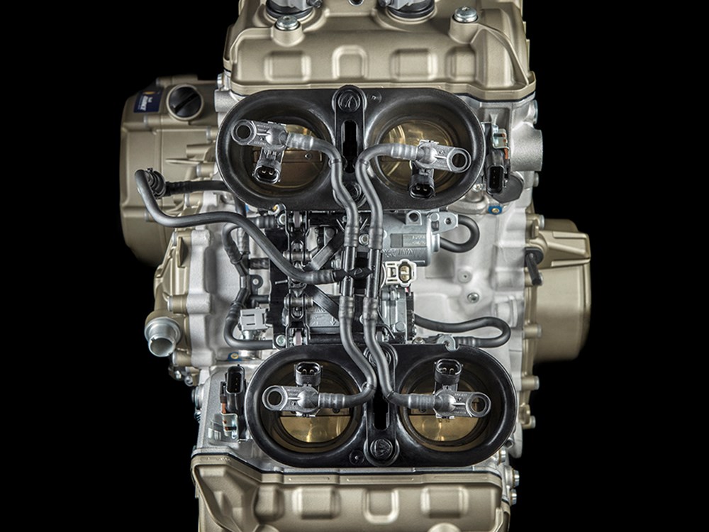

  6. Here's a few to get things started ET
    ducati-v4-025.jpg ducati-v4-026.jpg ducati-v4-027.jpg ducati-v4-001.jpg ducati-v4-002.jpg ducati-v4-004.jpg
  7. Certainly looks like a weapon!

  10. If looks are anything to go by, it,s the dogs chobblies.
