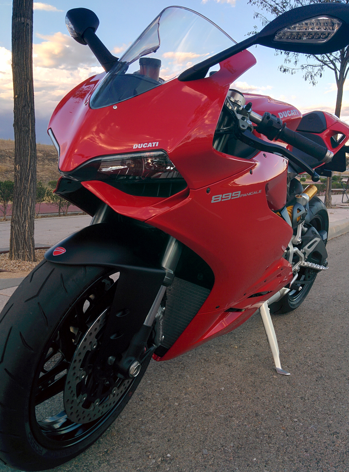

  1. Took my 899 for some detailing run down since I had some marks on the exhaust I could not get out and also for some over all waxing and polishing. I spoke with the owner about the clear coat and he states that it does get affected but the reduction is so little that It does not affect the paint.
    What do you guys say about this? Never take it for polishing? Do it once a year or never do it?

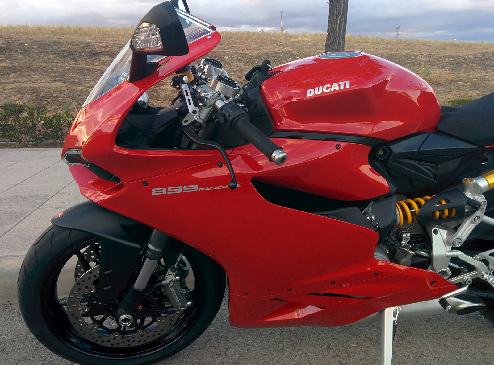

  12. Got it back today. Very happy with the results.
