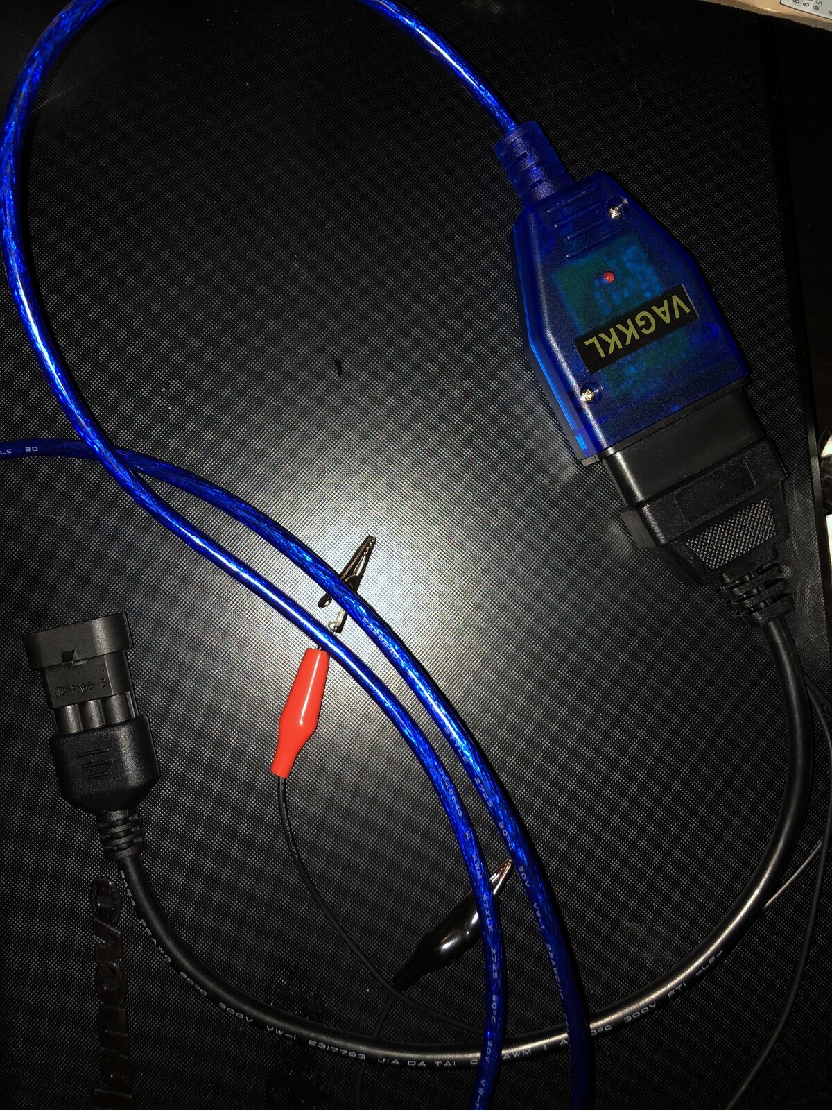

    I have Multistrada 1200 2011-12 with a problem which I planed to solve by diagnostic.

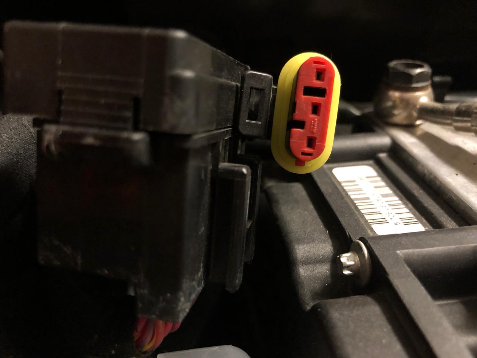

    I have seen 3 pin connector (pic 1) and found a kkl cable and 3 pin reduction (pic 2) for it.

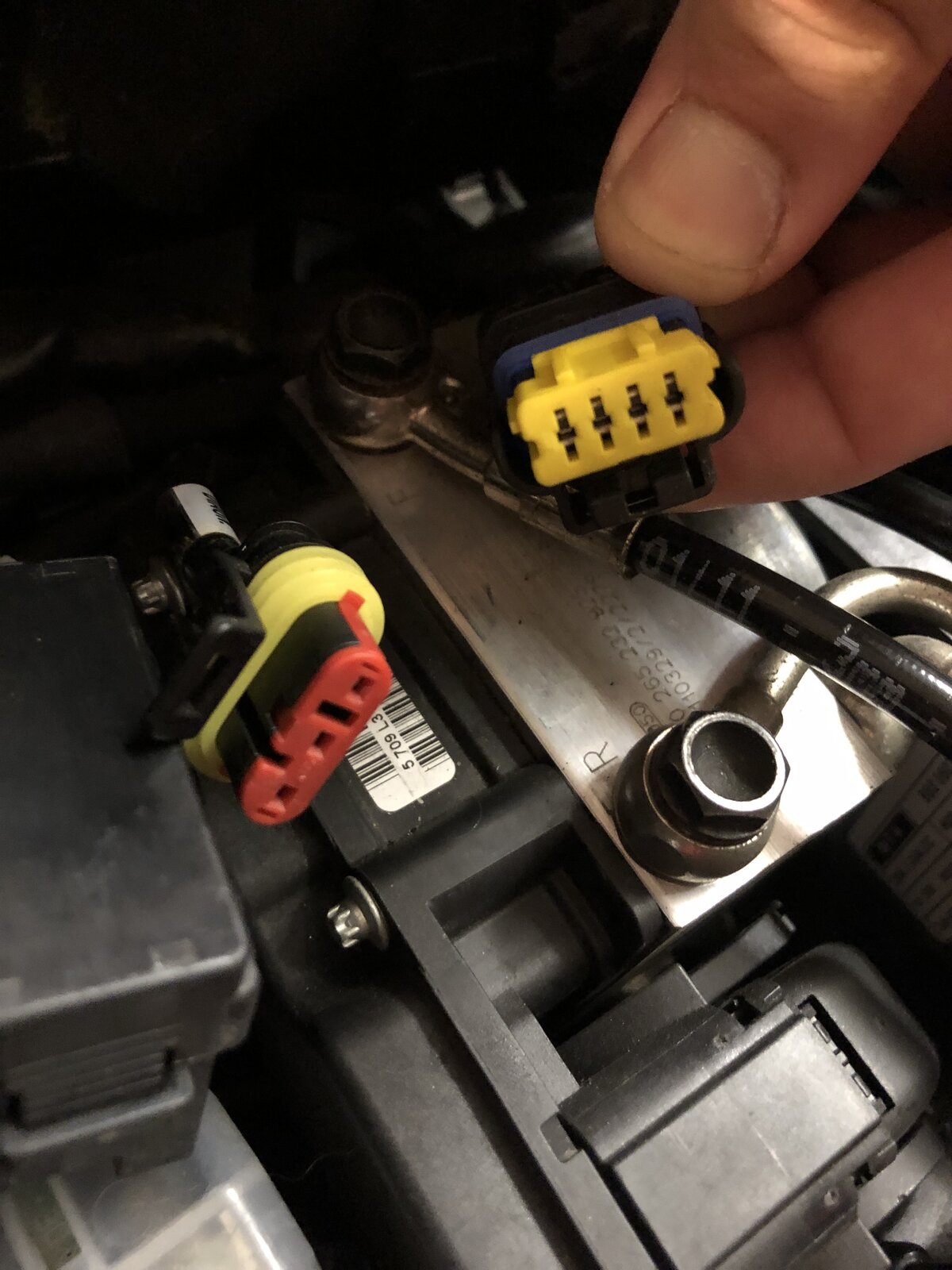

    Download a soft Melcodiag, but could not connect it to the bike. Start to check all possible forums and find out that probably... I am totally stupid, and there have to be the other connector - 4 pin, which I found later (pic3), and I need not KKL, but ELM cable... so sad...
    So, the question - is it possible with the cable I have, with some other soft get errors from bike, or it is absolutely useless?
    Thank you for your answers...
  2. Melcodiag won't connect with the KKL cable, you need an ELM 327.
