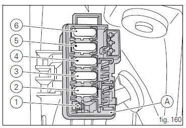

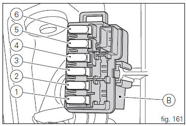

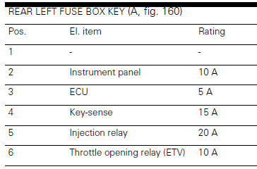

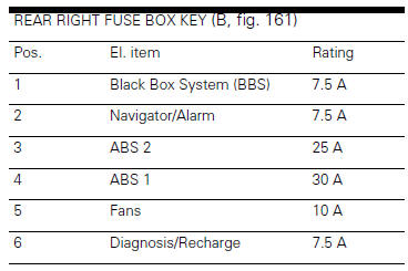

  13. My first checks would be the ECU and BBS fuses
    49C91223-28B3-45C9-8B6B-F9601659F8E3.jpeg BC795919-D292-4160-9169-C54A4133727D.jpeg

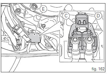

    and also the main fuse
  14. Thanks again mate , since yesterday I gathered more info & found location of main fuse right next to the battery in a little white plastic compartment & there was a spare fuse there waiting for me. Sorted
  15. Great info you sent me Big Thanks . Had checked earlier fuses under seat & they were all good I then found location of main fuse near battery & low & behold there was a spare 30amp tucked inside /swapped it linked up battery correctly this time & everything lit up nicely. Thanks so much again . 1 last thing/Question , even though i replaced the original battery which was new & had been bought a month ago I was told that crossing power leads on a battery can be dangerous if reusing that same battery again even though there is no obvious swelling. In other words should I just get another new battery to be on the safe side?
