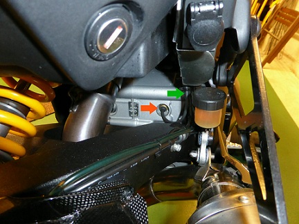

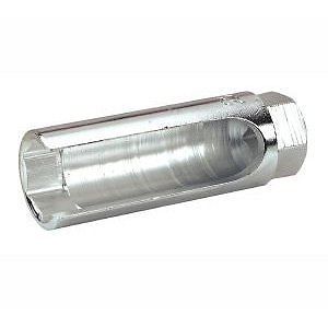

  4. I had one of these fail, its the brass bolt headed plug on the back of the engine block with the cable coming off it. You will need an open socket, like an oxygen sensor type one, but I'm not sure if its plug and play or not as mine was done under warranty ?? I seem to recall it is just a case of replacing and no set up was necessary but a quick call to a dealer will confirm this. This picture is a Multi, but the plug is the same. :upyeah:
