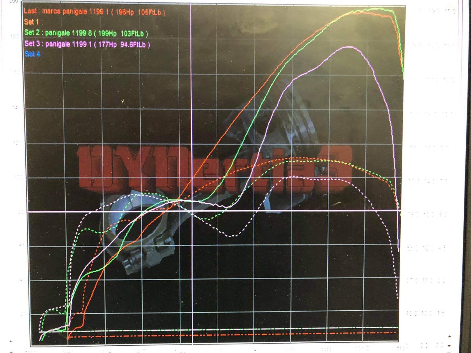

  3. Have you thought about an 1198? Or if you can stretch, a 1299? I just think Ducati lost the plot a bit with the 1199 oversquare engine configuration. Torque and power a bit dull low down. Look at some dyno chart comparisons and you'll get my drift.
  4. I have a base with ohlins upgrade forks, ttx shock and S wheels as a track bike. Not ridden it properly yet but as @Mary Hinge says the standard power curve is interesting. This can be largely corrected with mapping but as a road bike I reckon a 1299 would be better.
  5. Blimey - you wouldn't think that was the same motor! And this was just from mapping work?
  6. The green and pink were same engine, the other one is blue printed from memory
