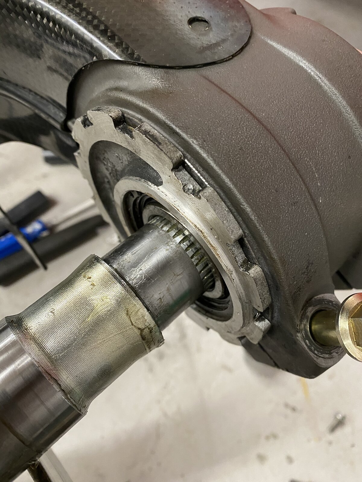

  1. Had an exchange axle pin but really struggle to get it in to the bearings on the left side. Tried tapping with a rubber mallet to persuade it, but it seems to not want to pass and has a metallic sound which to me says it doesn’t want to budge!
    it’s a 2000 996 but that shouldn’t make much difference? Are there different sized axles or anything like that?
    pic attached just cos I like pics :)

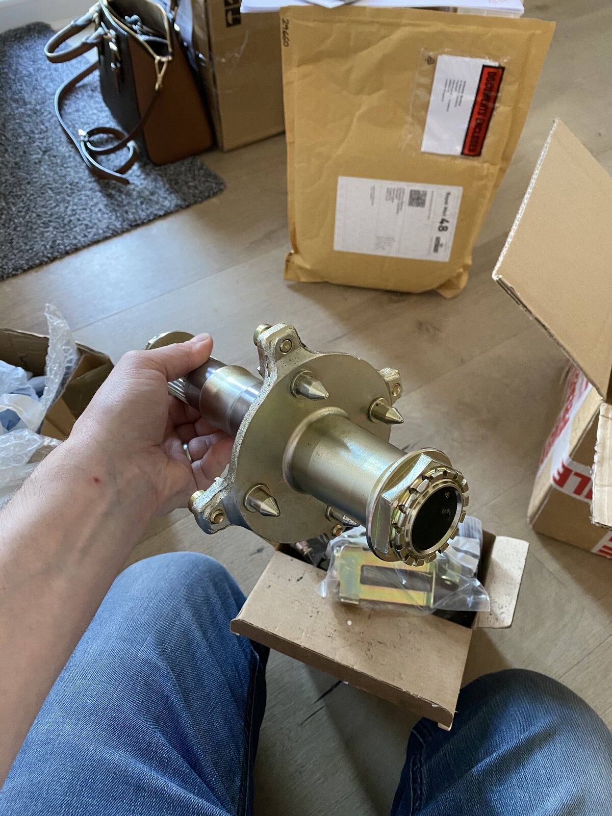

  2. Did you get the old one out without any bother? I think they are all the same BTW.

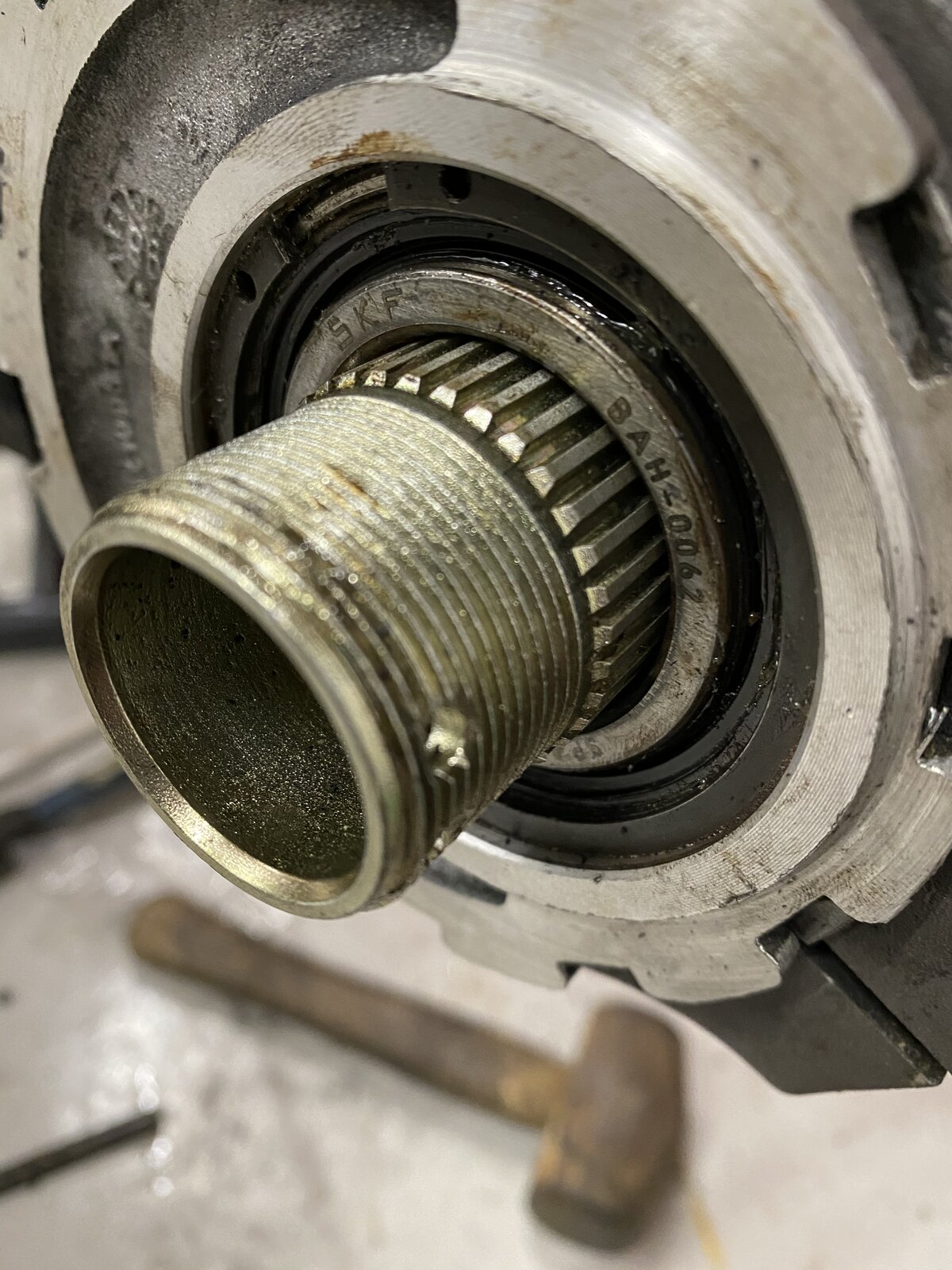

    EDIT - is that your manbag?
  3. All the same mate, I wonder if the re coating has made it too thick?
  4. Zinc? No way. Tried turning it on the way in?
    Daft to ask but you have the two pinch bolts out don’t you. Sorry.

  6. Has a spacer dropped down?
  7. Tested it from both sides and it gets stuck at the same place.

    here is is tried from both sides

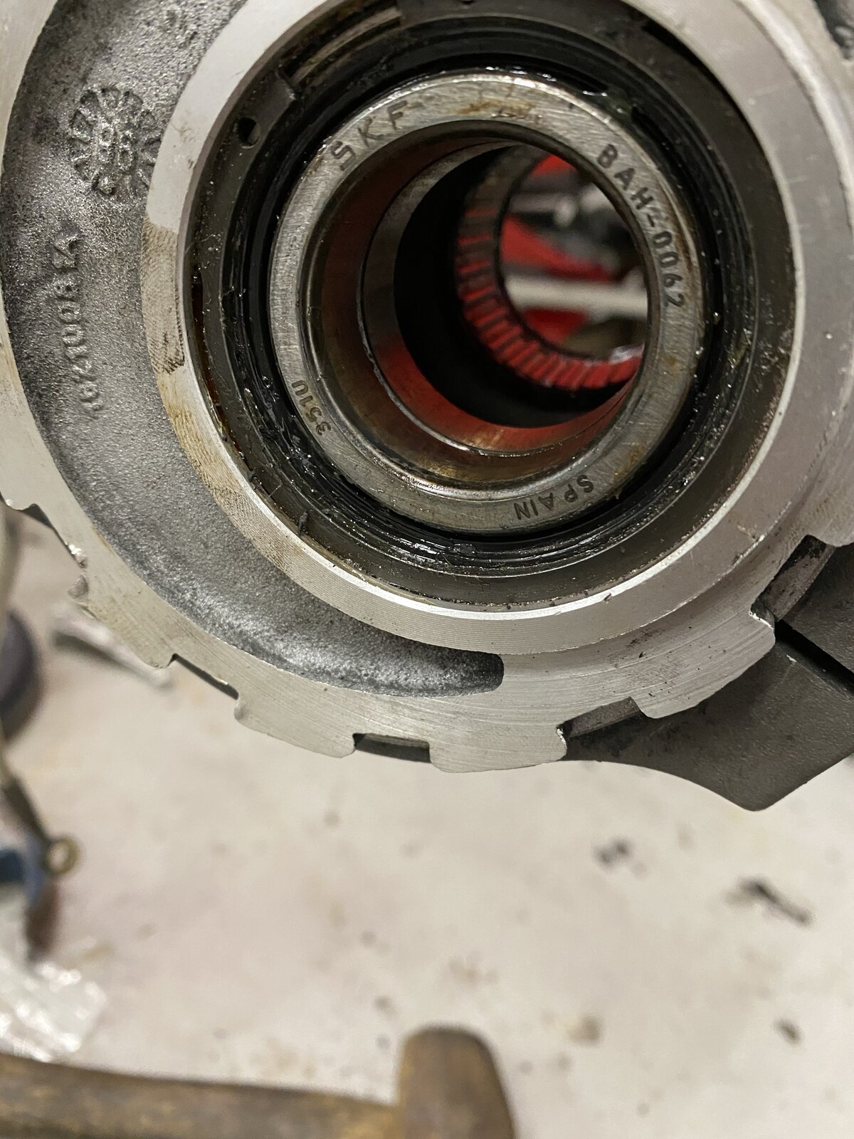

  8. Buy a flap wheel and get it on the drill, polish the inside of the bearings.
    Will only need a very small bur and it won't fit.
  9. And the rear hub is right back for future ref
  10. And you're an MOT man?o_O
  11. No mate it’s getting stuck on a part that’s not coated.. it’s weird!

  15. Nice handbag.

  18. No bearing should be that slack, a bush yes. A roller brg should always have an interference fit, even if minimal.
    Unless you are expecting it to be like a drawable wheel spindle, which this really isnt.
  19. hard to tell for sure but does look as though someone has had the whole assy aftermarket plated* and maybe the splined section still has excess remaining. Does close inspection of end of spline reveal the chafing where it comes to a stop?

  20. The plating has been finished off properly on this, but I did notice late last night a small burr on the splines which is where it’s picking up - I’ll get my needle file on it later and carefully remove them see if that sorts it
