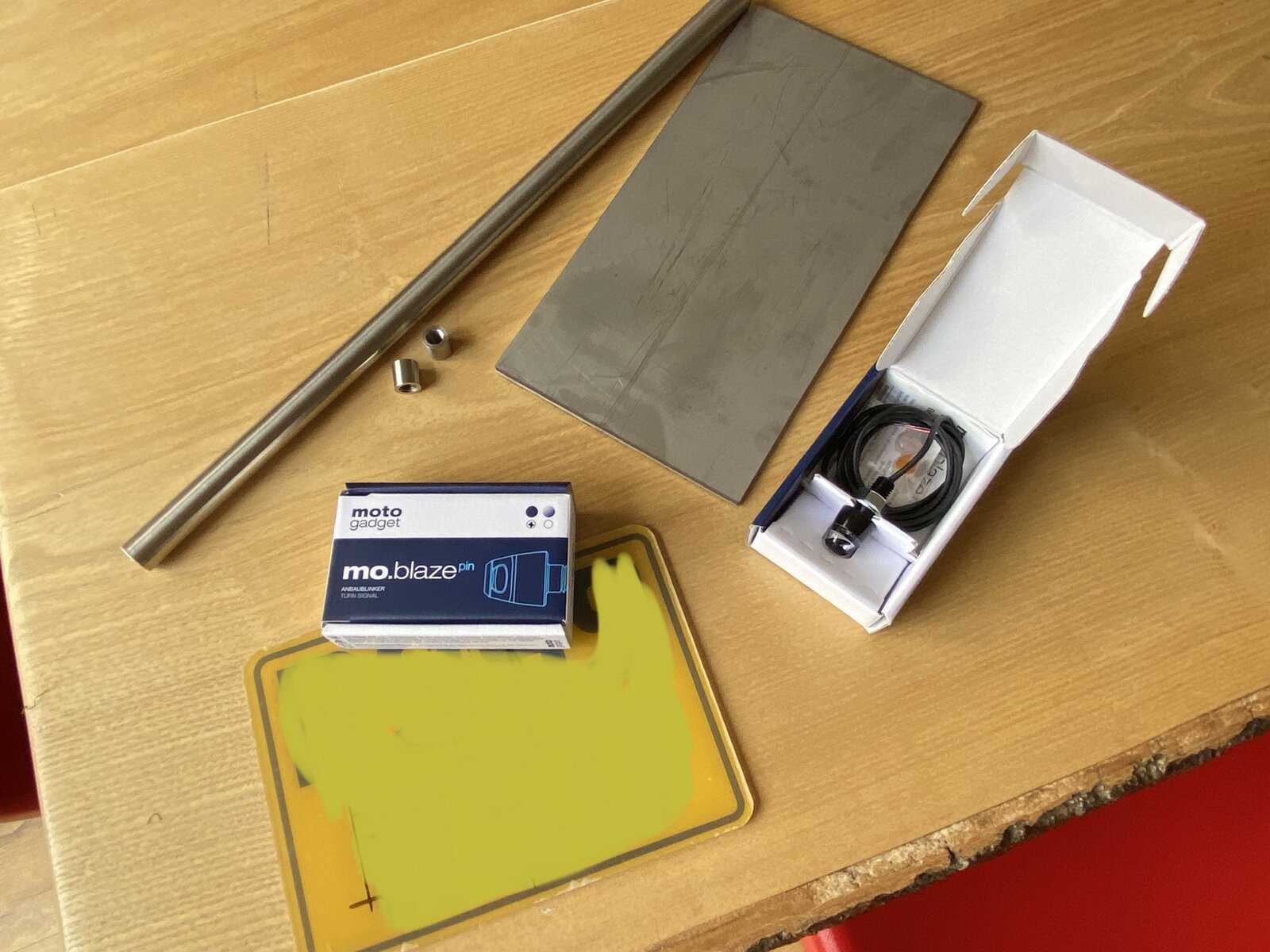

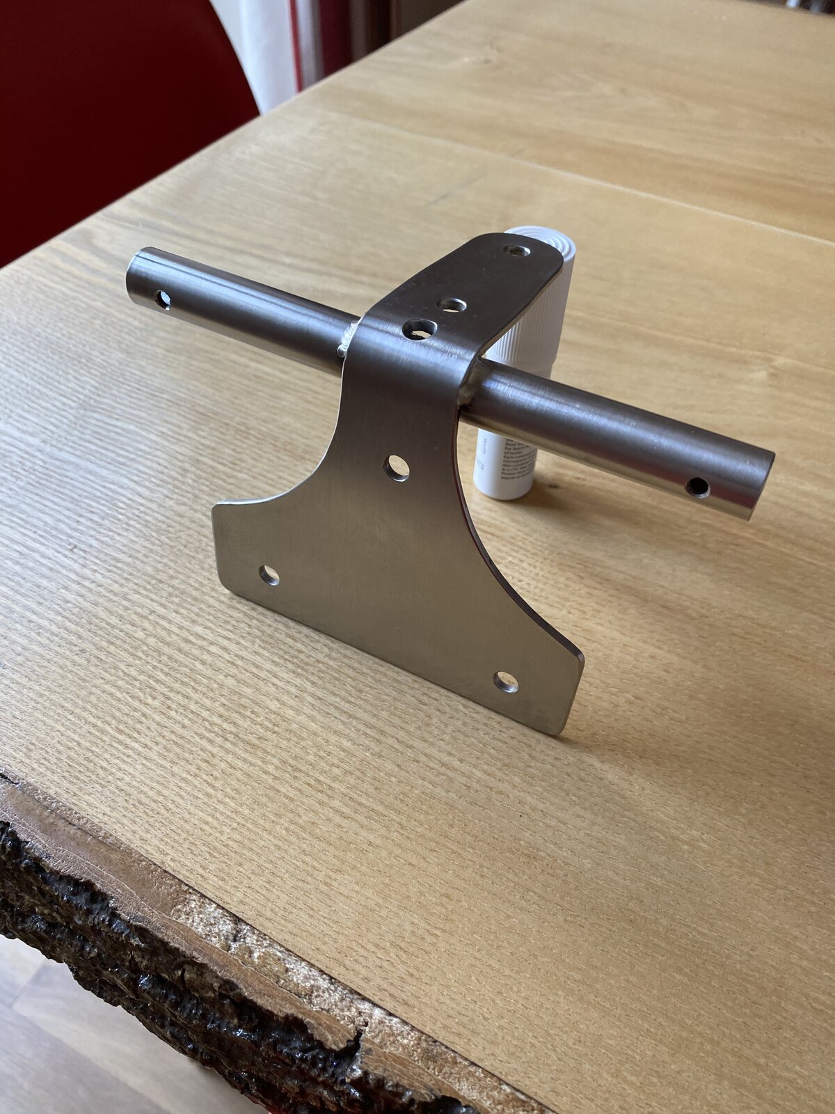

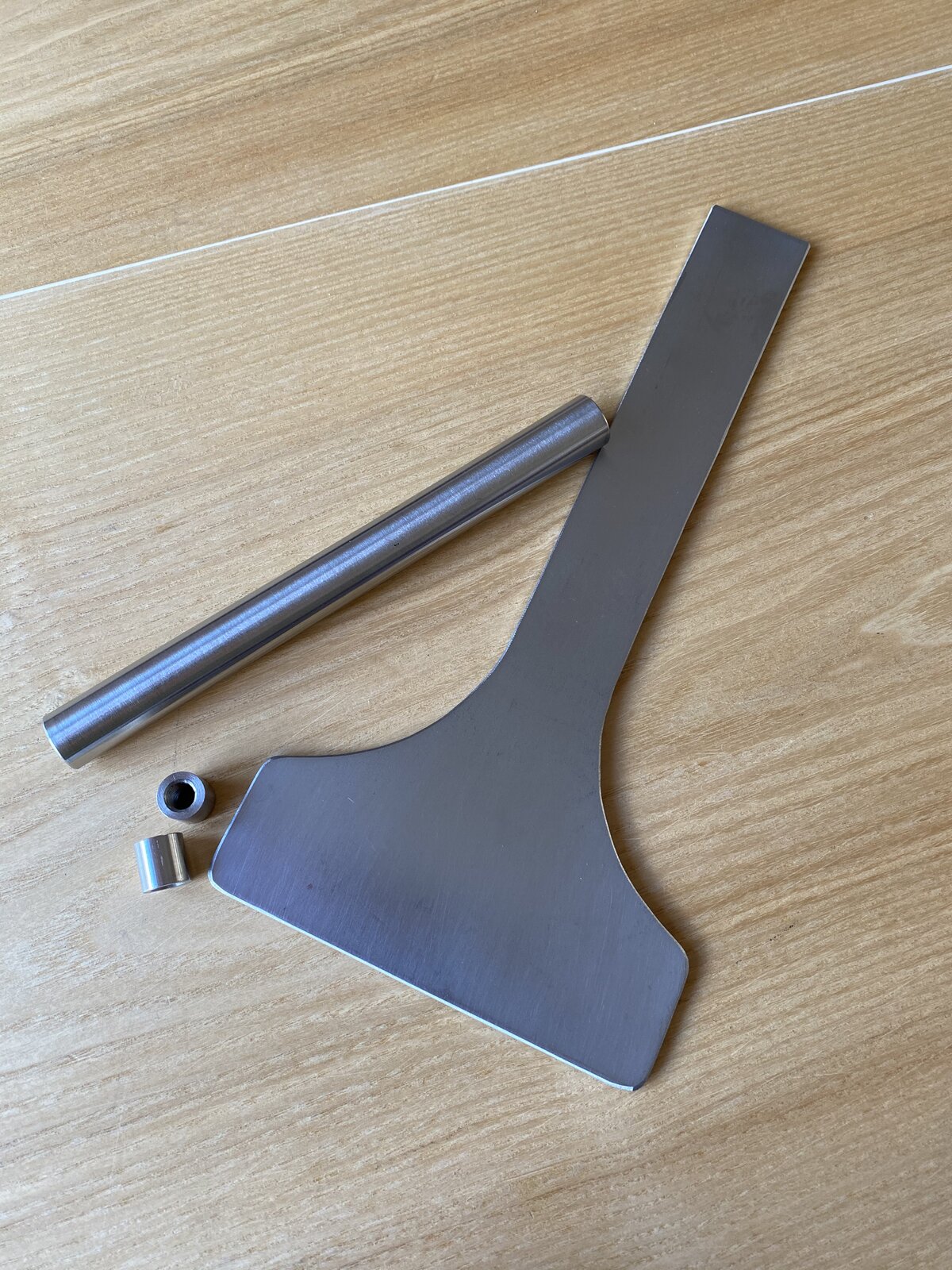

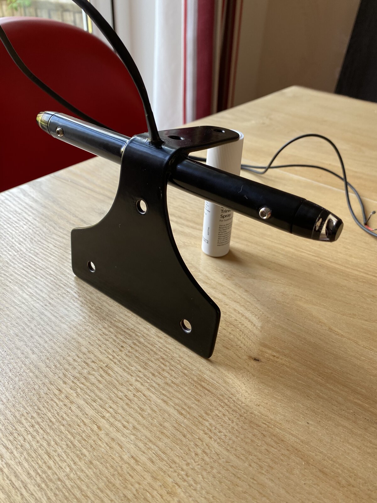

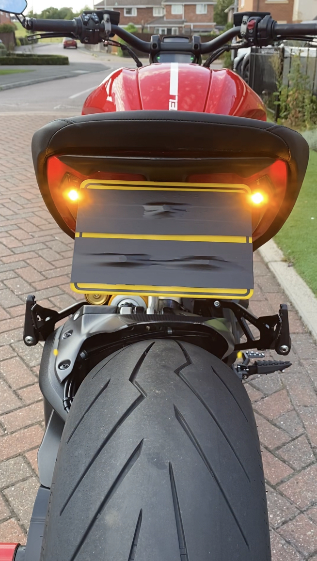

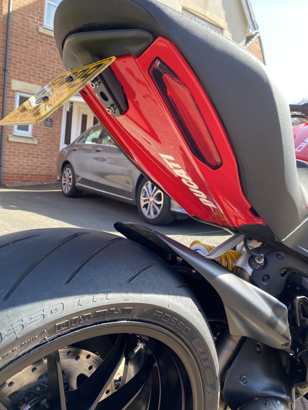

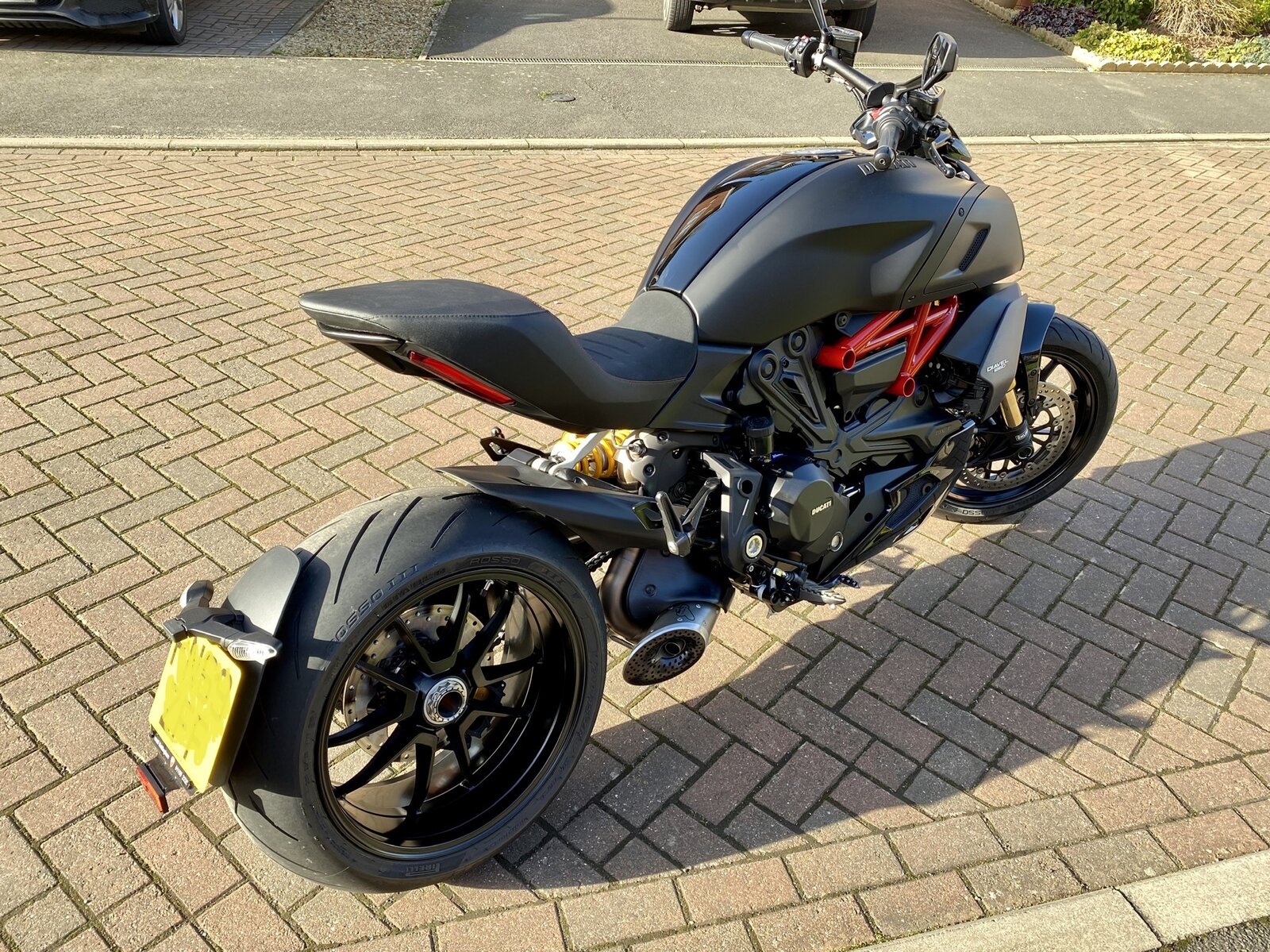

  1. First job on the 1260 was to relocate the number plate from stock position to the grab handle, but, this meant losing the indicators.
    I was fine with that short term, but knew I’d have to sort it eventually. So, started with some some 3mm stainless steel plate, 16mm dia. stainless steel tube, treaded insets in SS and a pair of Motogadget M Blaze Pin indicators.

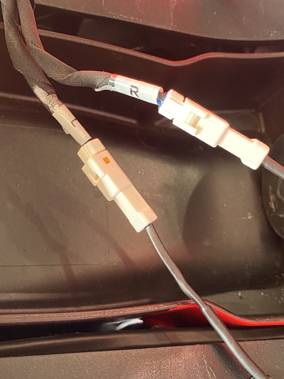

    After some work in the garage, help from a mate who can TIG Stainless and a coat of satin black powder coat. Using the right connectors means I can plug straight into the stock wiring loom.
    The indicators are almost invisible when off, but more than bright enough when on.
    I’m really happy with the result.

  2. Nice tidy job that:upyeah:.
  3. Nice work. Would be great to see a few pics of the whole bike :)

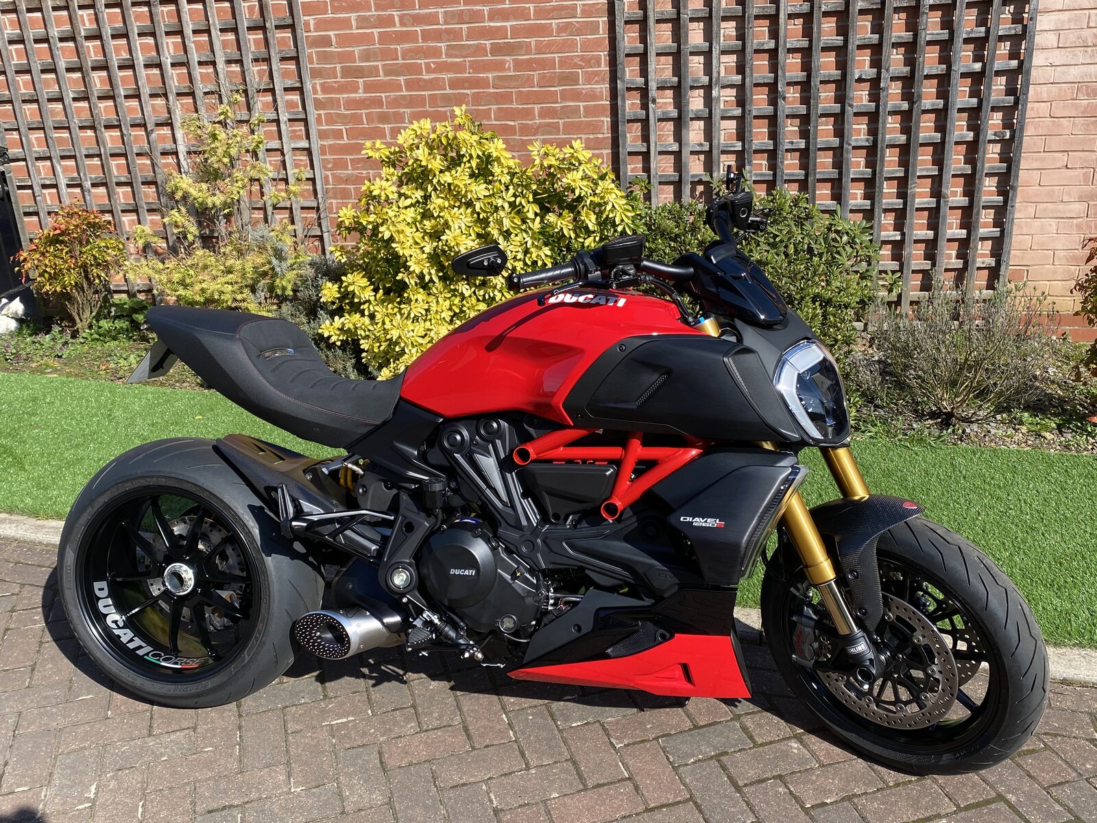

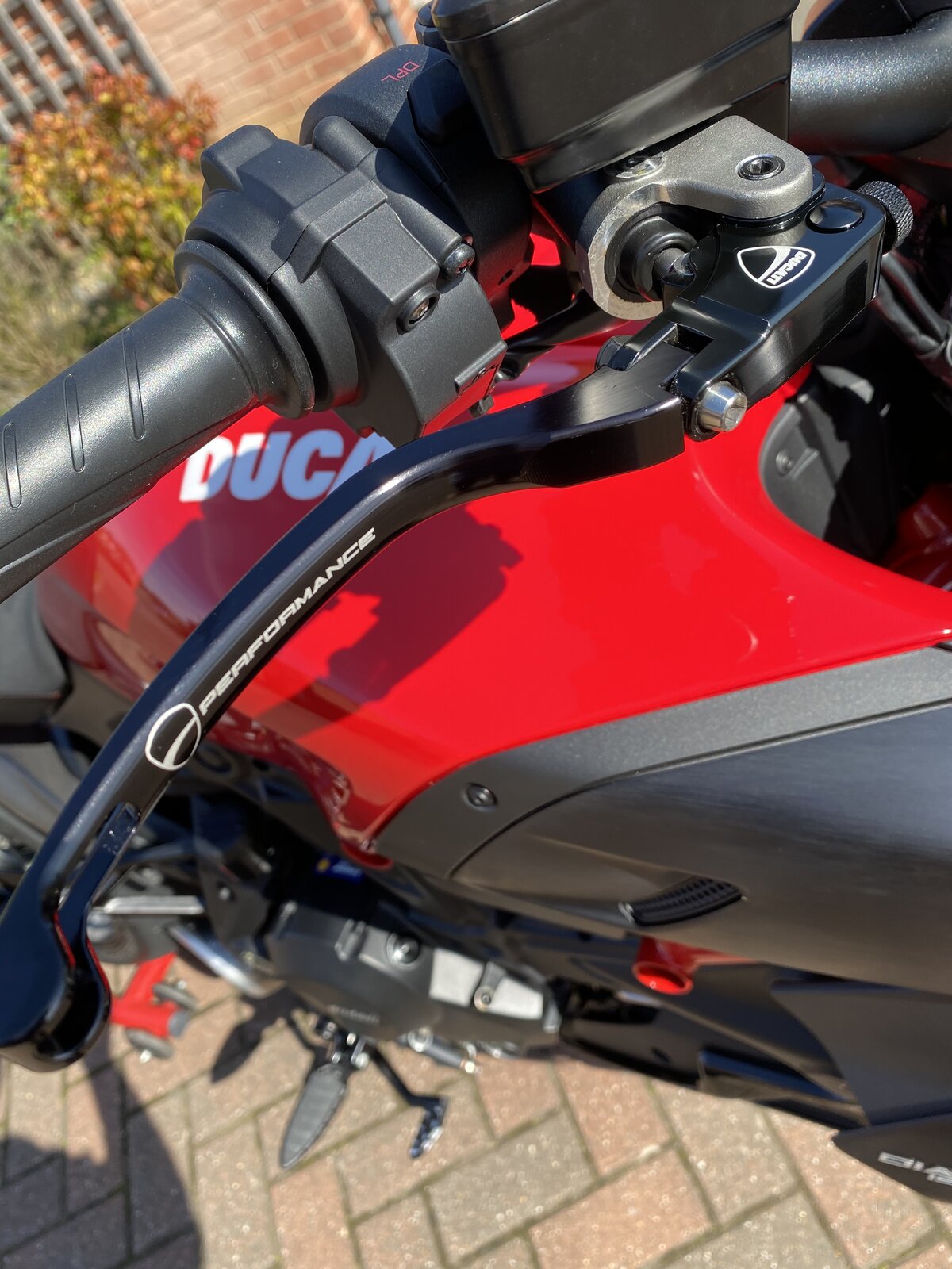

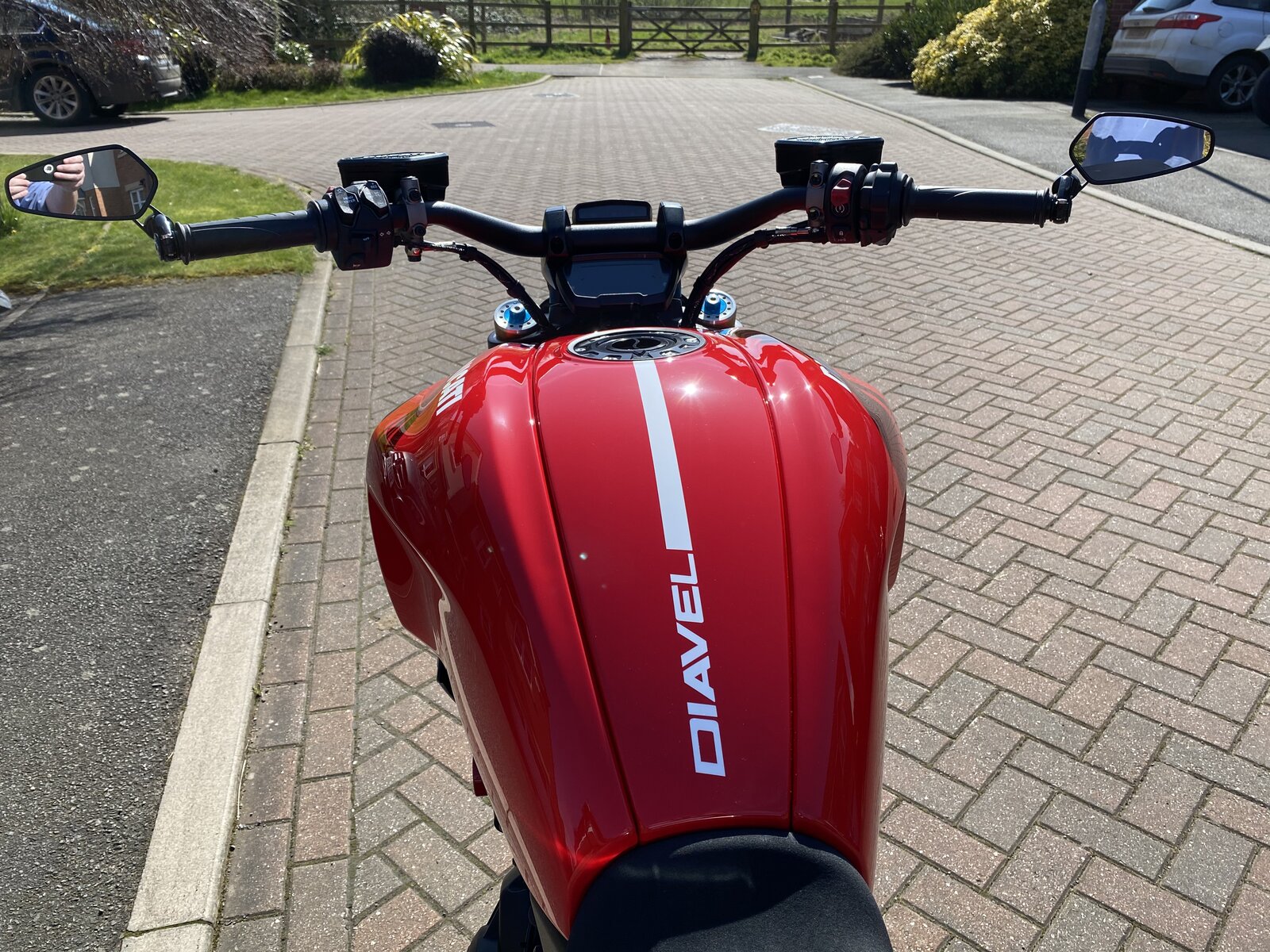

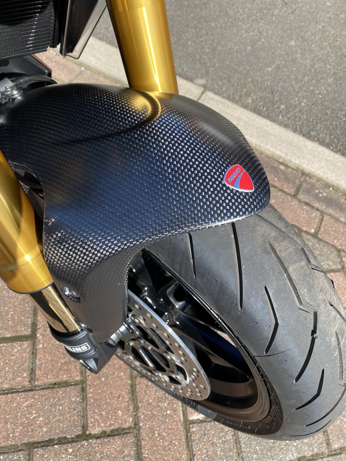

  5. Started life as an ex demo black bike, now painted and tweaked a little

  6. That looks great buddy, nice job. Like the Simpson Darksome too. I have the Gloss black version, really impressed with it.
    I fancy a ride on a 1260, heard they are an awesome piece of kit
