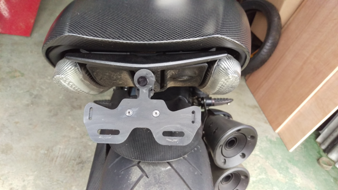

  2. I've done it. I'll take some pics tomorrow, but I got an Evotech s/h off ebay (Yamaha R1 I think), cleaned up the brackets so I could tap the grab rail where the reflector mounts. Had it anodised & it looks great. Put some slack in the wiring so the grab rail slider still functions.

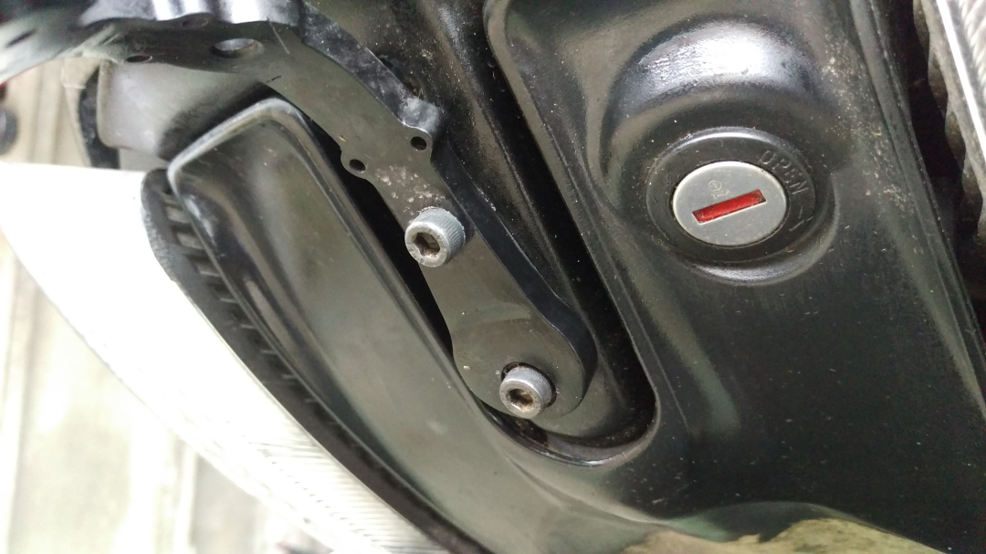

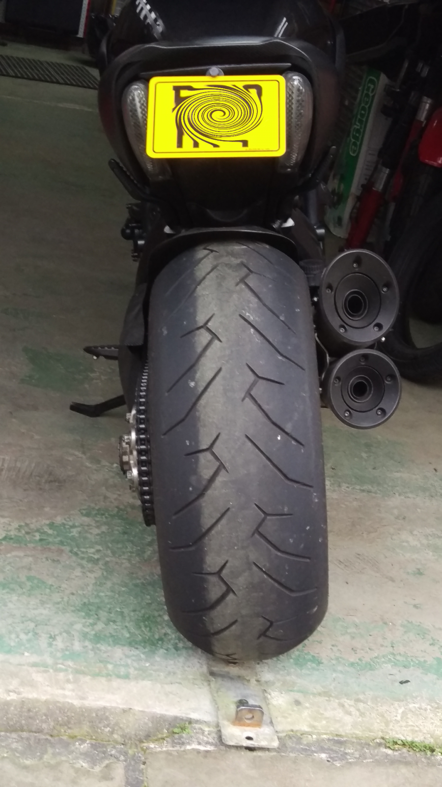

  4. Here are the promised pics - excuse the dirt!
    I used the Evotech donor as it had 75% of what I wanted, & I could just saw off & clean up the extraneous parts. I had it re-anodised once complete & I think it looks pretty 'factory'. MOT nazis will notice the lack of reflector - I'll probable stick something on once the time comes.
    HTH

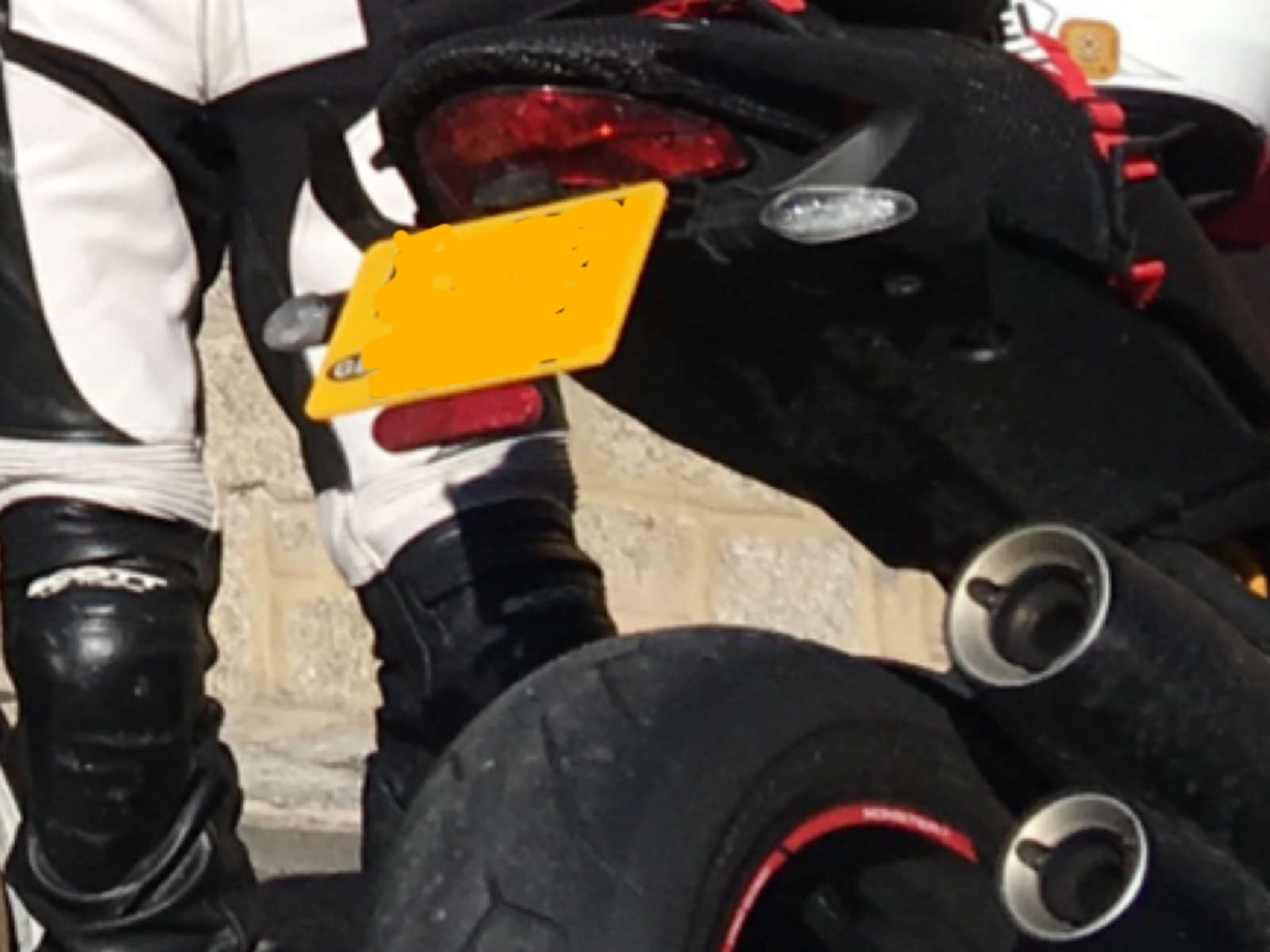

    Not a great pic but gives you the idea.
