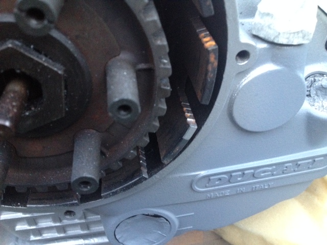

  1. I don't like the look of those sawtoothed edges
    On a scale of 1 to 10, how bad are these (10 being very poor) ?
  2. Id say a 6
    Itll wear the plates quicker as theres more movement, and therefore noise. Its not the worst Ive seen. If you are putting new plates in, I consider getting a new basket.
  3. Pretty bad but you can cut the noise and the wear at a stroke by applying the quiet clutch mod.
    All you need to do is to reorder the plates with a friction plate at the bottom of the stack. Because the basket slots are machined with a curve at the bottom, putting a friction plate in first means that the tabs of that plate drop down into that curved section, locking the plate into place and damping the movement of the whole stack.
    As the stack is now no longer free to oscillate, the noise is cut and the wear along with it because the tabs are no longer constantly bashing the basket.
    For the same reason, the wear-gap between the tabs and basket is no longer a problem, as the tabs are now stable and no longer bashing back and forth.
    If you love the dry clutch rattle though and don't mind replacing plates and basket every few thousand miles, this is not for you.

  4. Excellent info, thanks. I think that mod is definitely for me.

  7. It’s dead easy to do.
    Simply remove all the plates and put one of the friction plates in first.
    The order of the plates is not terribly critical, it needs to be broadly alternate friction and plain and ending with a plain at the top under the pressure plate.
    You will get a slight reduction in effective stack height but it shouldn’t be enough to matter.

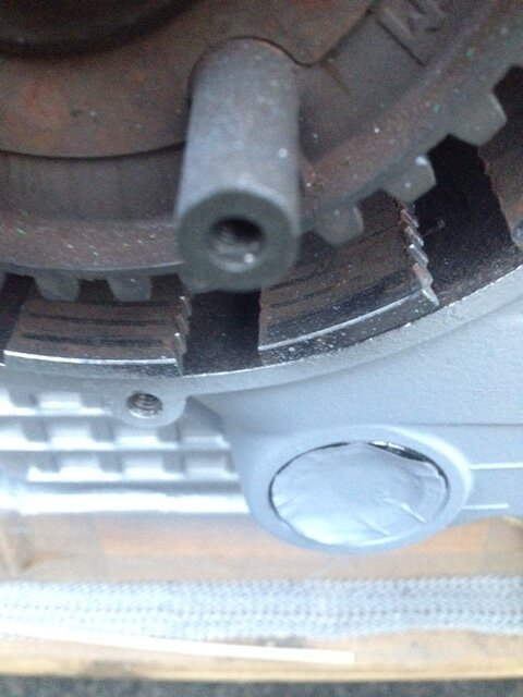

  8. I've seen them worse than that on my own bike , and I've been through quite a few clutches in 20 years / 100,000+ miles :)
    I've tried filing away those grooves , but it's really just " kicking the can down the road " .
    It certainly helps if you are getting grunts , groans and shudder when moving from standstill .
    But I wondered if the slightly increased width of the slots meant a bit more violence on the tabs of the friction plates .
