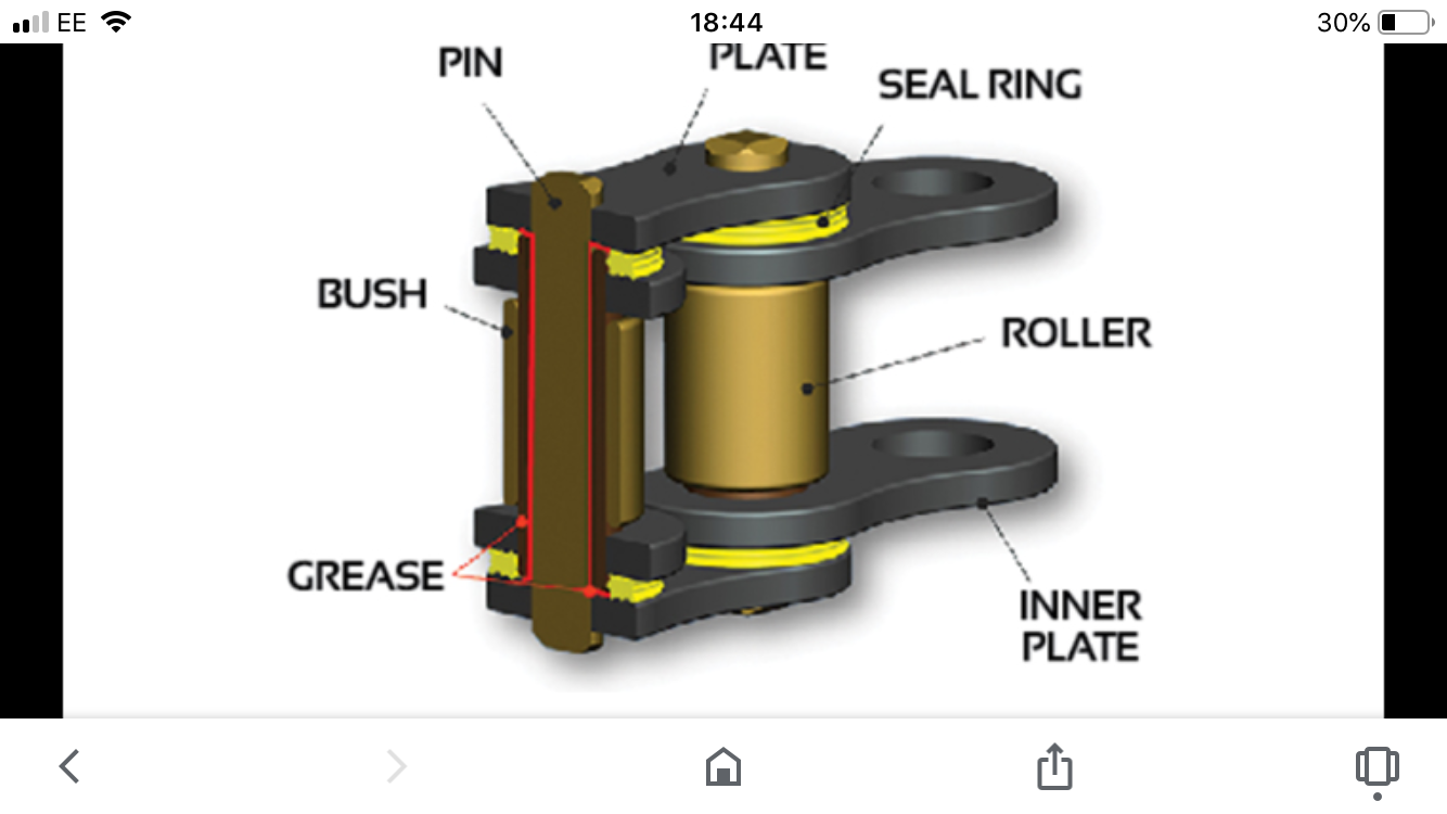

  10. 5E1ECB10-34AD-4354-B573-66EDE703150A.png Motul Road C2 is the best I’ve found so far, goes on thin so stands a chance of getting into the rollers and it hardly flings, its clear as well so doesn’t make the chain look a mess.

  11. Btw, if you look carefully at the diagram in my previous post you’ll see that the “O” ring seals between the plates so trying to get chain lube into the pin/roller at that point won’t work (although you should still apply it there to lube the outer edge of the seal rings) to lube the pins and rollers apply the lube where the rollers meet the side plates, there’s a gap between the ends of the rollers and side plates, if applied well the lube will flow under the rollers, it’s surprising how many people just apply lube to the gap between the plates where the “O” ring sits.
