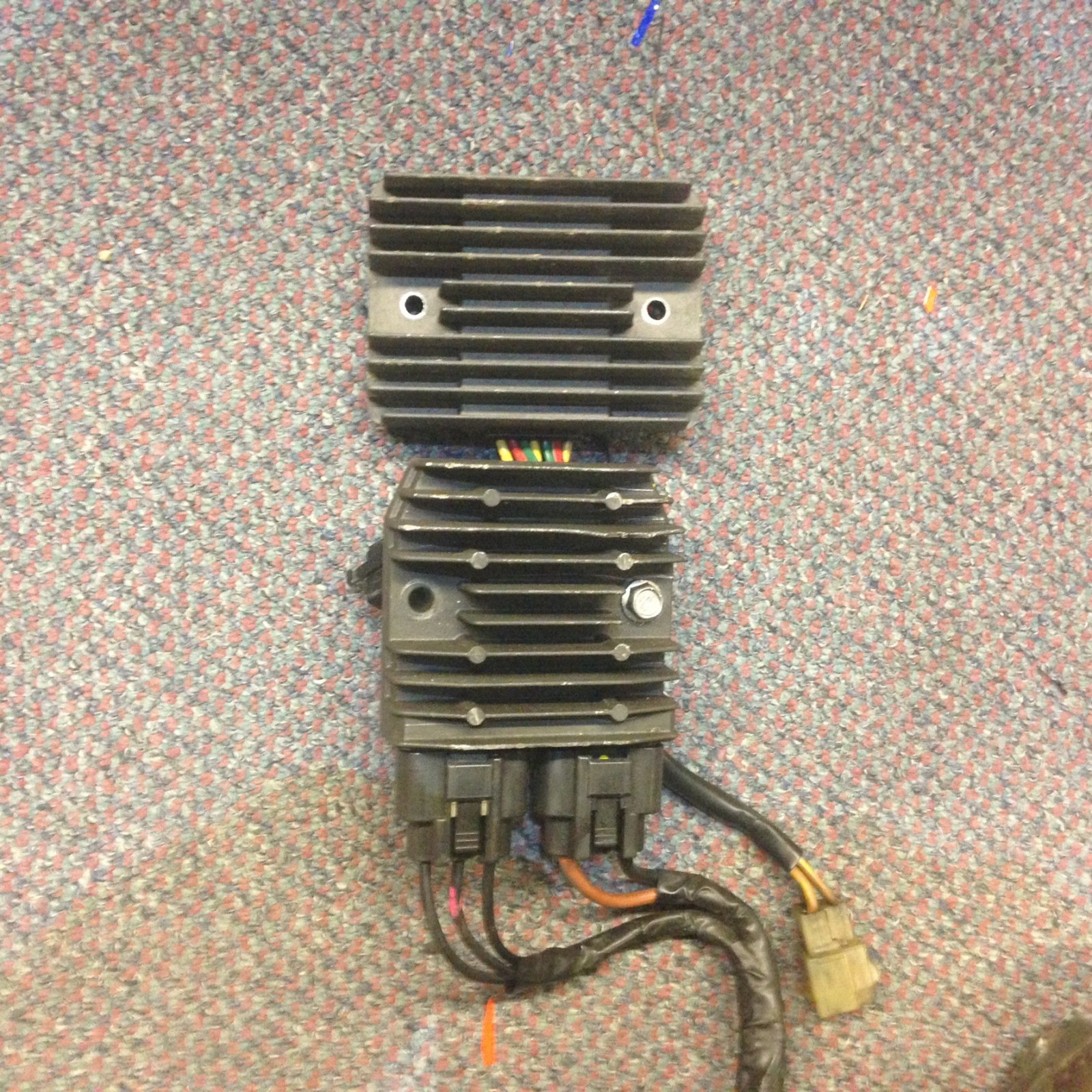

  5. Ebay is a good source. Get a second hand unit from a Kawa ZX10R, Triumph D675 or ones from Ducatis are creeping onto the market. You then need the wiring loom from Triumph. Watch the video. I'm about all weekend.

  9. Just to say a massive thanks to @chrisw. He not only found the R/R with link cables for a 955i for an unbelievable price, but went and ordered it as well. He has helped me out a few times now as he has many on here. Top bloke!

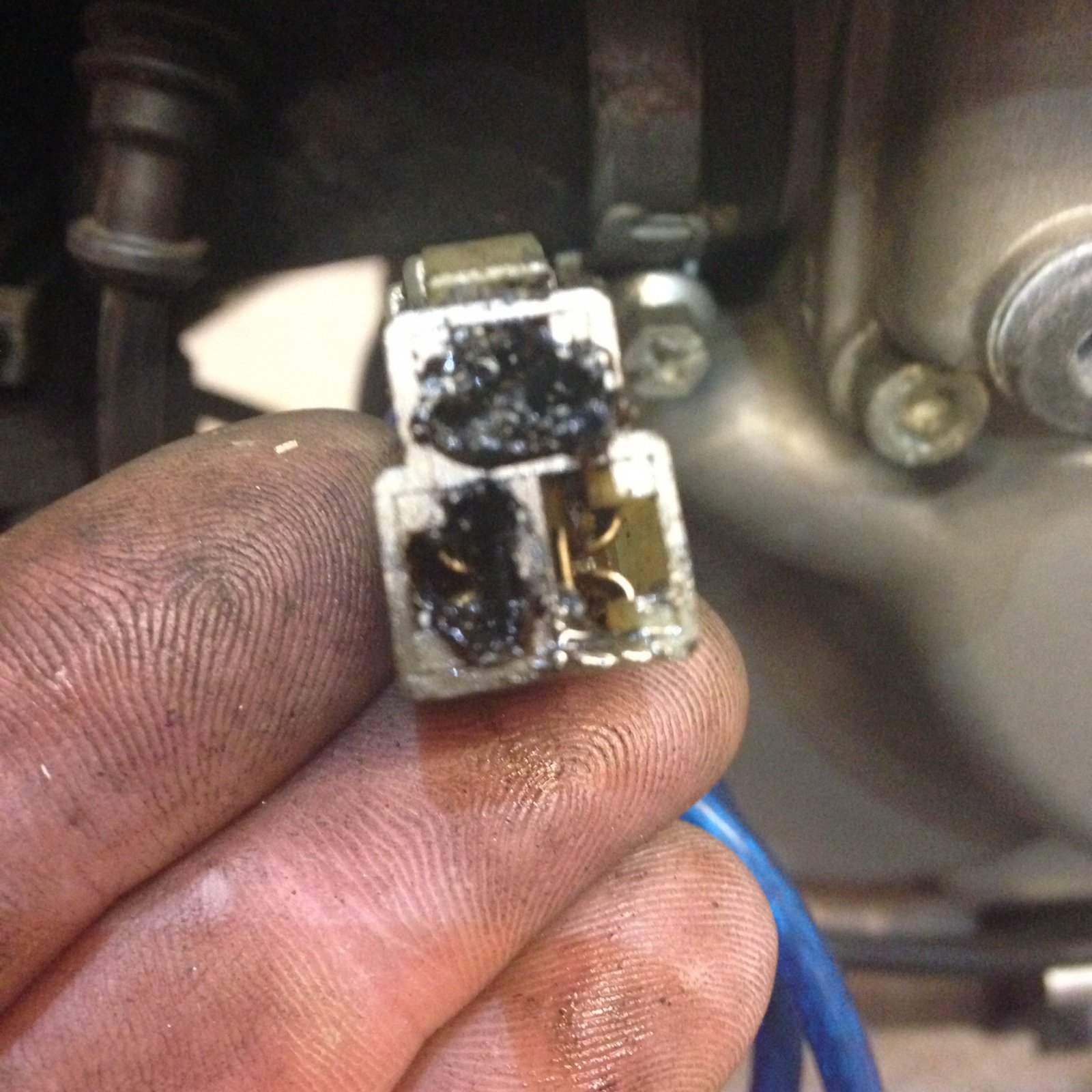

  10. The culprit! Since going to upgrade to the mosfet one though.

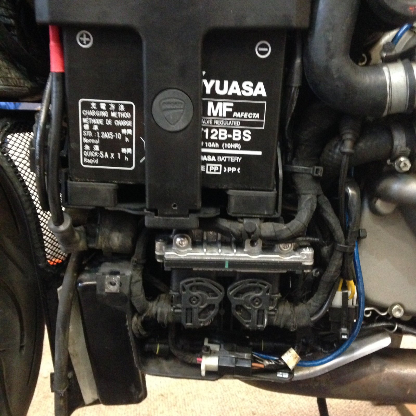

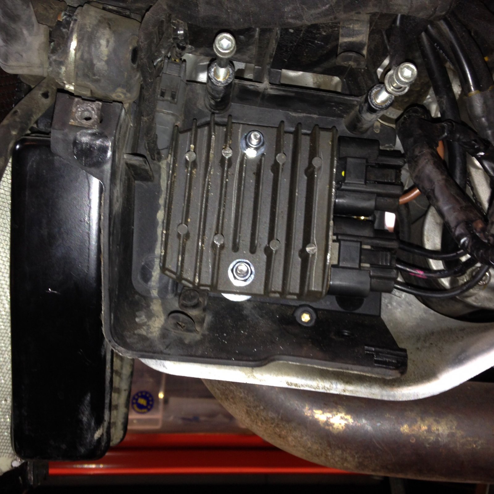

  11. image.jpg image.jpg New R/R fitted. Doddle to fit, just need 4 longer bolts. 2 for the R/R and 2 for the ecu. The mosfet is a bit bigger so the ECU needs to come out about 10mm to compensate. New connectors fitted by ChrisW and ready to go. Thanks mate :upyeah:
