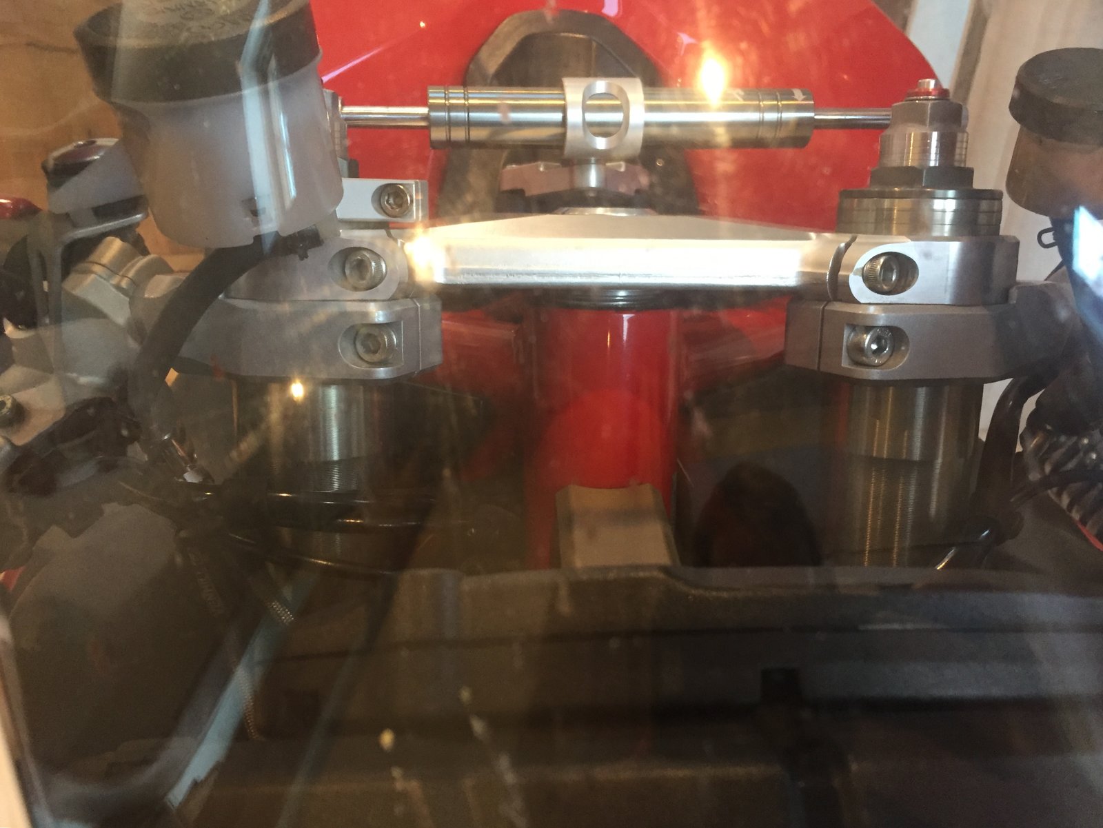

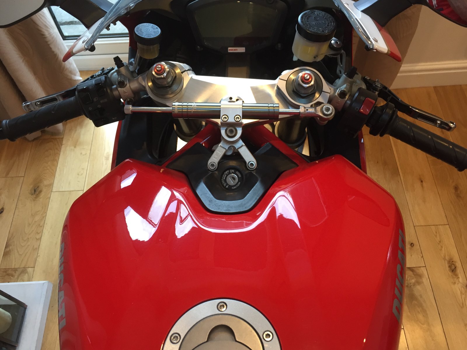

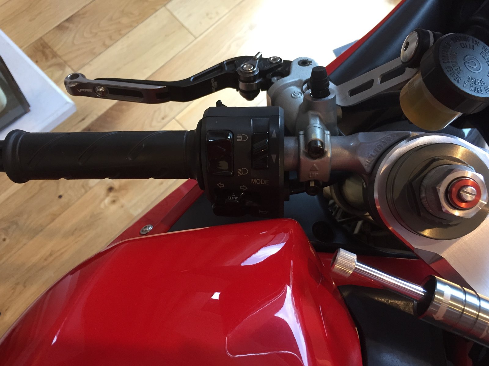

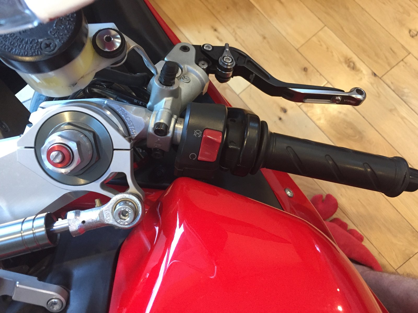

  18. Evening pal, I've got them on my 848, it came with them so can't compare to originals. id did the 1500 mile/ 7 day trip with lads last month and never had any issues with wrists, arms etc. Ive done 7500 in 2 years without any aching etc.
    If you need any other pics just give me a shout as its in the lounge. The lock stops do need to be altered and I can only use the steering lock one way.
    Stu.
  19. Thanks for this, can u still use the steering lock in it’s normal turned to the left position? (Ie clutch side down)
