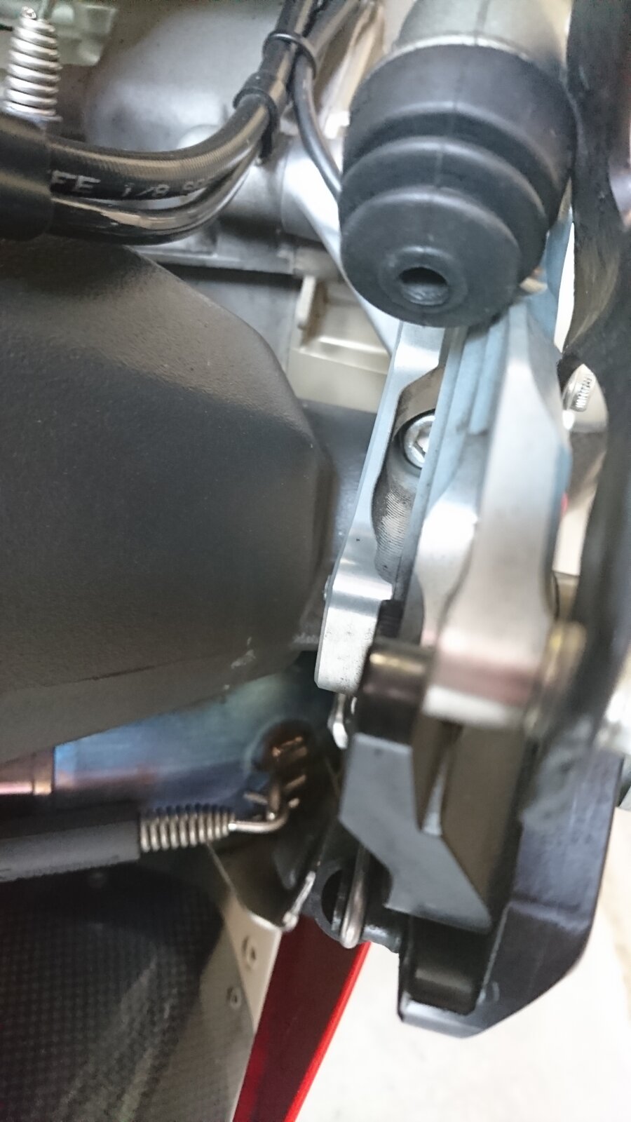

  1. If anyone has them fitted could you please post a photo of the brake side rear showing the master cylinder connecting bar, spring
    Seems my dealer ordered the wrong parts, and they are now saying there is something not has it should be with them.
    Yet supplied fitted by dealers !

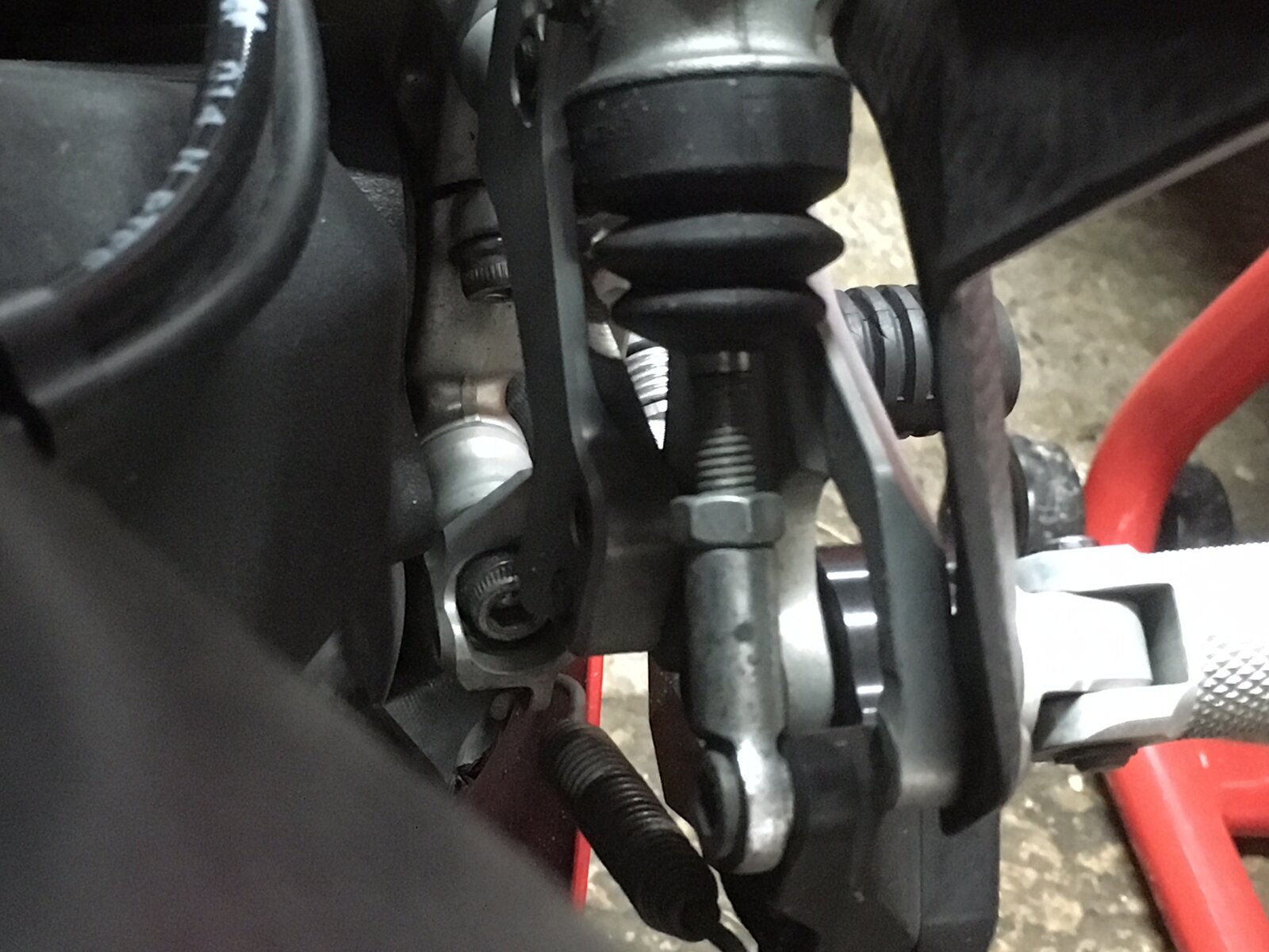

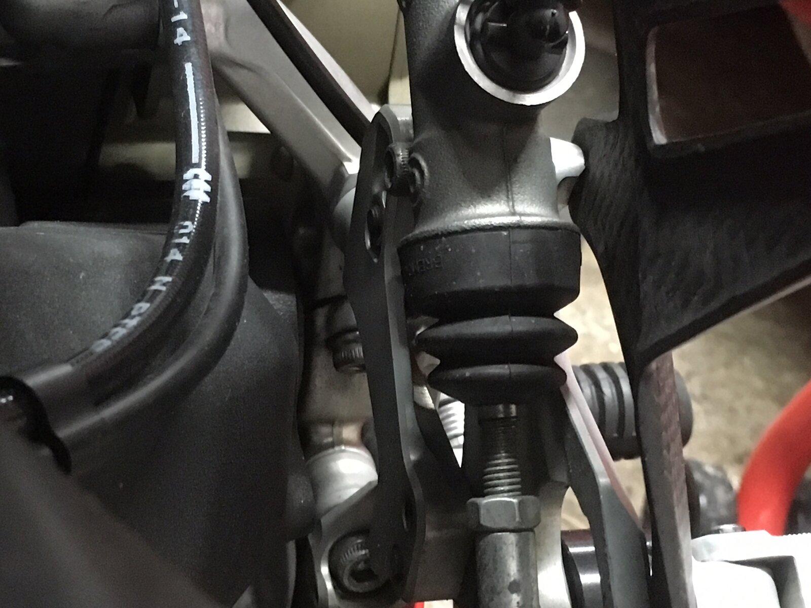

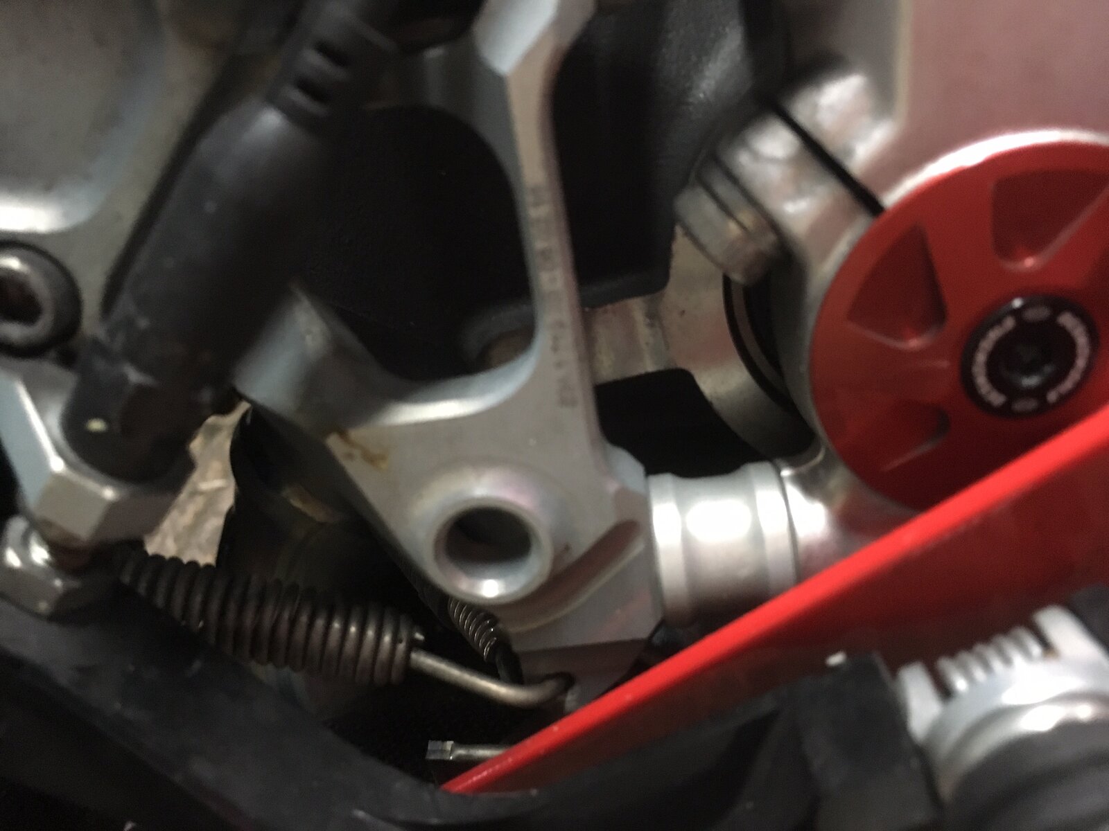

  3. DSC_0532.JPG DSC_0531.JPG DSC_0530.JPG Photos of mine so you can see what's missing

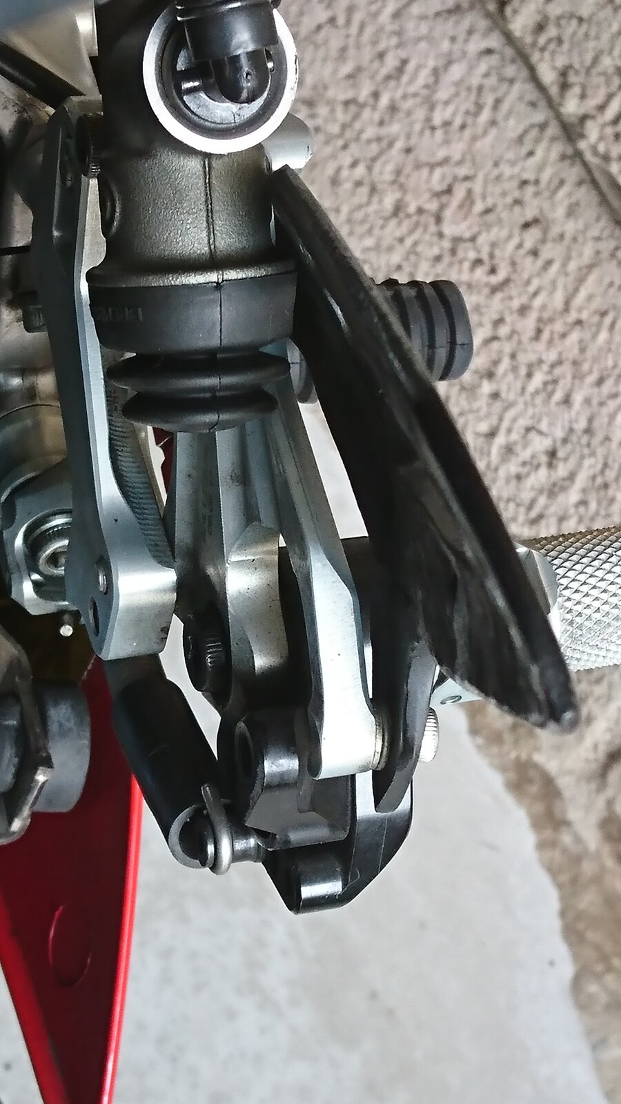

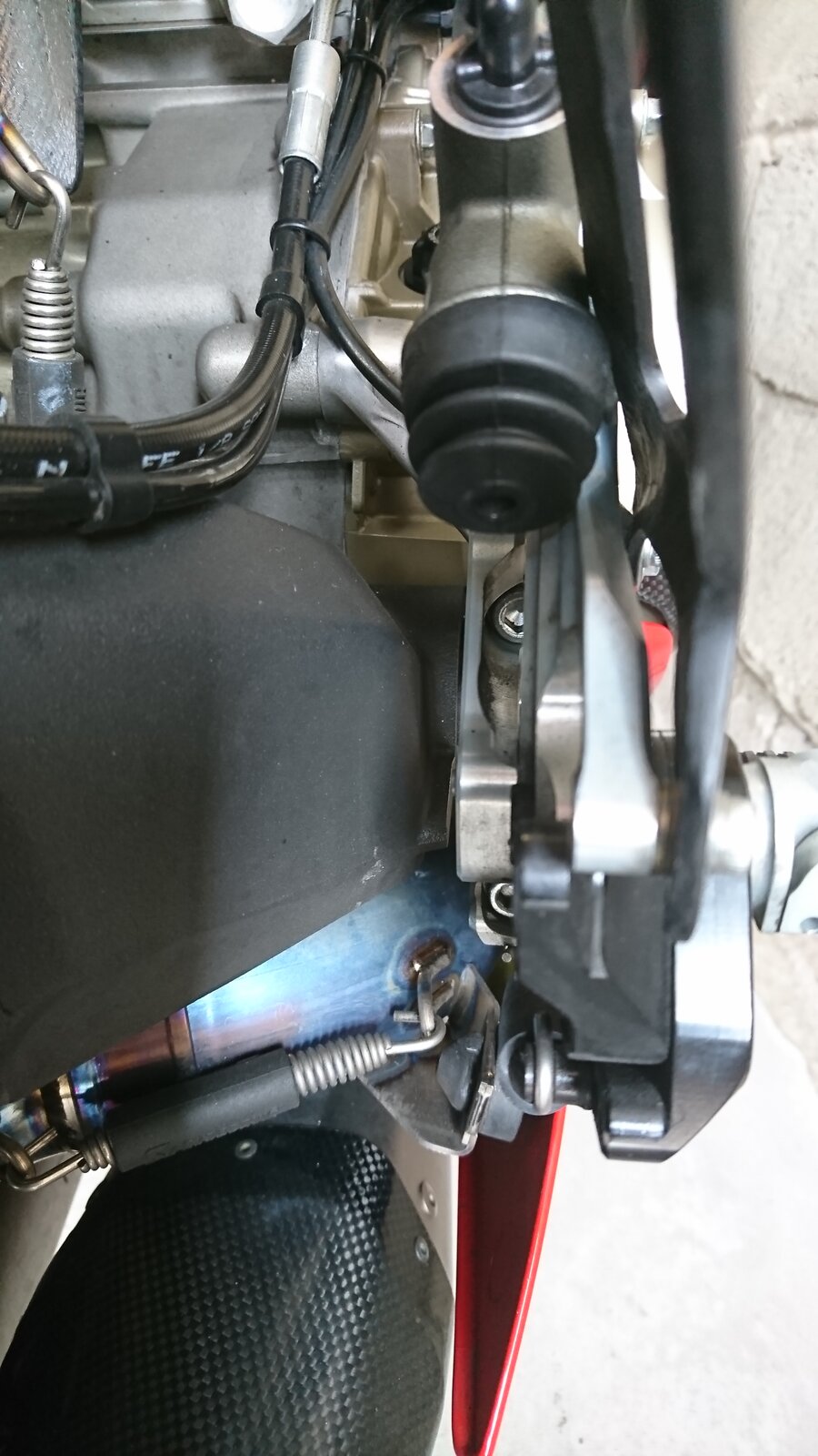

  5. I did. Soz. Gimme 5 mins ..............
    .....not much room to take photo

  7. Thanks bootsam, the 2nd photo shows what I'm missing, the threaded linkage pin/bar.
    Is it attached to the rear set by a 5mm allen head bolt fixing ?
  8. Yes @Brom66 you can use the parts from your oem rearsets. These items did not come with mine either. I just swapped the bits from my oem set.
  9. brake adjuster rod pn 11720452A (21 UKP)
    Pin (bolt) pn 82113811AA (6 UKP)
    should be all you need
  10. V4 has a different sent up, I looks at a mates to see if they were similar, but as you can see the pin/bar on the V4 also has a spring.
