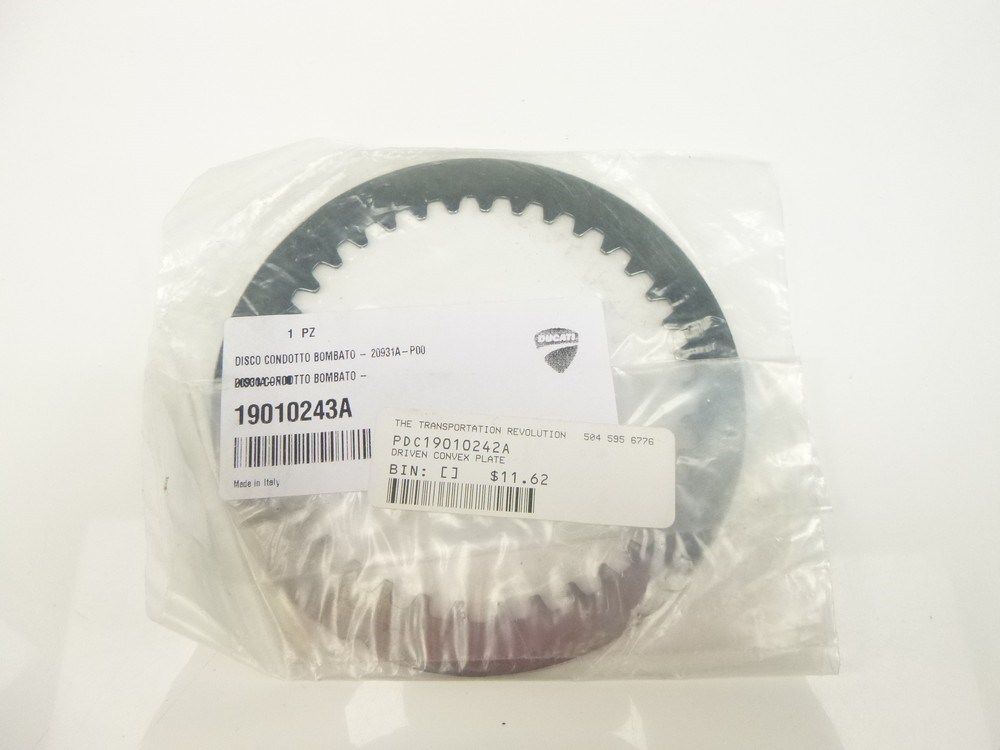

  4. I've never had a problem buying them and bought a couple a few months back. Part number is 19010243A
  5. will buy myself a couple....many thanks rob

  6. Oooopppppsss.
    That part is for the dry clutch. I don't know if the wet clutch uses different steels. I'm assuming it does. :Eggonface:
  7. no mine is the dry clutch,its a dp dry clutch conversion for the 848 mounted in a ncr magnesium casing mounted to my sport classic 1000s.sooooooo looks like the dealers were incorrect .
  8. Ah, you're all good then. :upyeah:
