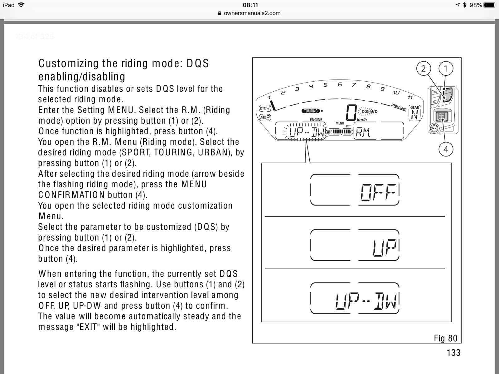

  1. Not had the bike long coming up yo 600mile and was looking to switch on the DQS system, doesn’t seem to be highlighted on the dash? Gone into settings RM but can’t see the option for the DQS? Is there another setting?

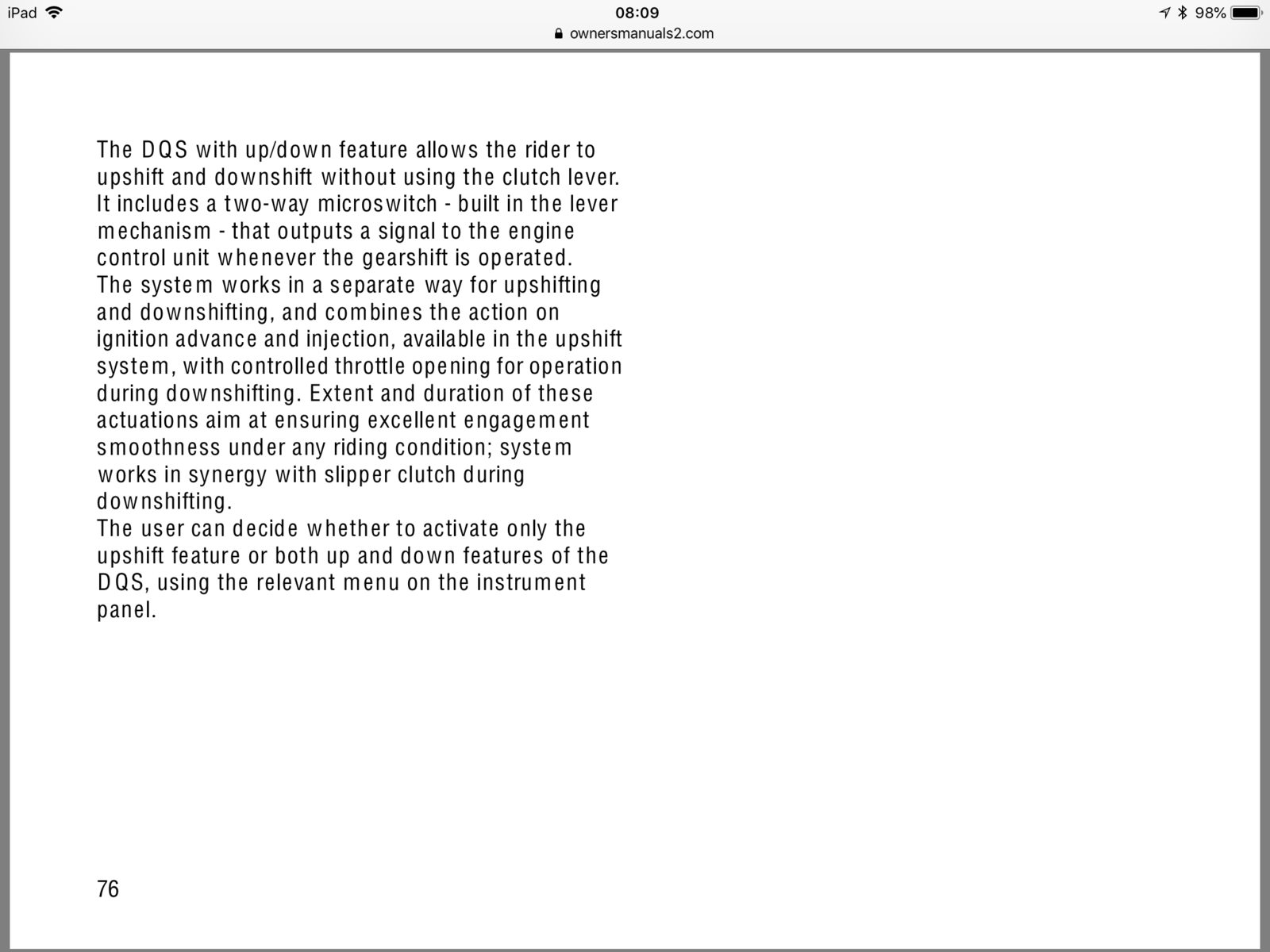

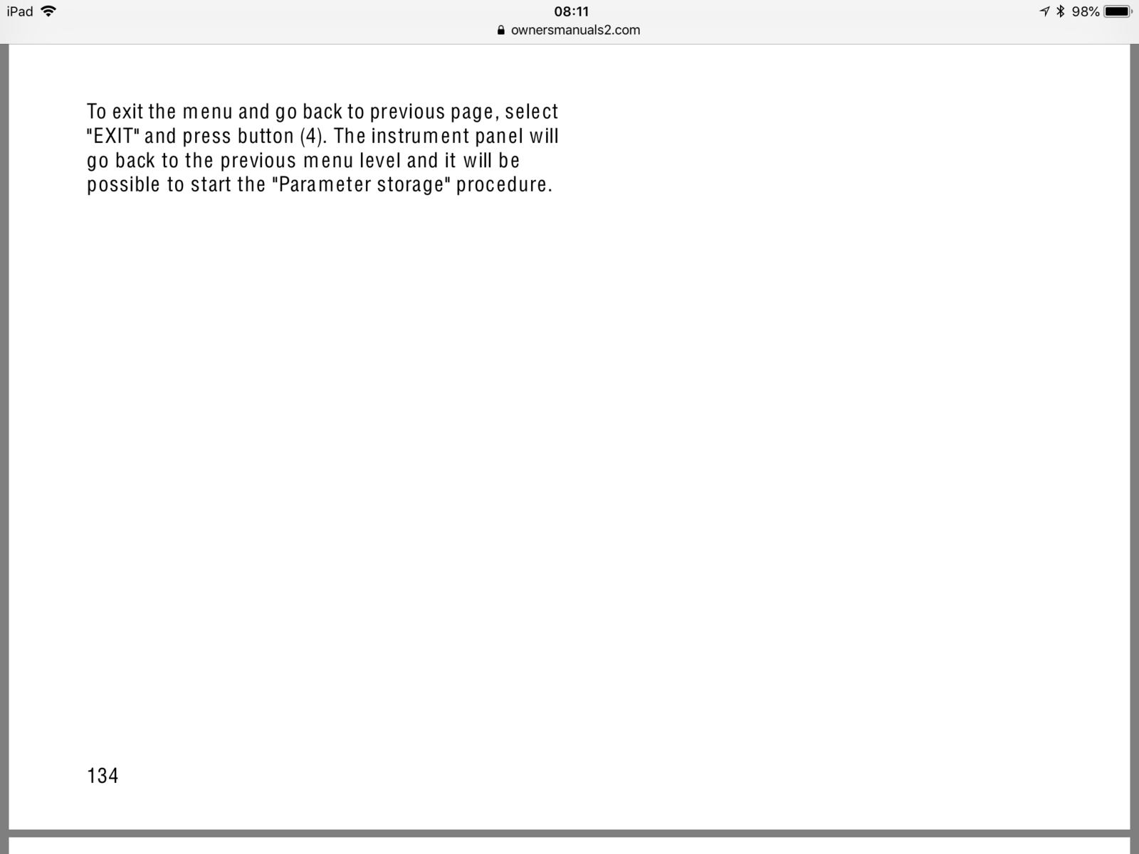

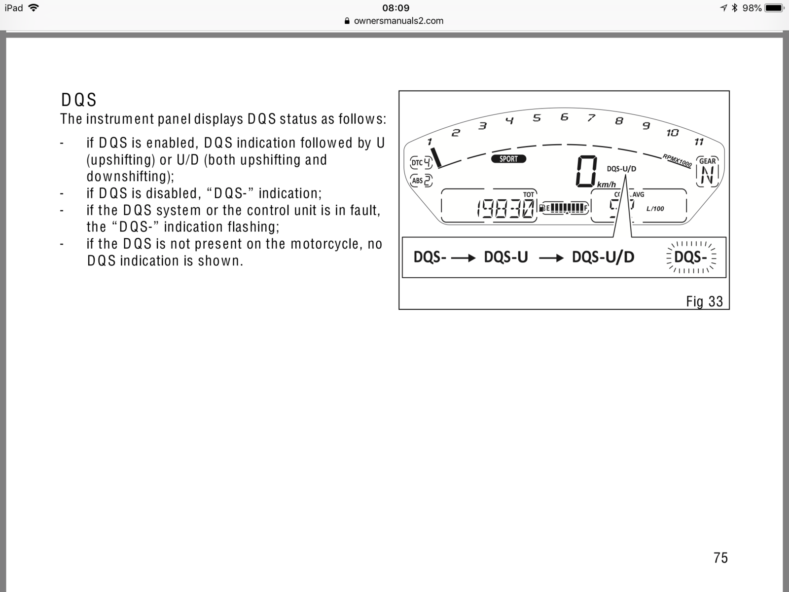

    It is switchable, and the manual implies if no DQS indication at all on the dash, even if it’s disabled, means it’s not fitted...

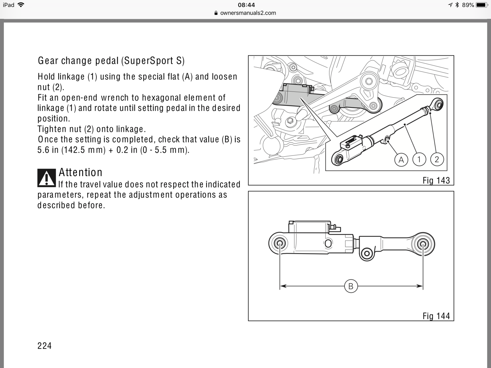

  6. To the best of my knowledge it should be on by default. The obvious check to confirm DQS is on the bike is to check the gear lever, if DQS fitted it has the extra box on the linkage for the electronic gubbins. If the box is there, it’s a software/settings or fault issue I guess. If the box isn’t there...
