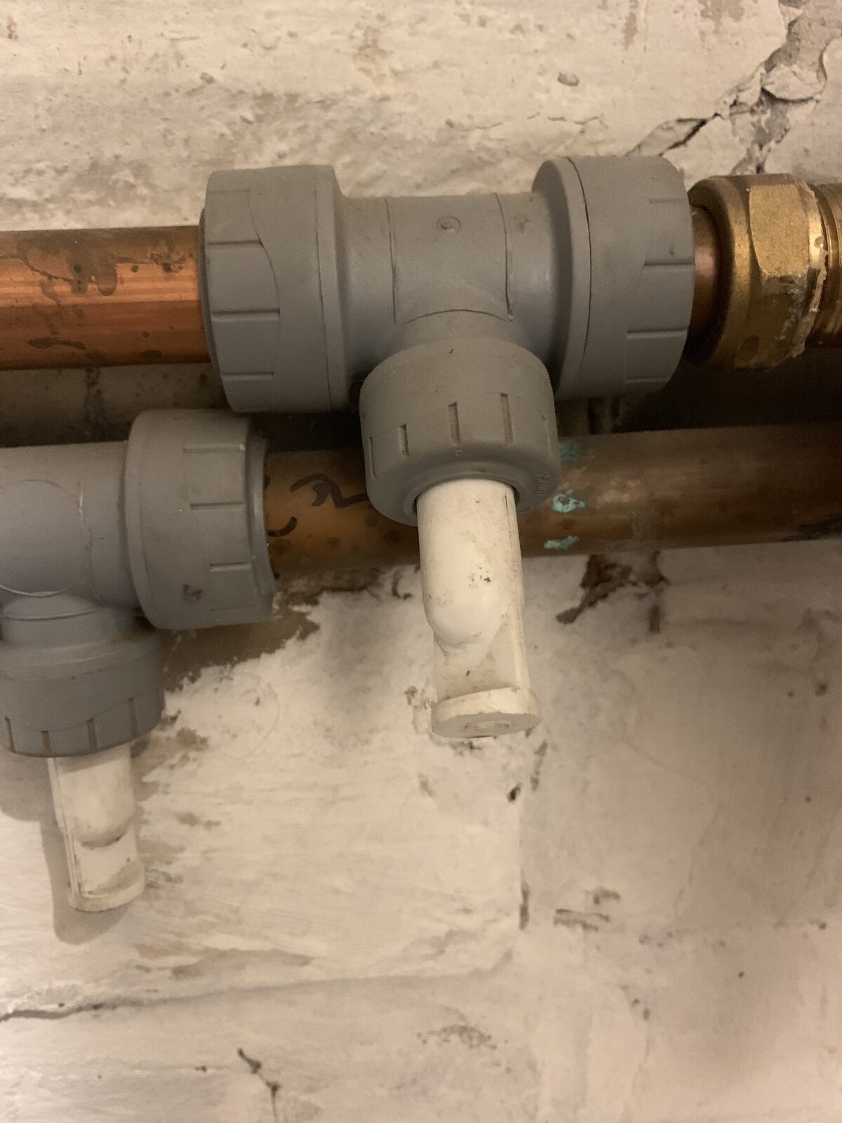

    I’m fitting one of these to a new to me central heating system.
    The filling loop is under the boiler so I’ve been looking for a drain off valve.
    Can’t find a conventional gate valve in either the flow or return pipes just these 9E76DB99-E338-404E-BF54-DC1B6590CB5D.jpeg
    Does anyone know what the white plastic bit on the branch are for?

  2. I’m no plumber but those are most definitely not drain points. It looks like someone anticipated adding a pipework run in the future. Andy
  3. That’s what I was thinking. There are two boilers side by side with these in both sets of flow and returns. They are located in the utility room. Two extra rads in there would be overkill.

  5. It's just a blanking point , if you can not find a drain off , grab a bucket and a towel , prepare to get wet .
    Unscrew the grey bit where it goes in as it won't pull out , you'll get a massive spurt with the initial pressure but it'll soon pass , once the pressure is gone drain it into the bucket .
    Have fun , you're gonna get wet .
    Unless you find an easier way to drain It .
  6. Couldn't he use a freeze kit either side of the bodge then correct it?
  7. Thanks, the existing rad near the front door has a drain off, I’ll use that to release the initial pressure then remove the blank and fit a proper drain off through the wall to an outside drain.
    Both the boilers are at the lowest point in the systems
    I’ll wear my wellies!
  8. I wouldn't bother altering anything, use the drain off near the front door, that's why it was put there.
  9. I might have to alter pipe work under the floor, the boiler being at the lowest part of the system means if I drain there I completely drain down the whole system, making it much easier when soldering.

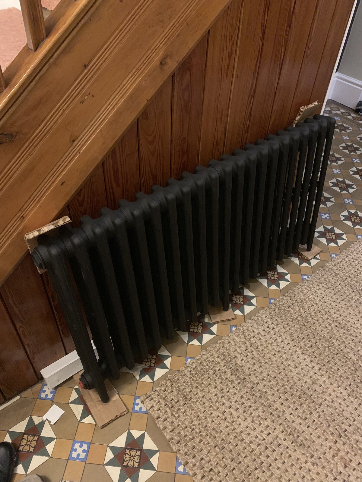

  12. I’m liking that rad :upyeah:
  13. Rad does look cool but I'd paint that wood white before you fix it up
  14. Wood should be wood not white noob
  15. I would agree in most events but on that stair/rad wood, I would paint the planks on the wall behind the radiator white but leave the stairs themselves in wood.

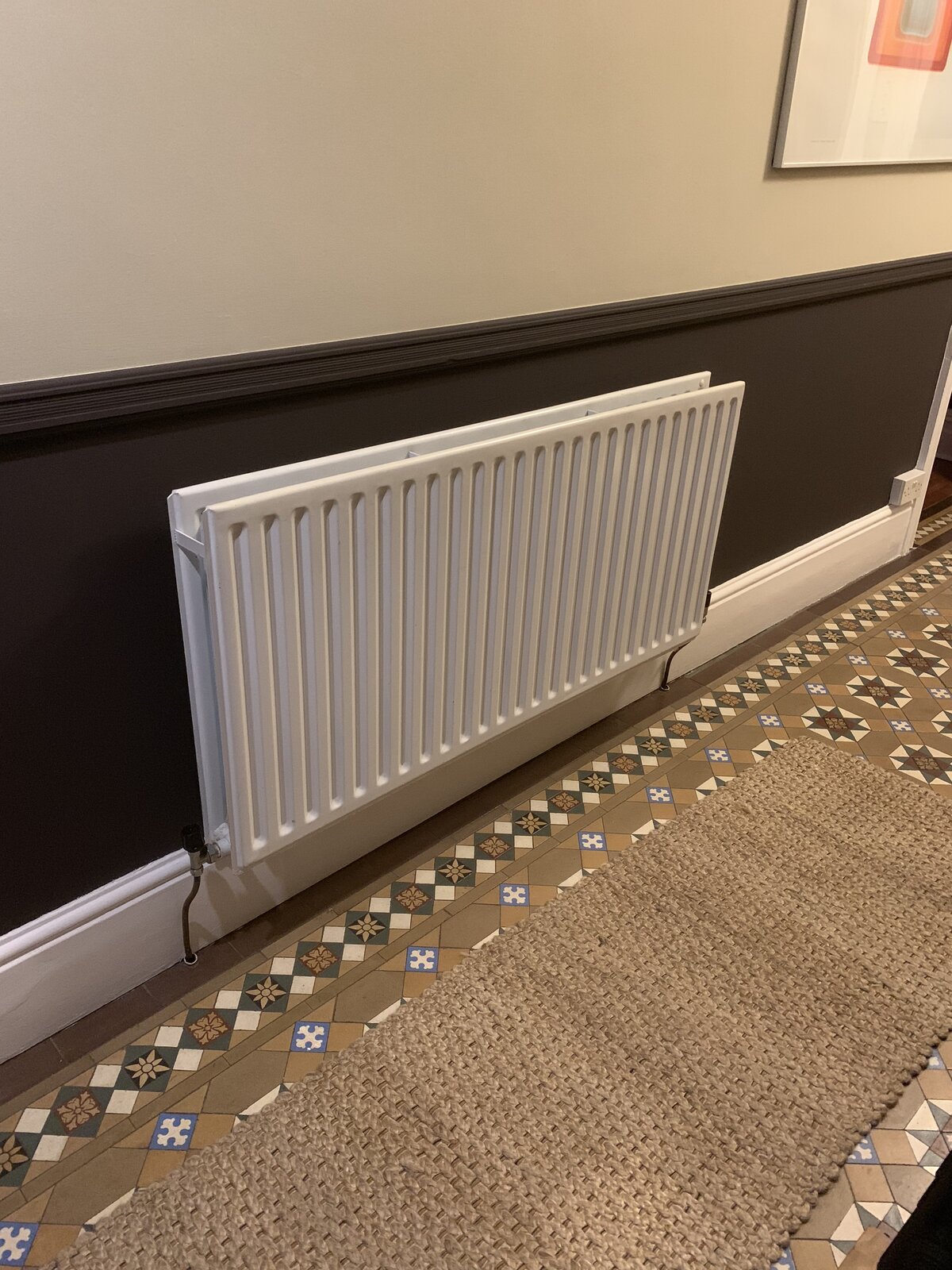

  19. It’s going opposite where it’s ‘resting’ to replace this one.
