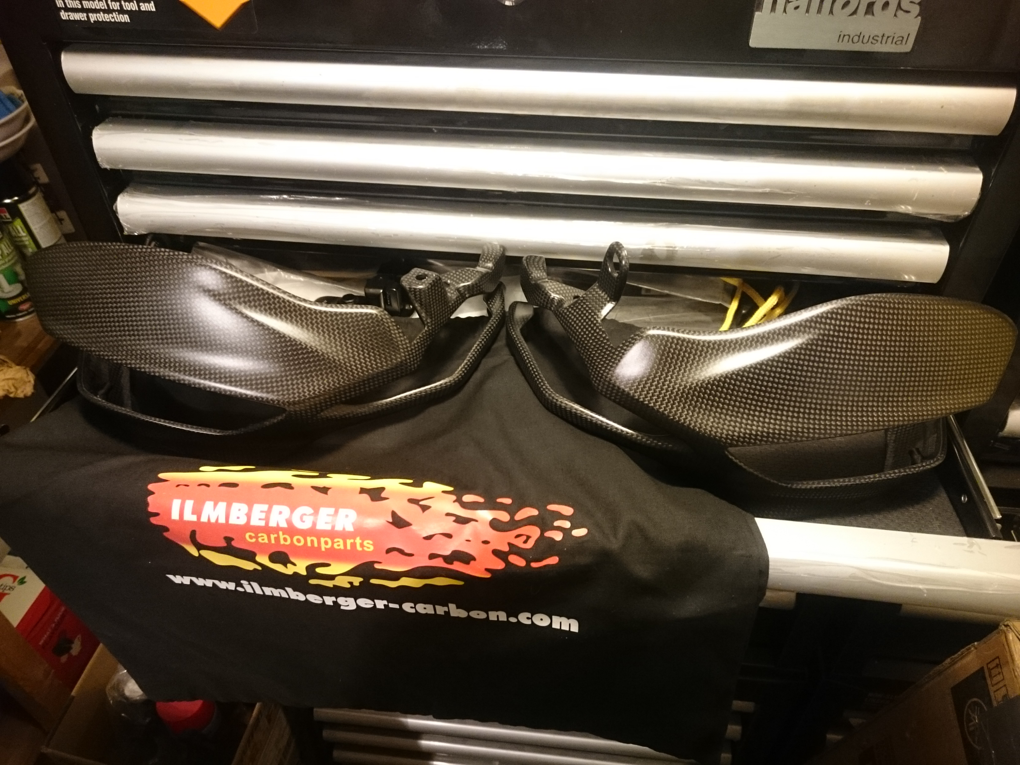

  2. Ilmberger carbon to the rescue!
    ..can't remember what the end bar thingie is called. But it has saved me lowering my bike to the ground in a unfortunate (low) number of circumstances.
    Though luckily I've named the photo 'ducabike handguard' for my sieve like brains faults. Which I got through conquest carbon however they've renamed their website & its not working.
  3. Appreciate your reply, but as mentioned above I’m not a fan of the bar end protector, and I’m looking for a non-standard handguard that incorporates a bark buster.
    Thank you though!

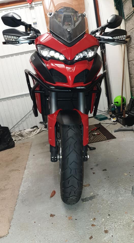

  11. Dropped my '17 1200 S DVT.....broke mine as well...so converted the MTS into a tank. lol!
    I tried to find something but to be honest the barkbuster doesnt look bad at all.
  12. Thanks for posting!
    Are you satisfied that the bark busters seems robust enough to withstand a drop?
  13. Just pleased I could help mate, amazing what can be achieved with a bit of ally, double sided tape and some cable ties!
  14. Great job too!
    Replacement parts from Moto Rapido are £116 - I may get a new lever and have it powder coated, and keep the original one under the seat, just in case...

  17. yes, its not those Ducabike bits...no offense guys but that design looks inefficient straight off the bat..there someone needed to say it lol!
    The barkbuster are dense and solid. I wasnt sure myself if it was worth it but for £115 for the pair and after installation I think it's worth every dime. they are built for motocross abuse where they smash into rocks, trees..etc etc I think for road use they are plenty sufficient and definitely save the plastic bits!
    I also bought ASV Shorties to replace the levers. they have 5 years unbreakable warranty. So if they break in a fall, they get replaced for free! Expensive though.
