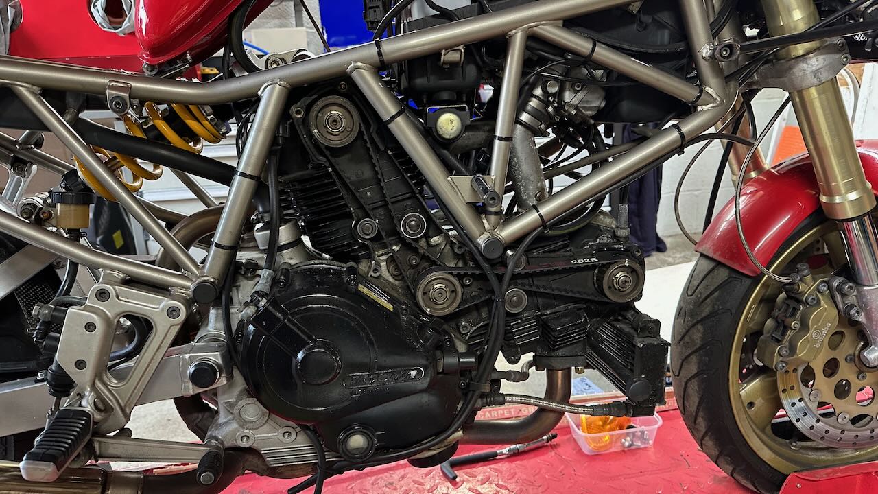

  1. I have a 750SS, which is due for a replacement clutch. It started to slip/go last summer; at 27k miles, it could be the original.
    While ordering parts, how do I know I have a wet or dry clutch that is short of cracking open the machine? Is there an obvious sign?
    I'm 99.99% sure I need a wet clutch kit unless the oil window below is a separate compartment.

  4. The picture you have posted shows a wet clutch model.
    • Agree Agree x 4
  5. Thank you!
    I had a sneaky suspicion that was the case, but I couldn't face the mess of starting the job and leaving it undone while waiting for parts to arrive.
